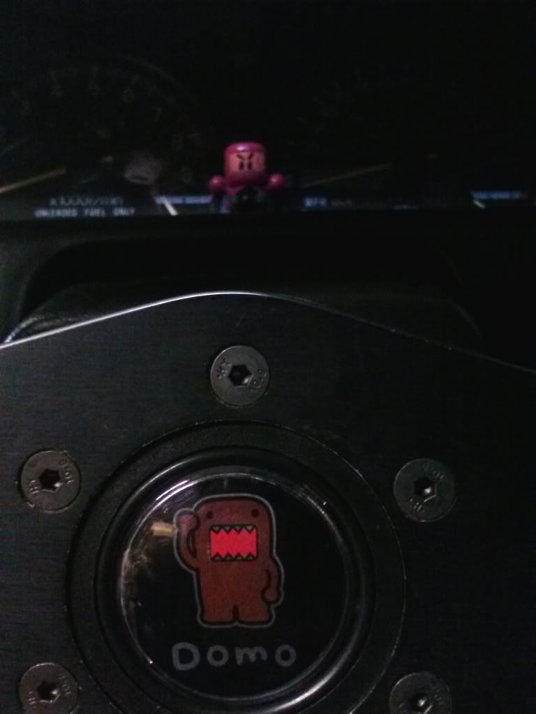

will the 6101 hub adapter used on the 90+ eclipse work on our gvr4's?
if this topic has been covered, please have mercy. i did try searching wt the pluses an minuses but got squat.
here is a pic of the cause of all this as sacrifice. /ubbthreads/images/graemlins/worthy.gif

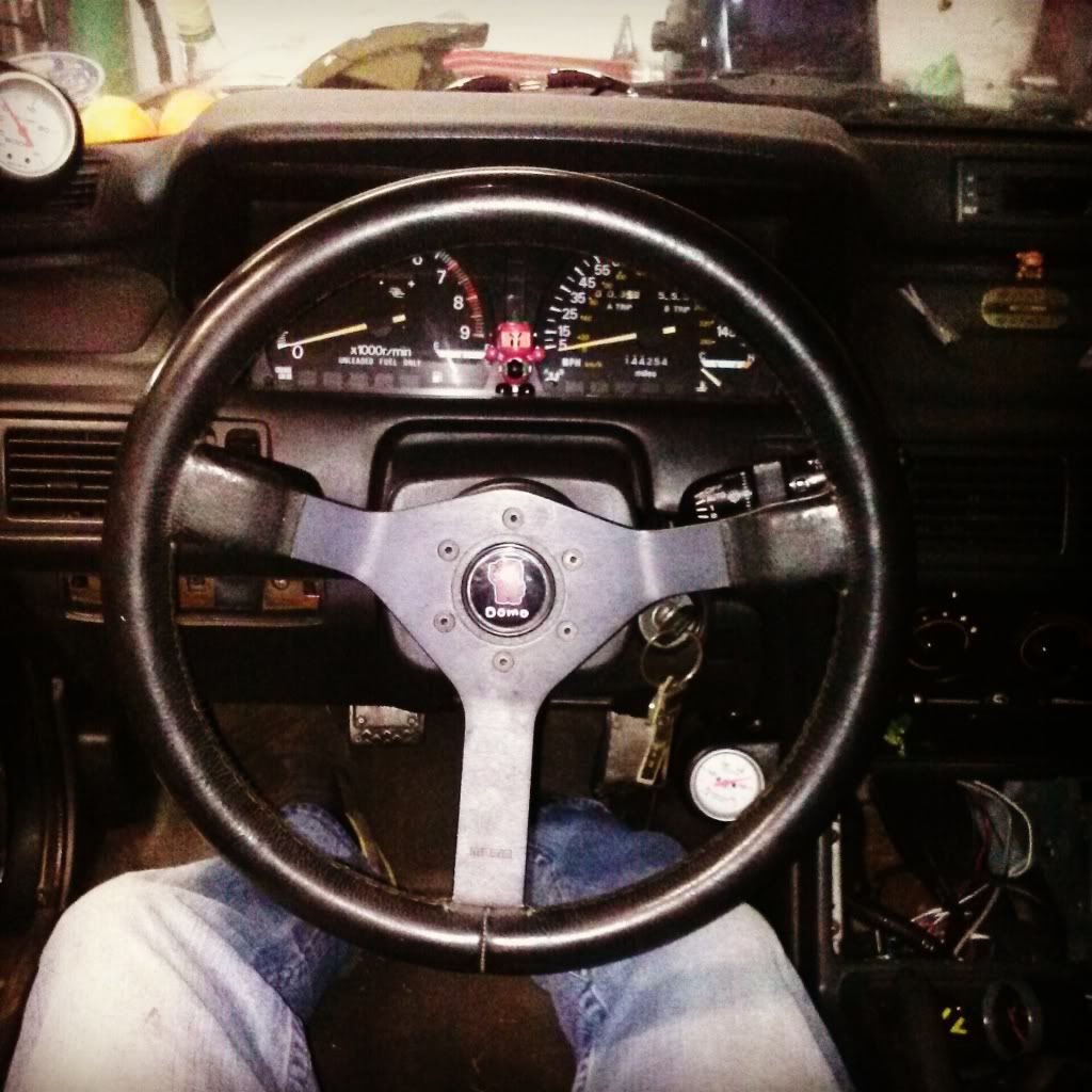

ktmrider
Sep 10, 2007
3,128
Tempe, AZ
Wow no depth issues there! Quite a dish.
Love the Domo monster... /ubbthreads/images/graemlins/wink.gif

Looks good, I wonder what the difference is that they decided to make the eclipse one different. Can you still mount the rubber boot w/out any issues?
ade
Aug 16, 2011
303
Paumanok NY
no fitment issues at all. rubber boot fit and slipped into the steering shroud nicely with no rub-age, everything bolted up mint. lol ya, i couldn't pass picking domo up.

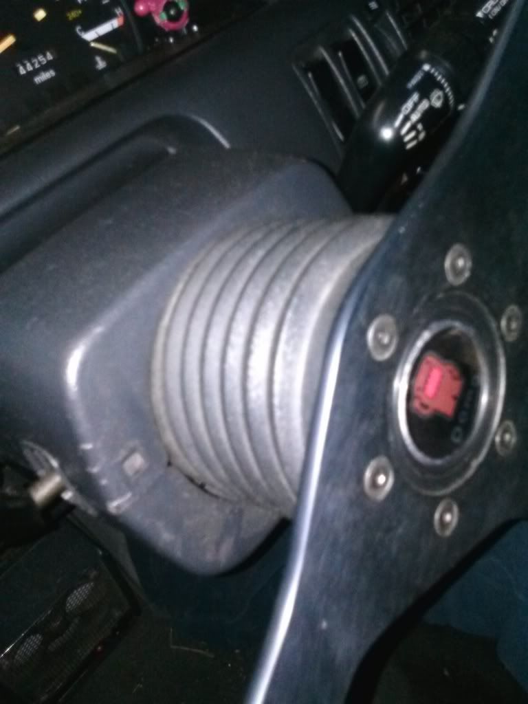

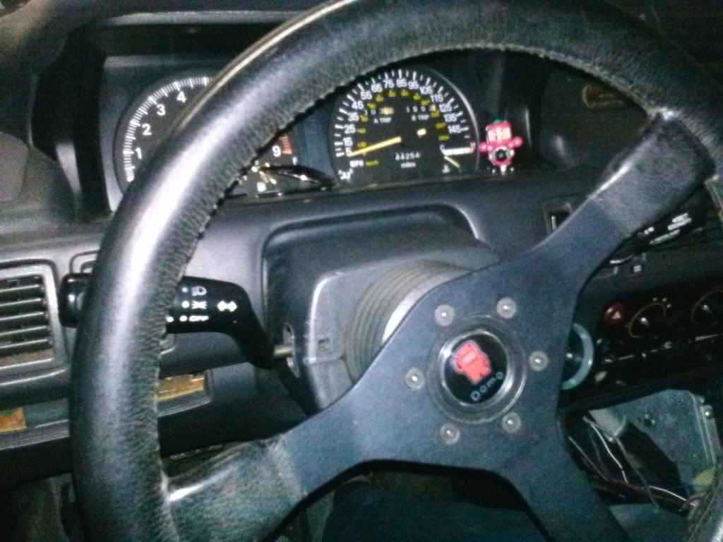

ade
Aug 16, 2011
303
Paumanok NY
here are pics of the boot for reference. it might look like the shroud is making contact but that's thanks to the shitty picture.
