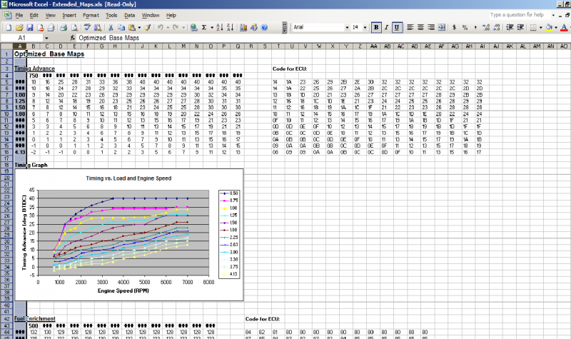

Seems to be in the tune somewhere. Leaned out to 10.8:1 in all loads above 1.88:1 and no more misfire.
10.8:1 is rich, not lean.
Or do you mean your O2 pegs at 10:1 then "leans out" to 10.8:1?
It is leaner than other ratios though and want to preserve my engine as long as possible during troubleshooting. I know these engines just well enough to say that I'd better get this fixed soon or I will have other problems to fix. It is set at 11.1:1 now though and the problem persists.
