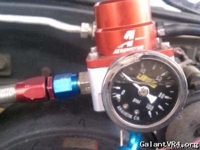

Aeromotive for sure..... speaking of, does anyone know what liquid they use in the guages, as i went to snap a picture it seems my guage is a bit low of fluid... so what kind of fluid fills them? /ubbthreads/images/graemlins/dunno.gif (sorry for the thread jack)

Probably a sort of alcohol. A guage needs fluid when mounted to the motor. In your case its not really needed, but I would have the same preference to just fill it up.

Wrong. Gauges are filled with glycerine, not the song. Its used in engine bays to dampin vibrations. In your case its a cheap gauge that wasn't completely filled to begin with, and no it can't be filled easily.
