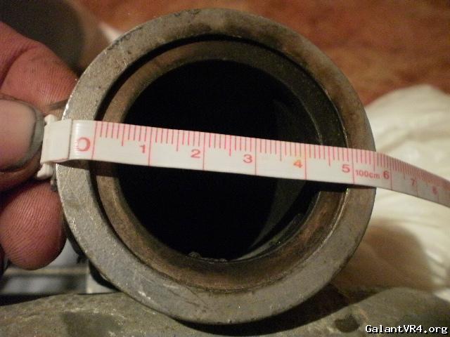

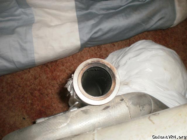

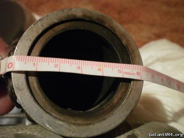

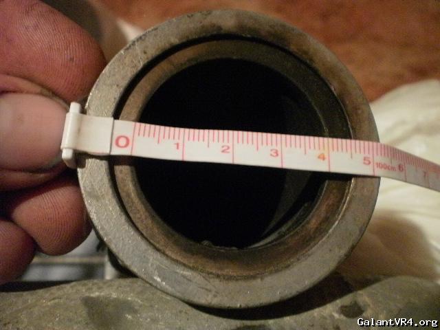

ok guys ive been putting it off untill now and my car is comming together, i bought a top mount manifold and have a big arse WG v band flange... i dont know how to measure it to get the right one? do i go by inside diameter, outside, or the first lip inside the flange? the inside is close to 44mm but the center is mor like a 46mm or 50mm...and i sure dont feel like buying the wrong wastegate just to not be able to use it. i will try to get a picture with the tape beside it...thanks alot! sorry if this might belong in the nooB section...

i had also thought this but the 44s im looking at dont look like they would seat on the flange, the way the inset is the other way like it would sit inside of the inner lip... but the first lip form the outside is the one thats close to 50mm?

i'm pretty sure that its a 44mm tial flange, you can take out the 44mm seat ring to make sure.
if i had one i would not be confused on what size it is... lol also punishment racings site says that they are closed untill the 1st!!! i cant wait 2 days! lol....

While I agree with the rest of the guys on that being of the 44mm variety I understand you not wanting to buy multiple wastegates. With that said I'm pretty sure you can go to the TiAL website and check the technical specs of all of their products. Hope this helps.
MitchooO
Oct 10, 2007
350
South Mountain, PA
it did help...but im still kinda unsure why my flange has 2 different lips on it...im going to just get a 44...if it doesnt work ill just have my flange rewelded for the one i know will work! thanks for all the help guys!

That step is from the valve seat ring. The mounting flange of the wastegate on the manifold should be a flat surface. When the wg is mounted on a flat surface flange, the valve seat ring will then be pushed in to preload the valve a little bit to make sure that the valve is fully seated and have no leak. If the wg mounting flange is stepped like the one in OP pictures, then the wg valve seat ring will never be pushed inand will prevent the valve from seating all the way. The outlet of the wg is stepped though, as you can see on the tial picture because the dump tube flange is also stepped to make registering/ centering the flange easier. What I think happened is that someone use a stepped flange for a dump tube as the wg mounting flange on that manifold. Need to cut out the manifold wg flange and weld the right flat mounting flange on that manifold to make the wg valve seal properly.
