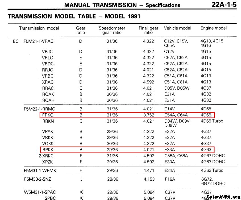

i need your help with my manual transmission. I have the 1991 Galant 2,0 JA3CR46V2MZ014852 E33A
it has F5M22-1-RPKK gearbox
NOW, because i found a brand new gearbox (but with a little different number), the question is will it be compatible with my car
the model of that gearbox is F5M22-1-FRKC
does this mean that it won't work with my car? and here's more info click
please help:)
thank you

I am not sure. but I think the galant FWD gearbox has two clutch options. One of them is hard wire & the other way is same at the VR4.

the new box you found is for a Mirage/Lancer diesel and has a different final drive ratio (ie differential gear).
thank you for answering,
so does that mean that gearbox has no use for my car?
