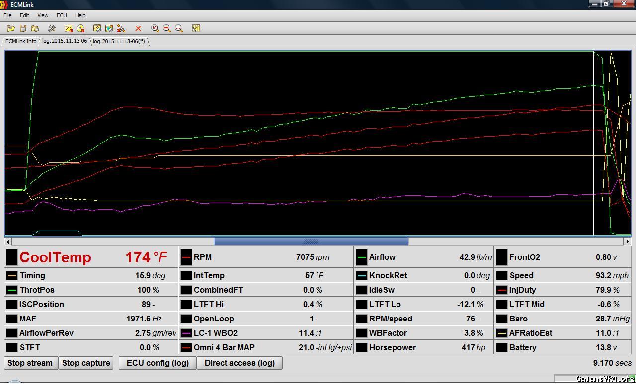

I started dialing in the car on E85 last night. 3 pulls later I logged 43lbs/min with the bastard 20g on a VERY conservative tune. 21psi, and only 16* peak timing up top. Previously, I never logged anything over 39ish lbs/min on 93 pump. Needless to say, there's still room for more boost and timing. With more boost, I'll probably need to bump the base fuel pressure to drop my IDC, though.
Oh, and zero knock /ubbthreads/images/graemlins/devil.gif

11.4:1? Damn, that's thick. Pull it back to 12.3:1 and add 4 degrees timing.
Yea yea, you already knew that.
43lbs is getting pretty good on a bastard at 21psi. Good job. I bet it feels wayyyyy better.

What's cool, is the ONLY adjustment I made from my pump tune to the E85 tune was adjust global fuel. Basically, I started at the calculated global fuel rate based on the formula, then saw where I was at. At that point, I made a pull, and saw how the WB lined up with the AFRatioEst. I was pretty rich, so I just bumped the global fuel until the two lined up. No adjustments to the MAF (as expected) and no adjustments to the DA fuel/timing tables. This is also the reason I'm still on the rich side, becuz basically pump gas tune bro.
It's pretty legit to see solid gains by simply swapping to better fuel. I'm confident that a bump in boost will net more airflow on the bastard, too.
