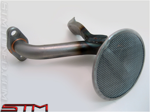

If you are throwing the bearings and front case together all willy-nilly, I'm curious to know what else was overlooked. What did you torque the main and rod caps to? You planning on running a 2g oil pickup? A 1g pickup won't work with your ARP main fasteners without modding the bracket.

I have a 6bolt oil pick up brand new, would it be easier to run a 2g pick up? I plan on running the stock oil pan.

Well, not sure what rods you're running, so can't help you there. Your ARP mains should be torqued to 60ft lbs using ARP fastener lubricant click . Technically, you really shouldn't just throw ARP studs in the block. The ARP studs apply extra torque to the main caps which can distort the main bore alignment, causing your crank to get eaten. Did you check the main bore alignment before you assembled the motor? In addition, your rotating assembly should have been balanced. Honestly, I would take the time to do everything correctly. Just saying the hell with it, and throwing it together probably won't last long. You may want to PM BogusSVO, and have him explain in detail everything that should be done prior and during assembly. He's extremely knowledgeable, and is a machinist by trade. It looks like you have some money tied up in the motor, and I'd hate to see it go to sh*t in the first 500 miles.
As far as the pickup, you should probably pick up a 2G piece. It doesn't have the bracket that attaches to the main stud like the 1G pickup does. I suppose it wouldn't hurt to just cut the bracket off the 1G piece, but generally people just use a 2G pickup instead.

Would you cut off the bracket on the 1g pick up, extend bracket on the 1g pick up or would you get the 2g pick up?

Personally, I'd just get a 2G pickup and be done with it. The main studs won't allow you to utilize the bracket on the 1G pickup, and it's really not even needed. Modifying the bracket to bolt up somewhere else is pointless, so just cut it off if you're going to do anything with it.
