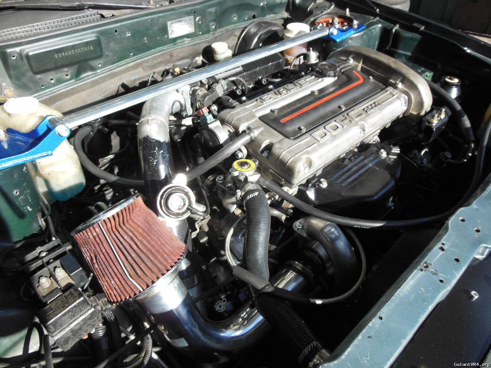

Engine:
2g pistons/1g rods
evo 8 valves, springs & retainers
MLS head gasket
arp head studs re-torqued at - 207,321 miles
revised 3mm lifters - 186,231 miles
BSE Kit
Forward facing oil filter housing
Unorthodox Aluminum Crank Pulley - 194,543
Prothane Red Motor Mounts
HKS Clear Timing Cover
Mishimoto catch can - 207,321 miles
Black Top CAS - 202,136 miles
SS oil feed line - 207,321 miles
Larger oil return line - 207,321 miles
Custom water pipe - 207,321 miles
SS valve cover bolts - 207,321 miles
BC 272 Camshafts - 210,000 miles
