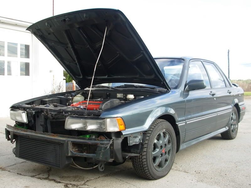

This car on Evo 8 KYB's and Evo 8 Tien lowering springs.
This car on Evo 9 Biltsiens with Swift lowering springs.
