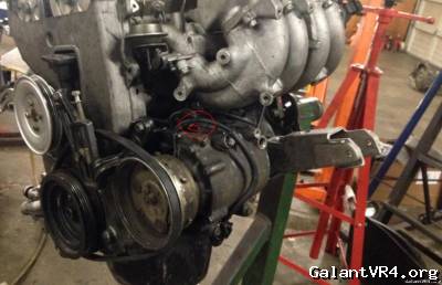

Hey guys,
Where is the low pressure port for the A/C on our cars? (1991 Galant Vr4)
pics would help a lot as well. I have followed all the lines from the compressor to condenser and haven't found it.
Thanks
Machiavellian
Nov 22, 2013
22
Ohio, USA, Earth

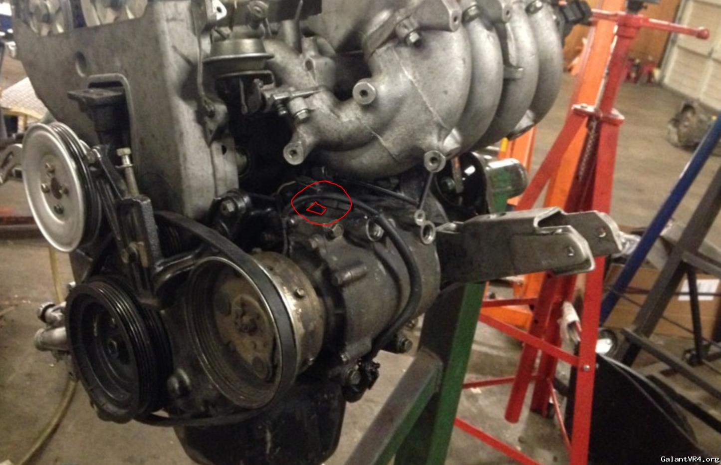

The low pressure port is, if I am not mistaken, located on the top of the compressor itself. It's kinda' tricky to find at first because the cap is black. Just get a flashlight and dive on in with your arm. Get friendly with your galant.
Here's a general idea for where it's located on top of the compressor.
