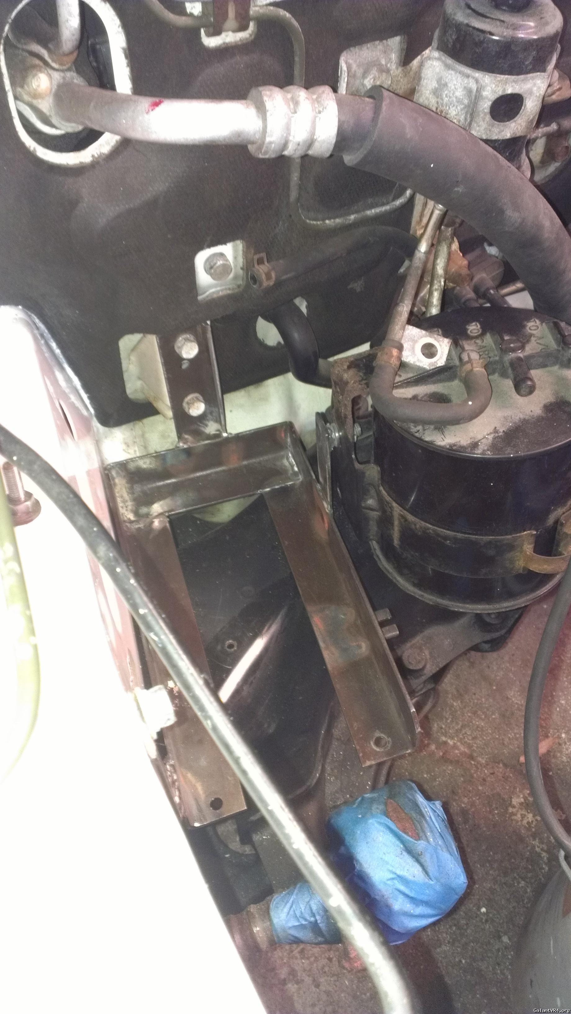

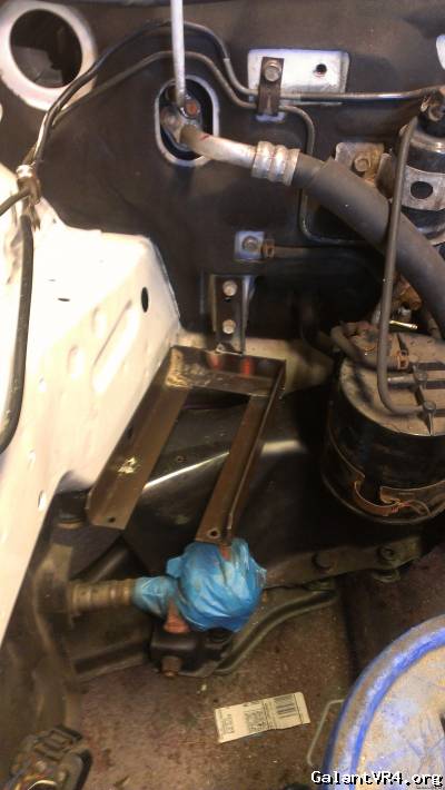

So here is the bracket I made to hold my battery. Only problem is I don't have an engine in the bay.
It's still rough just tacked in place really. The bottom pieces are 9.25" inches long.
Will this battery fit with the tyranny mount and everything in place?

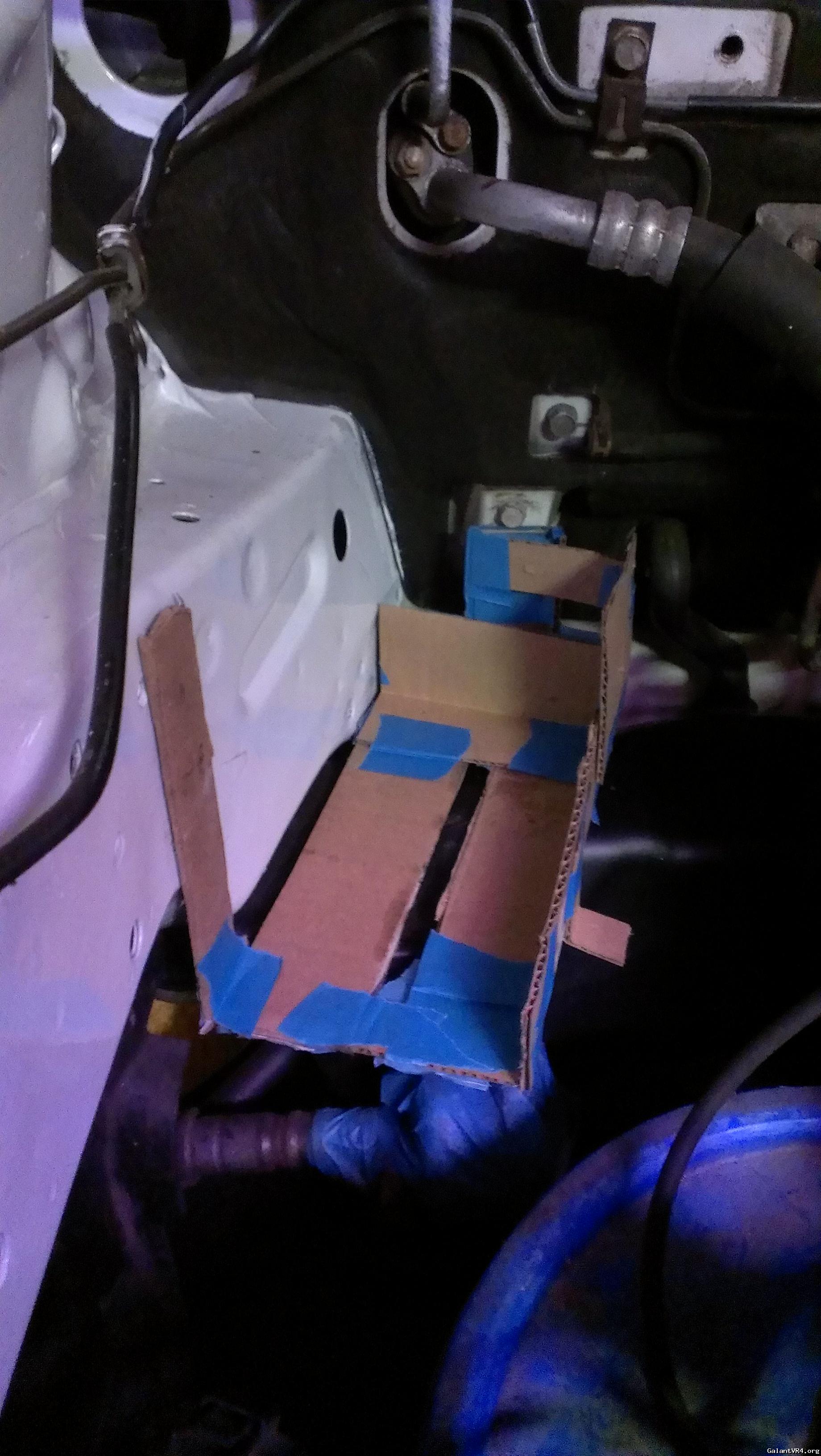

does this box look familiar?

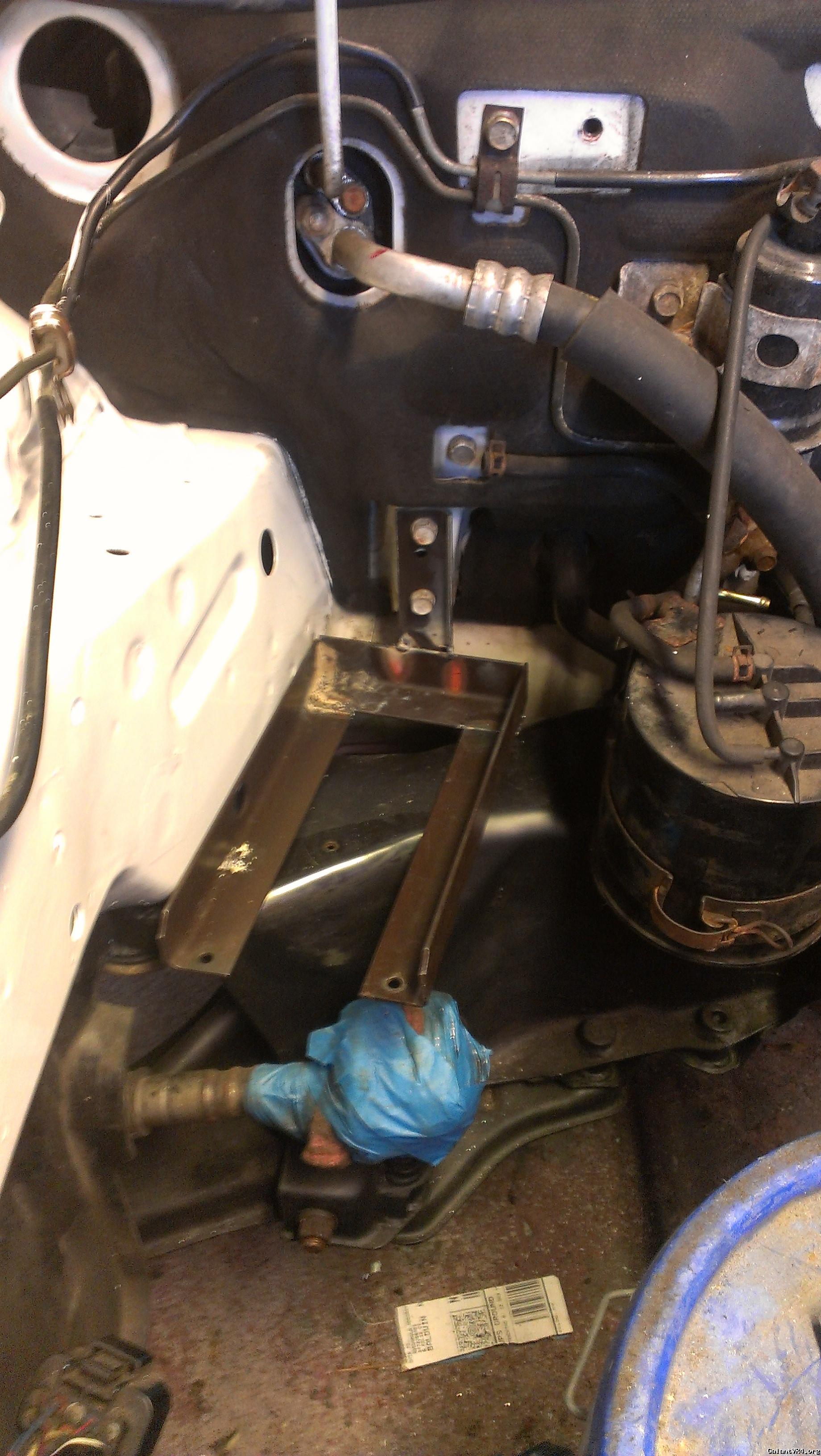

Ok, but the trans mount isn't in place in that picture.

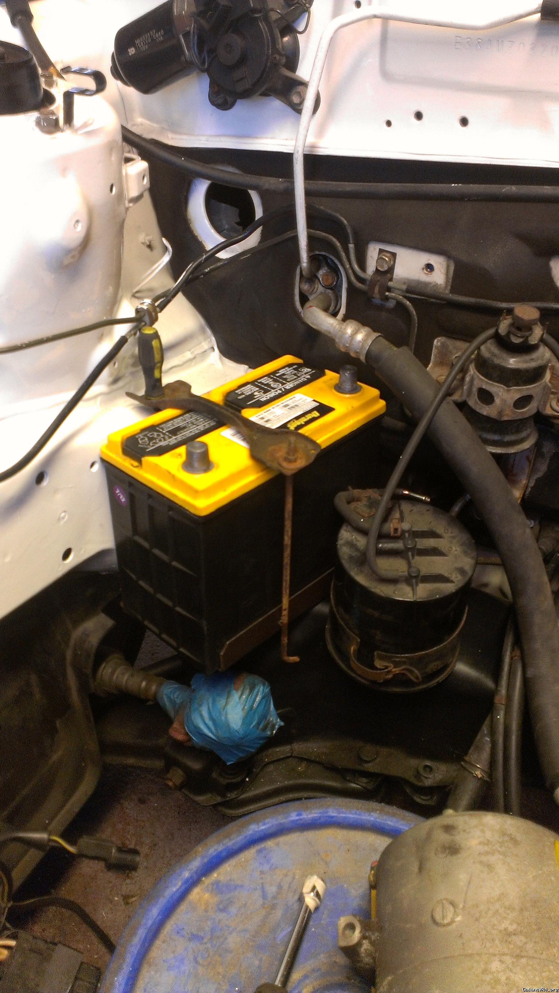

Here she is with charcoal canister bracket before paint.

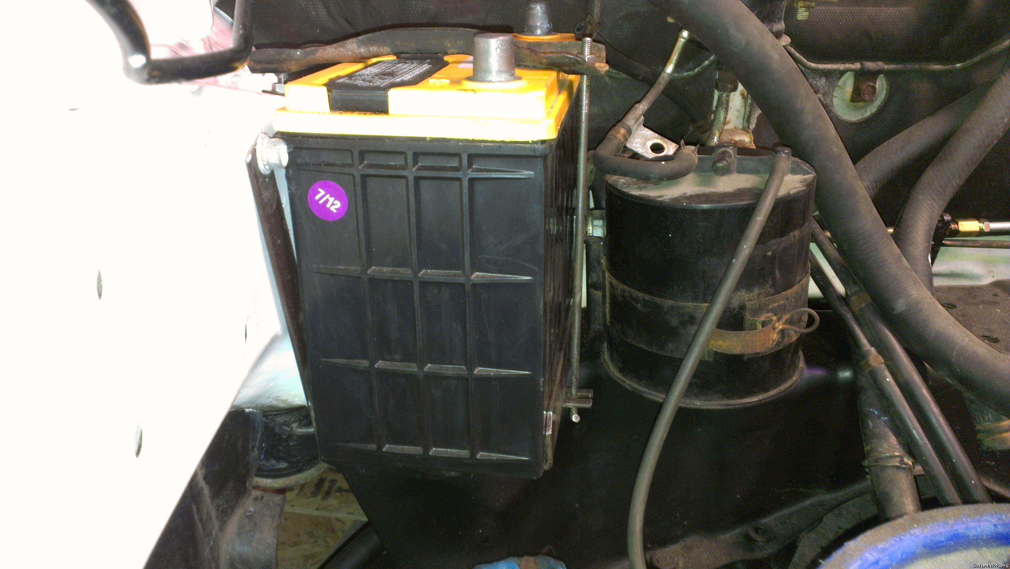

With battery
Battery is not going to come out easy, but Looks damn good.

Correction: Changed out the battery removing only the tie down bracket. With a little wiggling the battery came right out.
