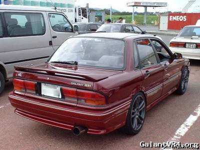

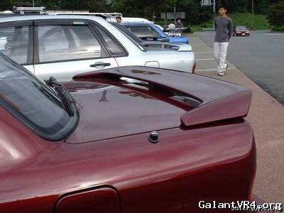

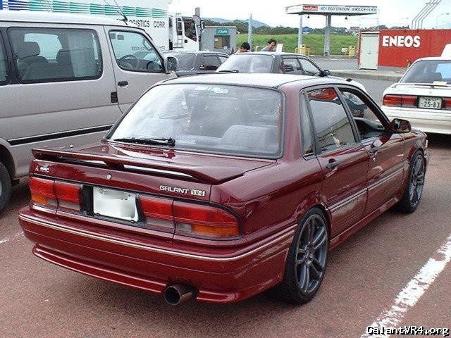

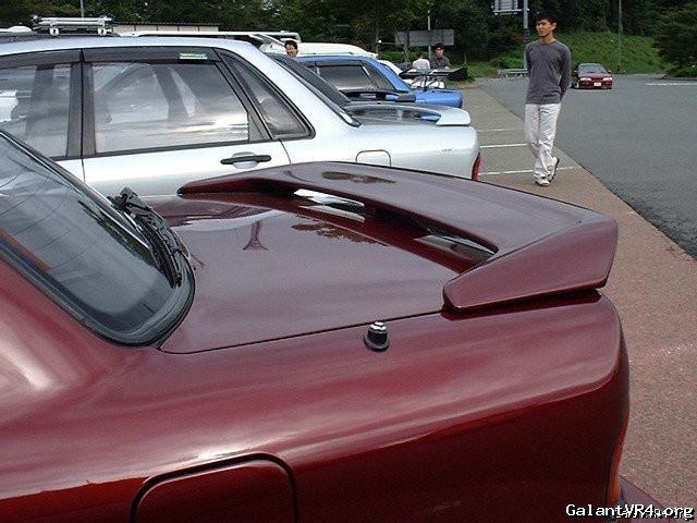

Or you can try the GTS-R32 spoiler if you can find one.
It is fairly discrete and doesn't look out of place whilst being very slightly more aggressive than stock. It requires very little modification having mounting bolts in locations almost identical to stock and even has an LED third brake light in the stock spoiler location.

that looks great, and I have considered going that route before, I just cant justify the cost of getting one stateside, especially for something that is not going to improve function

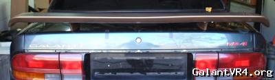

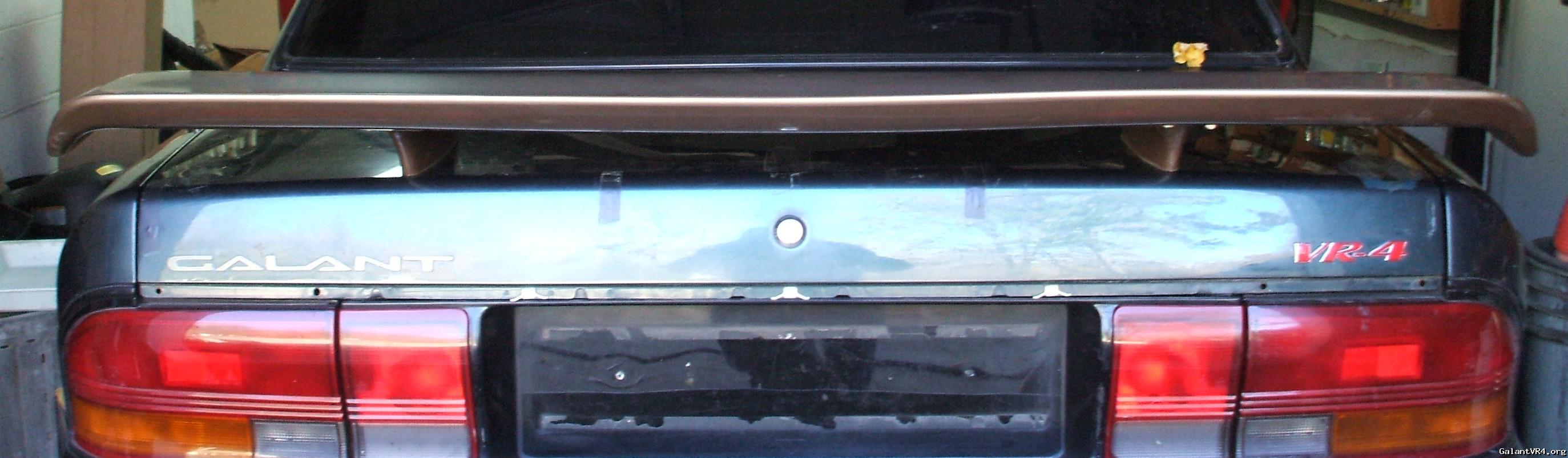

Fiero wing yea I got the dimensions and photos for fitment just have to find them. I have one sitting on my car right now and have for about 2 years In stock form the stands have to be first filled with an epoxy then milled at and angle and also lowered then lenght does hang off the sides. I'm really not sure if I like the lenght yet. Probably more stable at speed longer but to look factory fitment needs to have about 8 inches removed from the center and grafted back together.
He's sitting in stock form the angle is all wrong and I really think the lenght is to long but everybody I ask that sees it like the lenght as is. If its cut and shifted in to the factory locations just beside the trunk to quarter panel line I really think it would look better.

I got the idea from a pic of one on a Galant I saw several years ago, honestly, it looked fantastic. he had cut the stands to bring the tips below the trunk line, almost touching the body. But, is it just me or do they all look like they have a sag in the middle? even on a damn fiero, I saw one just tonight. If the sag thing was handled & the stands cut proper I'm thinking it will really look good. But as I said before, I'll be keeping the stock trunk & wing should I decide later I don't like it. Anyway, I scored a fiero wing last week for fifty bucks & have a wingless trunk so...

Honestly I think it's nice. The height is fine, especially when it is actually bolted to the trunk. The length looks perfect since the tips follow the edge of the car perfect as you can see in the pic. As for the sag, I think in the pic it may be more of an illusion since our trunks have a slight curve, whereas the fiero lid was completely flat.

Guys the fiero wings sag in the middle plus if you notice just to the right of the keyhole the edge of the wing is higher right there. Problem is theres no hand holds on the back of a fiero truck/hood and people would always hold it up by the wing right there instead of proping it up. After being hot in the sun the wing starts to deform from this pressure. My buddy the body guy says it will come right out with a few clamps, some pieces of wood and a heat gun. Mine has damage to the mounting stand mounts in the wing so I have to rebuild all that hardware, was a rust ball and just had to drill everything out. I'll probably build a thin aluminum I beam spar to run inside so it never happens again.

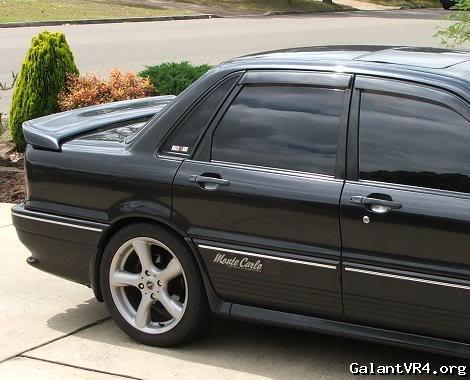

Wizardawd
Aug 7, 2007
1,323
Franklin, NC
That's exactly what I want...but it really does just look like a Fiero wing with the stands shortened.
Wiz
