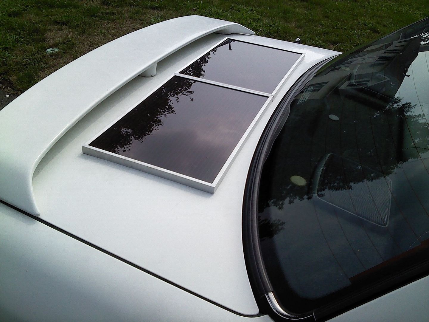

What do you think? I decided to drop two solar panels to keep my battery charged all the time.

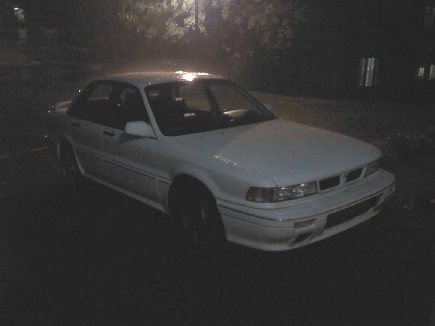

And a wet shot. This was like 10 minutes after installing everything.

Yessir. Mounted there and pump out about 30W. Good to keep the battery always charged even when the car is off.

no love/hate.... but couldnt you have made it look like it should go where a sunroof would go for less weight on the trunk and uhm something else but Im distracted at the moment by uhm, why did you do this?????? /ubbthreads/images/graemlins/dunno.gif

well whatever, it's very hackjob looking. function > form i guess.
where did you get them and how much?

I got them for $20 from this guy at my workplace. He had several sets of them left over. *scratch* How is it hackjob looking? I have them flush to the trunk. /ubbthreads/images/graemlins/bawling.gif How would you have mounted it?

I kinda like my sunroof. It still works /ubbthreads/images/graemlins/rofl.gif. I did this mainly too keep my battery charged when I am away for college. Got annoying having to run a orange wire out to my driveway. I guess it also doubles as a way to charge the battery in the event of a drain or if I need to use my battery with the car off.

I don't think it looks hack, just odd. I don't really understand the mod though. Why isn't your battery always charged? My DSMs will sit for a long time between projects and they fire right up when back together.

I mean I just didn't like the idea of the battery dying. I am pretty sure the Exide battery I have isn't a deep cycle so if it dies it more than likely will stay dead. With all the hacked wires that were in this car, there might be a slow leak somewhere maybe. It already killed the small stock battery I had so I said screw it and designed this idea.

The basic design is very simple. Consists of a solar panel that is connected to a basic PWM controller. (You can get them on ebay for cheap and specific to your needs). I got a PWM controller with a float point exactly to what my battery is so there wouldn't be a problem. Also keep in mind my battery is now in the trunk of my car so it was easy and short to connect all the wires.

Why not just unhook the battery when you're away at school?

Chuttering? You mean cutting? or cluttering? Either way I looked at empty space and only required 8 small holes. Worst case, I would just get another truck and remount the VR4 wing. Thats a pretty cool thing though.

Problem is that the AEM will lose the tune. Don't get me wrong, I can always upload it but AEM tends to be fickle and I don't want to give it a reason to crap out.
