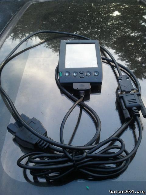

im in the same boat...no connection here is a pic of my setup

Like someone else mentioned, checked your connection on your port. Mine had a few bent pins but after getting all those sorted out my logger setup finally works.
