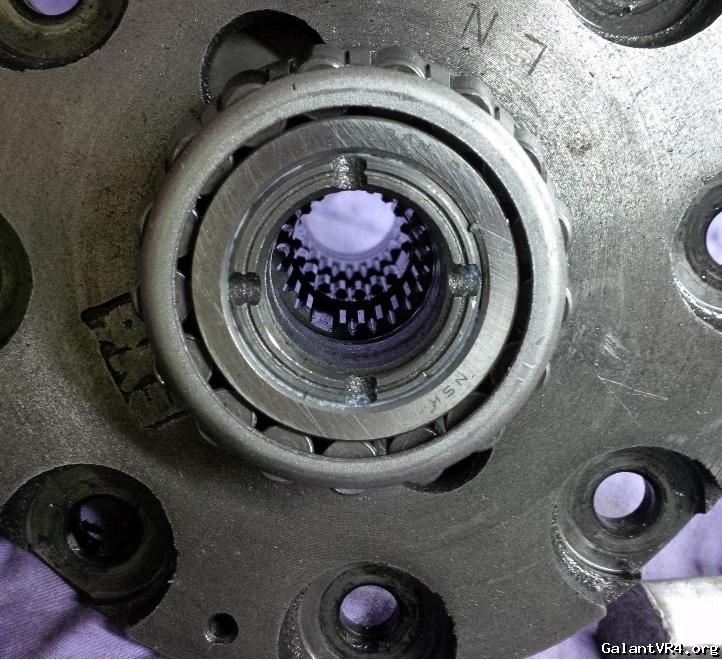

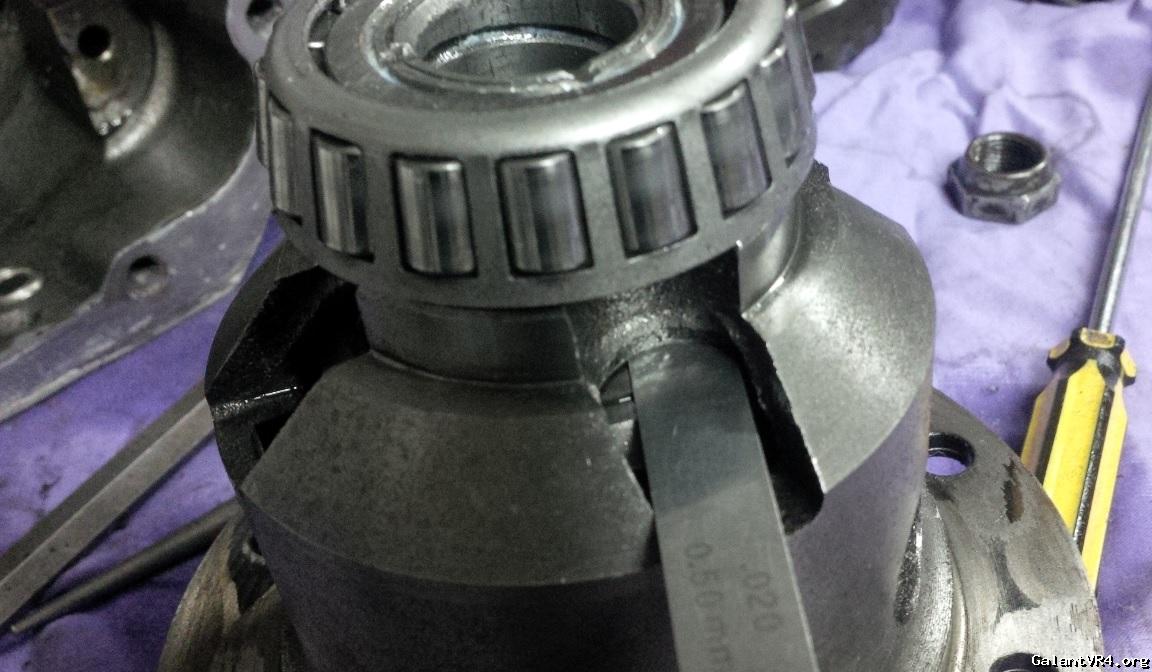

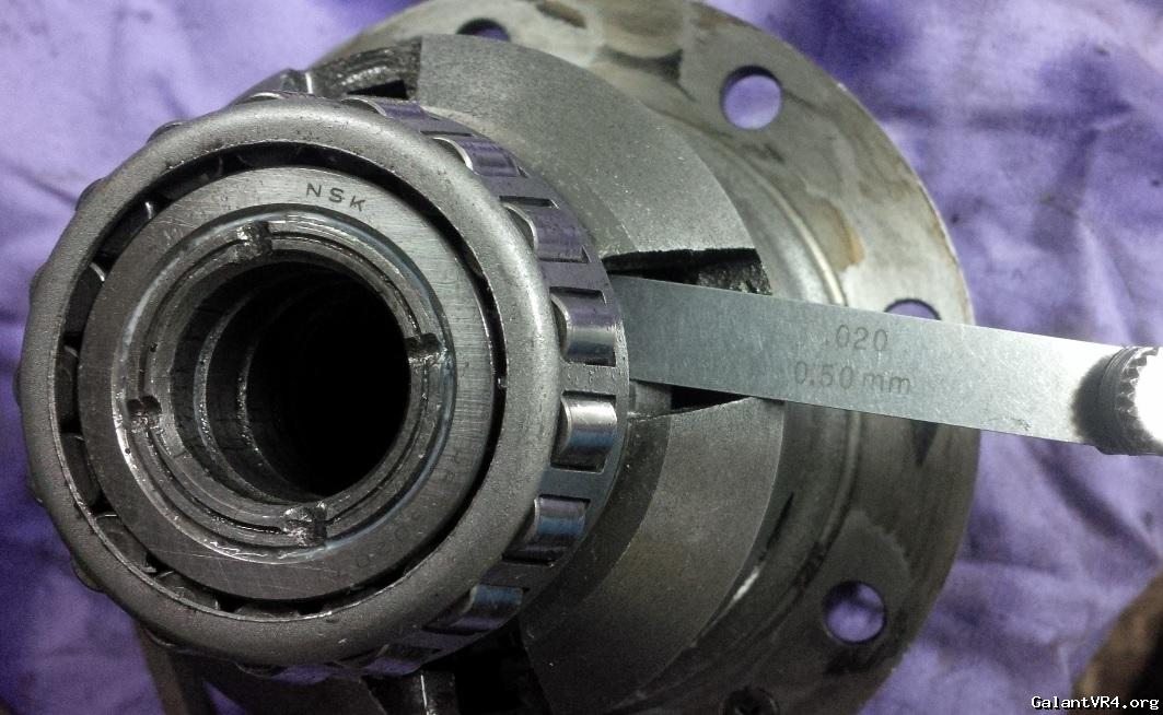

Here we go guys. I took the diff out and apart. By no means I'm not am expert in differentials, but very curious how this stuff works /ubbthreads/images/graemlins/smile.gif
I did not find anything drastically wrong with tapered bearings, all 4 of them have some wear, but nothing serious that could cause the vibrations. However I have found an interesting thing with LSD. The spider gears are a bit loose due to the gap between the spider gear assembly and the housing. Please see the pictures. My common sense tells me that this might cause the axle to vibrate when not under load since the body with spline is is loose in the housing. I wonder, what are the specs for this gap shown in the pictures. I would not mind someone to explain how this LSD works and tell me if I can take it apart, at least to access the spider gears. I see that there are two spacers inserted between the housing and the side gears. If the gap is too big (and I think it is) I could try to find an oversize spacer, or make one. Also, the splines have a gap, and they are not inline,gaps are in different places, any particular reason?

Did you have a washer on each side of your Diff?
in between the diff housing and the LSD
