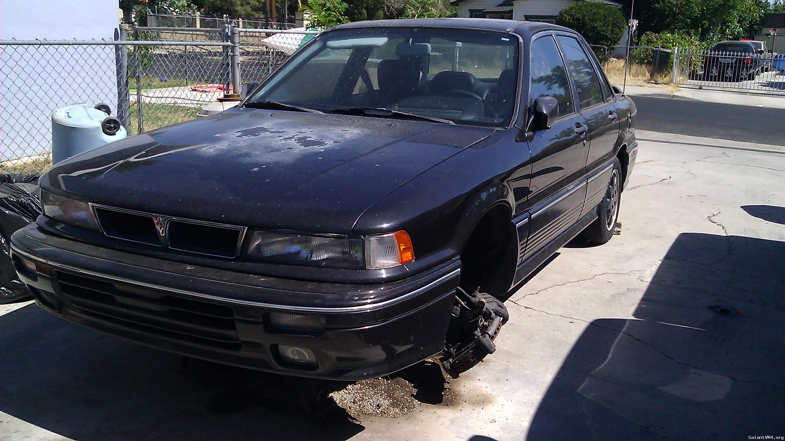

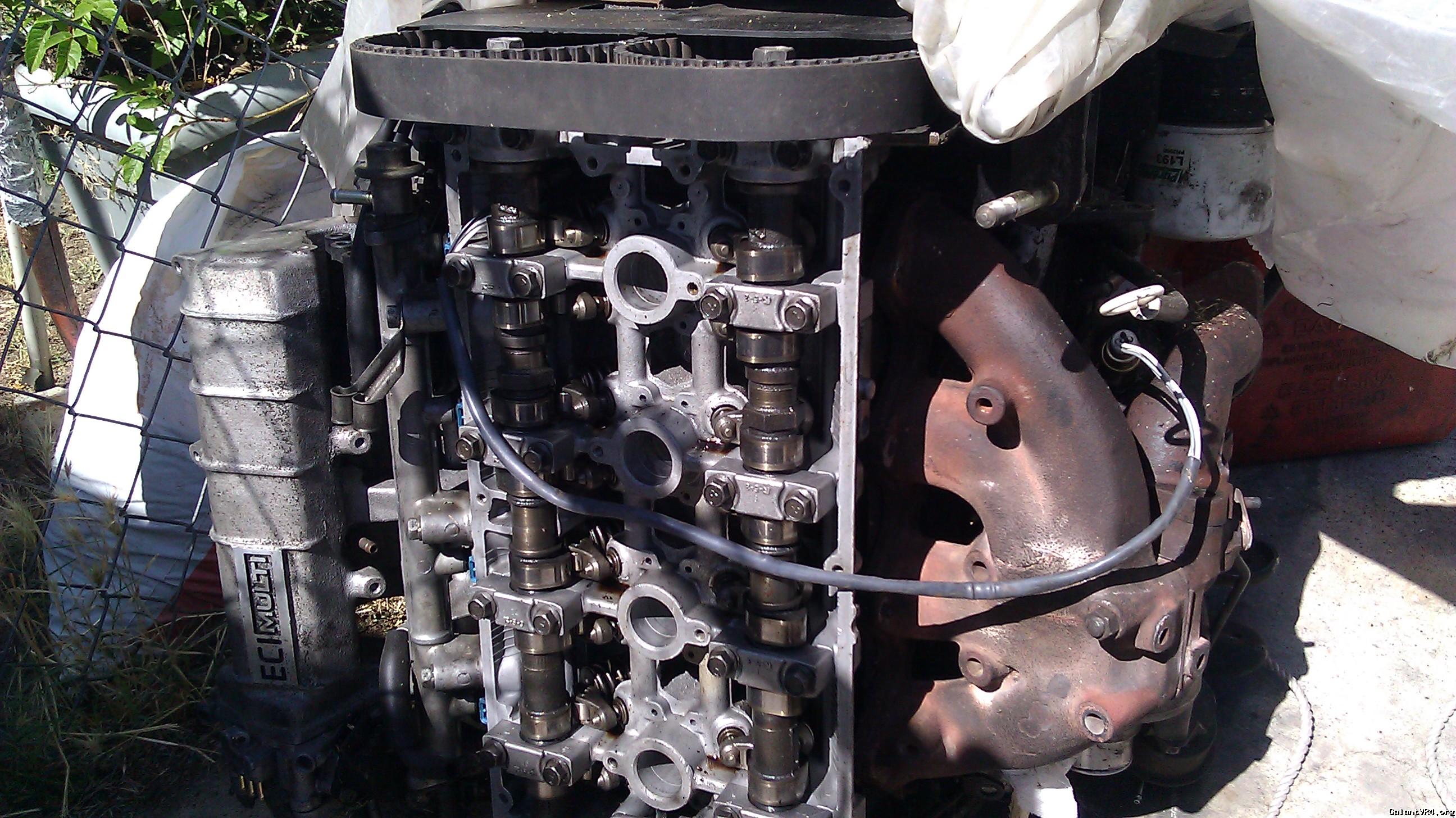

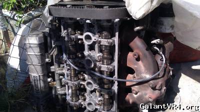

Hey hows it going I never really got to introduce my self but have asked questions in the past and seems theres quit a few people that know what there talking about and very helpful. Anyways My name is Jovany most my friends know me by gio either one will do . I sold my B13 Sentra SER to Purchase good old 385 from the ORIGINAL OWNER who maintaned it very well and had paper work to back it up with which i really like. as for mod just Drop in K&N Filter and Boost And Oil Gauges but Sadly /ubbthreads/images/graemlins/frown.gif my car stoped running due to a rod knock so Engine and Tranny are out. Plans for the Car im not 100% sure on that yet but im more of a driver so looking into suspension mods and want about 280/300hp for now ill be happy with that for now and Daily Drive it not looking for Crazy number
Heres what i have planed for the Engine and Tranny let me know your Opinions and advice im all ears if im missing anything or see somthing i can do with out let me know please.
4G63
ARP Head Studs
Cometic Head Gasket
ACL Bearing
Big 16 G
FMIC
NPR 2g pistons
OEM or Gates Racing Timing belt /ubbthreads/images/graemlins/confused.gif
Mainfold Stock or somthing else /ubbthreads/images/graemlins/confused.gif
Injector not sure which ones yet

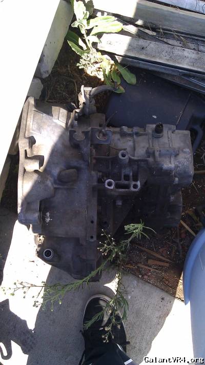

TRANNY

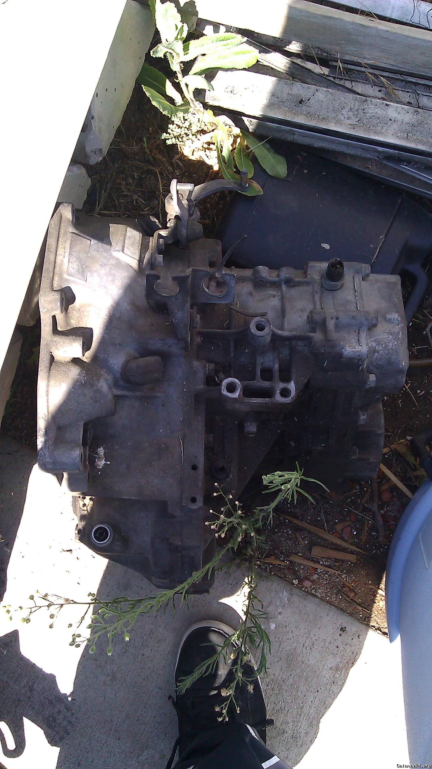

I want to open it up and check all syncros and forks ETC.... I been looking at TRE and Shep but seem a lil pricey. I wanted to see if you guys know of anybody that sells the parts to upgrade my Tranny?? that way i save a lil cash instead of sending it in.

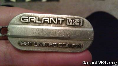

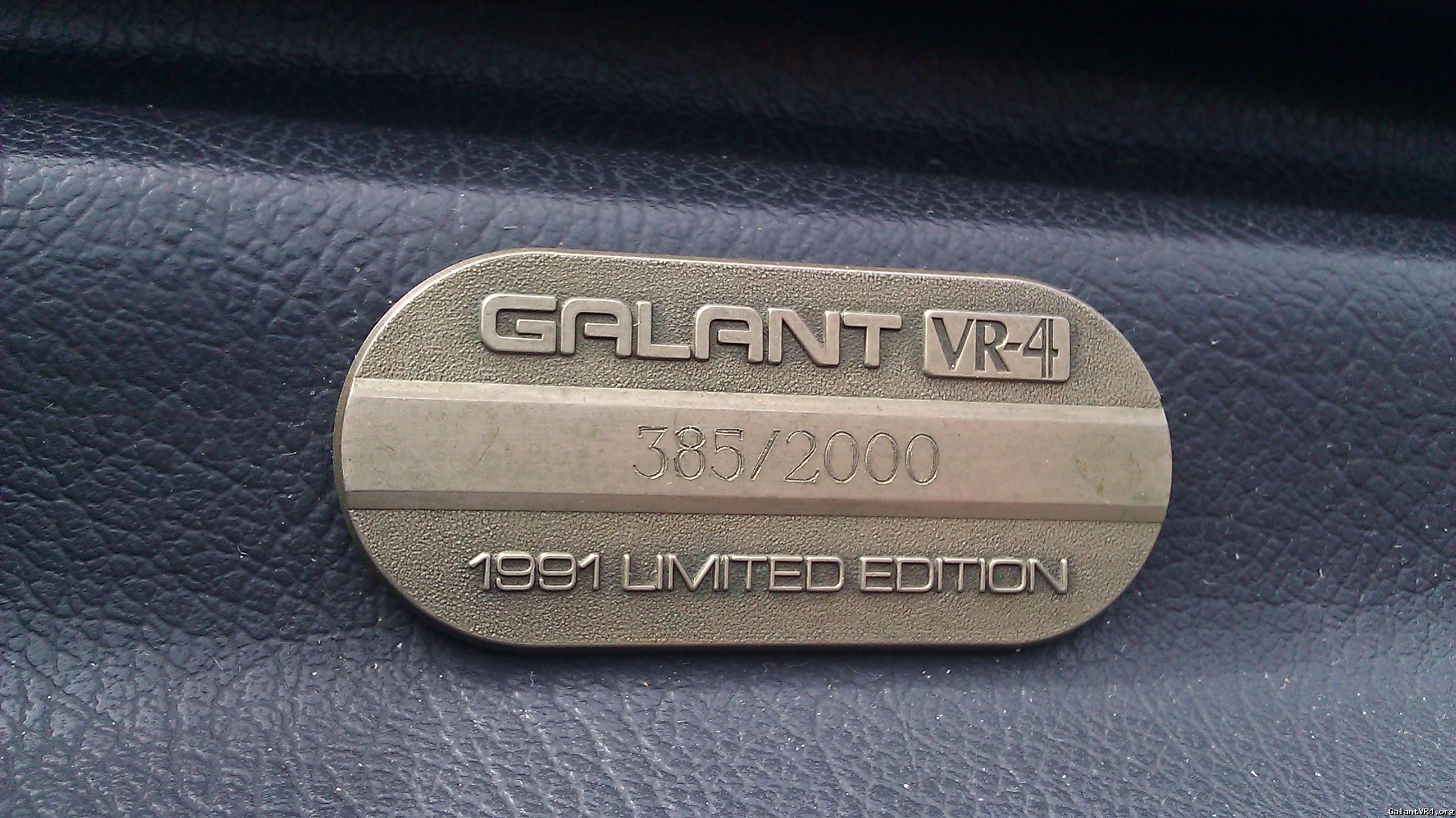

Cool that you got the key fob. many of us just got them as reproductions recently but only a lucky few still have the original fob.
if you step up to a 2g maf & 550 cc injectors you'll be very close on stock ecu. the two pretty well cancel each other out. do the fuel pump rewire (see www.vfaq.com) and consider a larger pump plus an adjustable fuel pressure regulator. the regulator is mainly due to the stock one being overrun by larger pumps, it can help with tuning as well.
