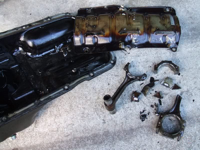

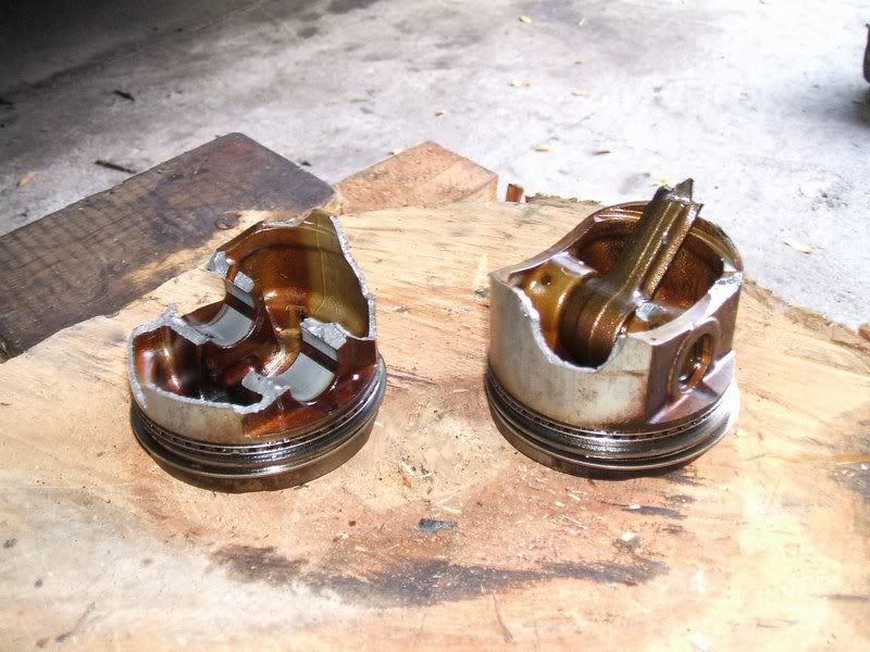

sorry but there's no way the 6A13 will handle 400-500hp untouched. The rods are seriously small and the engine WILL suffer catastrophic failure if pushed too far. The 6A1x series V6 engines are just not robust and over-engineered like the 4G63 or the older 6G7x series engine, of which even so it too has its own flaws.
Put it this way, this carnage happened to an automatic non-turbo 6A12 2000cc MIVEC-MD engine barely pushing 200hp..

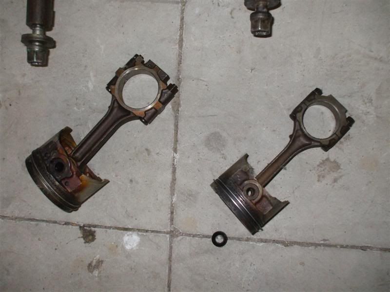

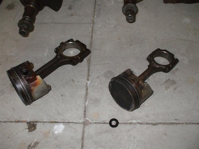

The rods are the same from the 1600cc 140hp 6A10 engine right through to the 2000cc twin turbo 240hp 6A12 engine, the only difference between the 6A12 and the 6A13 rods is the 6A13 has a larger diameter crank pin journal - otherwise the size and strength remains the same. To put this into perspective, here's a 6A12 twin turbo rod and piston next to a 6G72 twin turbo rod and piston - can you guess which is which?
