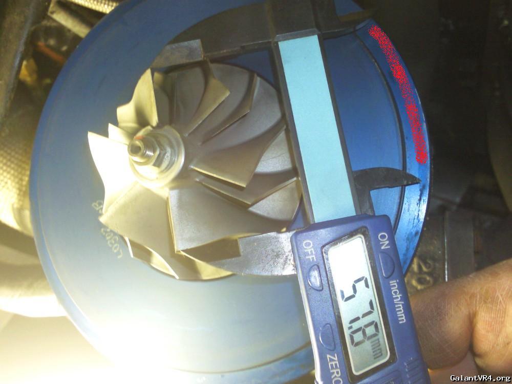

I was doing a boost leaks test and found some air leaking from my turbo. Anybody have the same problem and found a solution for it? It didn't have a gasket around it so I'm leaning towards putting some sort of sealant. The problem is that I know it gets super hot and it might melt. I was thinking of using Hylomar. The part that leaks is highlighted red.

I've learned the hard way to pull the compressor housing off every turbo before installing it to redo that seal. Last week I installed my Turbonetics 60-1 and the compressor housing was just like yours. No seal, no o-ring. I just assumed it's machined perfectly so there's no need. If your surfaces are clean (I see yours aren't) and it's still leaking, pretty much any flavor RTV is fine. I've used it on every Mitsu housing with zero issue.

Had the same problem with fp3065. Here is a thread I made on dsmtalk, I ended up RTV'ing it and no more leaks! I tried the o-ring technique people mentioned but it did not work for me.

My turbo, iirc is a Turbonetics 60-1. It didn't have any seal on it when I went to check the measurement of the blade. I guess when a lot of people check for boost leaks, they don't bother checking the turbo(at least I didn't until today).
Does anyone know hot how these things get? I have some Hylomar at hand and it says it's good to 57x degrees. If not, it looks like I would have to get me some copper RTV.
