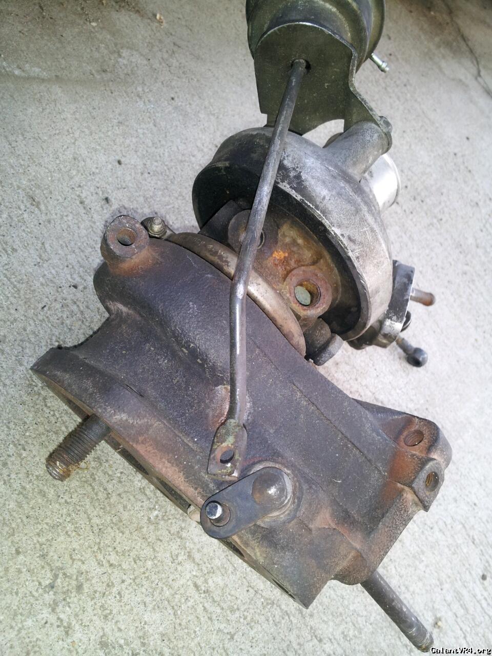

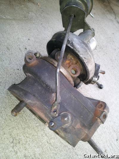

Even if the seals were completely gone I'd still believe you could make boost. I don't know any info on the car but main issue for no boost is a wastegate not closing, severe pre-turbo exhaust leaks, blown turbo.
napajs13
Active member
Mar 18, 2012
36
Webster, NY
Ok, well I have no boost and that's the first leak I found. I still need to check my exhaust manifold.
SmoothCustomer
Jul 6, 2008
3,319
Lexington, KY
Do you have an aftermarket boost gauge? Does the car pull vacuum but never even nudge past zero psi? My brother and I will both be in Fairport this weekend if you want a hand.
Vr4junkie
Jun 25, 2011
596
Some wack town in CA
Check the waste gate my car wasnt building boost at a time and it was just not connected it was a little hard to tell from the out side of the car made a boost leak tester and ever thing hope this helps out
