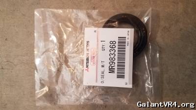

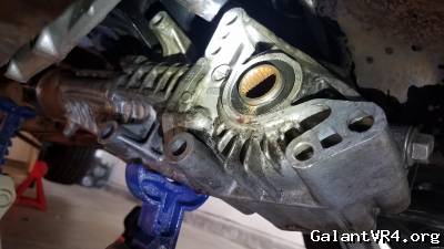

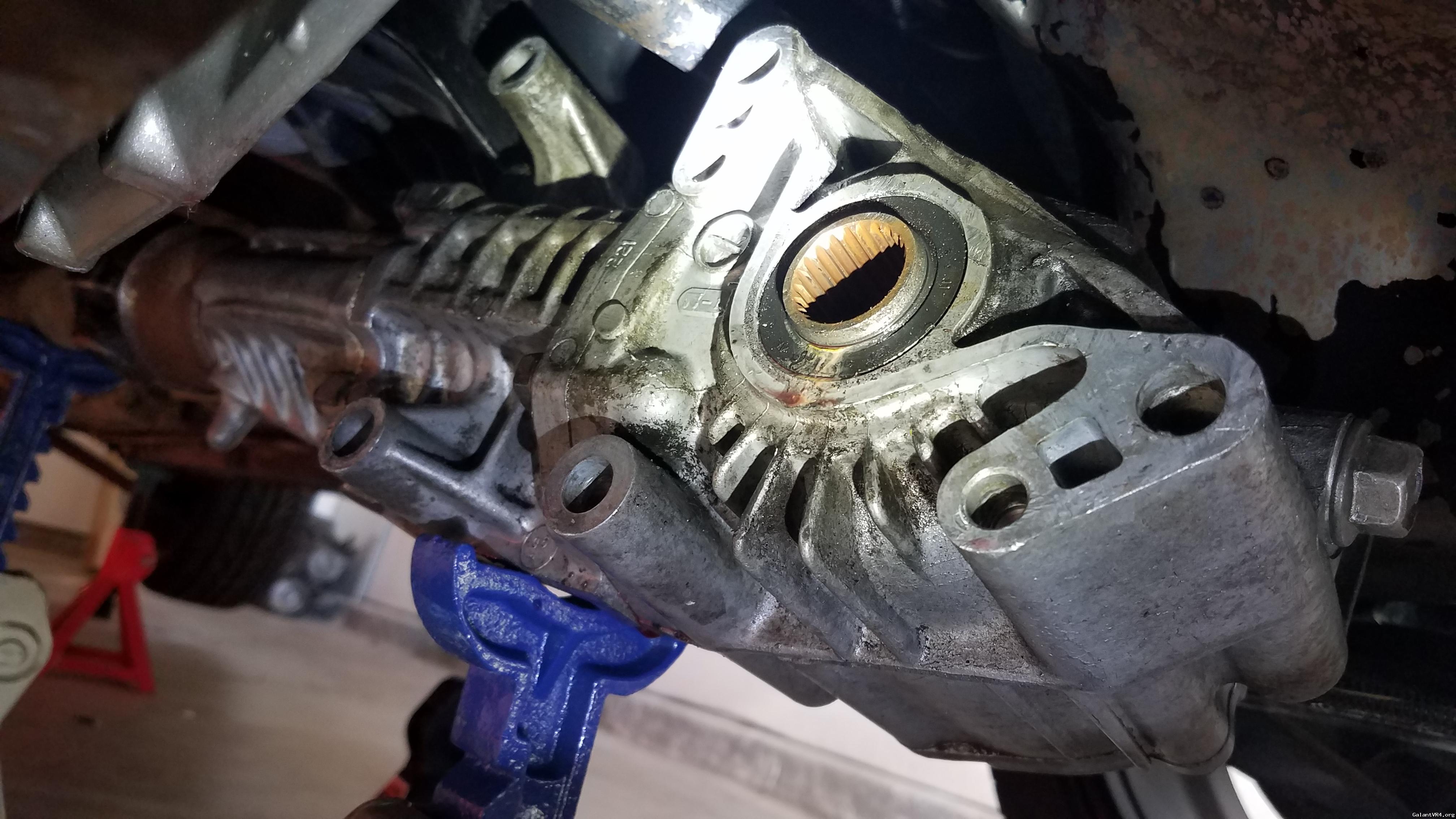

Yeah I was super pumped that it was the transfer case one and not that one in the trans. The trans was just re-built by Jacks, so I'm assuming they replaced that one. The transfer case output seal had evidence of leakage so I believe that to be the culprit. Best part, the OEM seal was only like $8 from Mitsu.

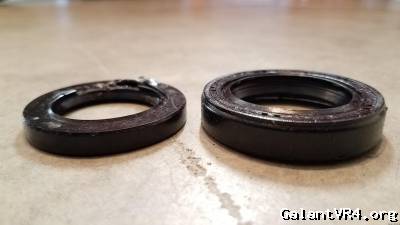

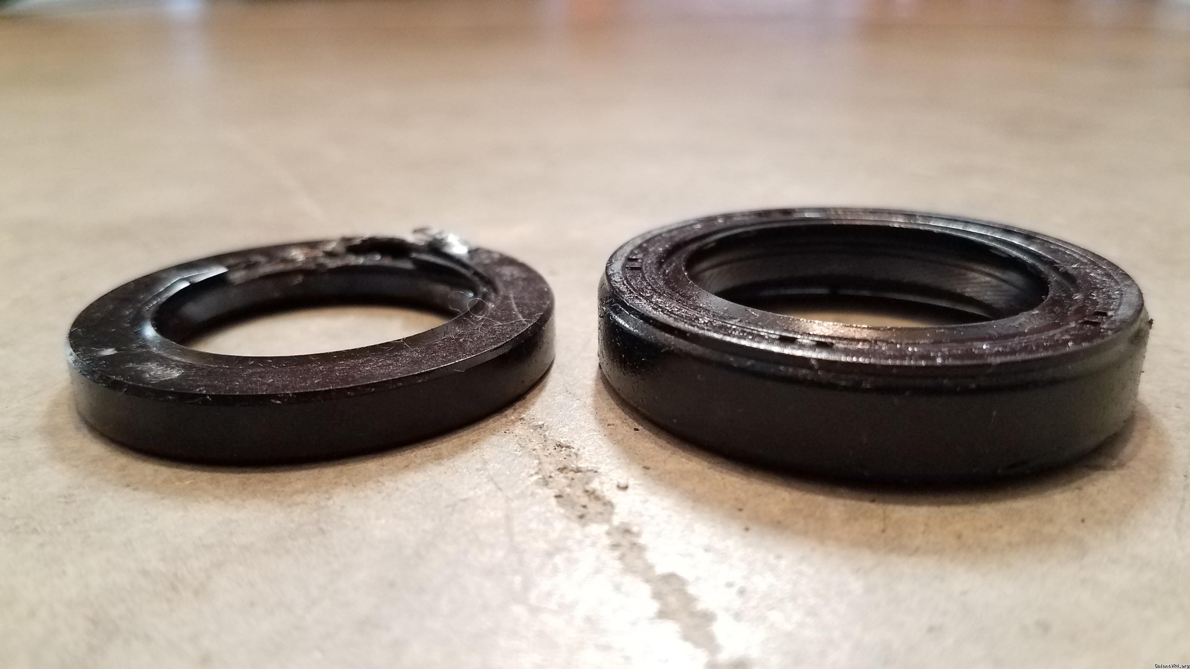

are the inside and outside diameter of the seals the same size, if so your fine, the height is probably because its an after market sealthatyou removed. the one i put in my transmission for the output shaft seal was way shorter then the oem that came out.

Tried it with an old 32mm socket (I used for Saab oil filter changes) with no luck. The seal is hard plastic with a rubber interior so not a ton of flex. I'm always cautious around tapping in seals like this as I've damaged some in this manner in the past. I was thinking about slightly heating up the transfer case around the seal location to get a little more room, but not really a fan of rubber/plastic seals going against hot metal.
Chad989of2000
Jan 13, 2005
1,791
Livermore, CA

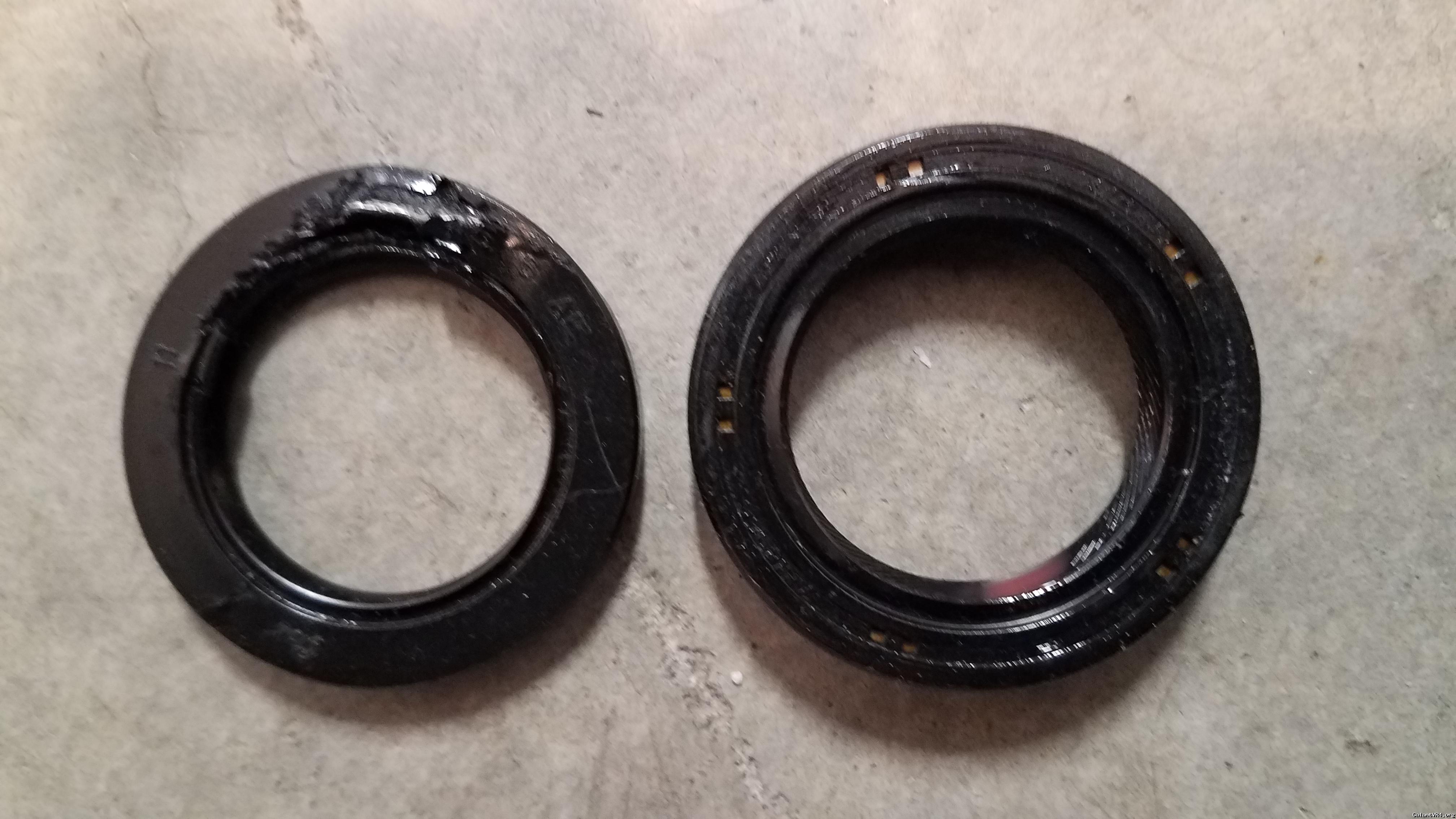

Also...inside and outside diameters are slightly larger on the OEM new one. Maybe the old one was the wrong size. I've done a ton of research and the part number is always the one I sourced...doesn't differ between 23/22 spline transfer cases or aluminum or aluminum/steel ones. This does not appear to be a common or well-documented job. I'll try to throw a little how-to together when I get it done.

Quoting Chad989of2000:
This looks loke the culprit. This the seal you were talking about?
The t-case input shaft seal (as pictured above) measures;
45mm o.d.
30mm i.d.
6mm thick
The pressfit is approx .18mm (or ~.007 thousands of an inch)

I'm an idiot. I purchased the output shaft seal instead of the input shaft seal. Guess I might as well swap that out too. /ubbthreads/images/graemlins/banghead.gif
