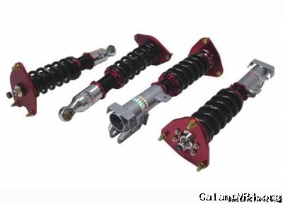

You mean these? If I was you, I'll would buy them and try. If you fail you can still sale them for more than you paid for them. Win, win in my book.

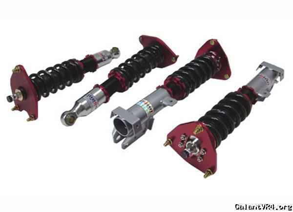

That was my thought, even if I end up completely destroying them I'm only out about 90 dollars plus my time (worth basically nothing). And that was just a generic picture in your link, they look more like this.

I just went and got them from the junkyard and they look pretty close to just being bolt on. The backs are actually a two bolt pattern instead of a three like in the picture so that's nice.
