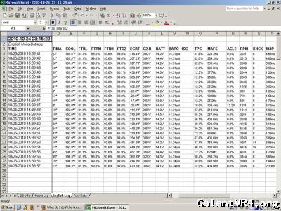

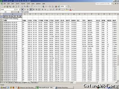

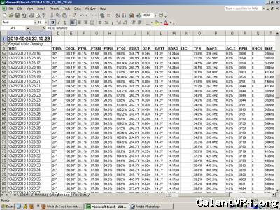

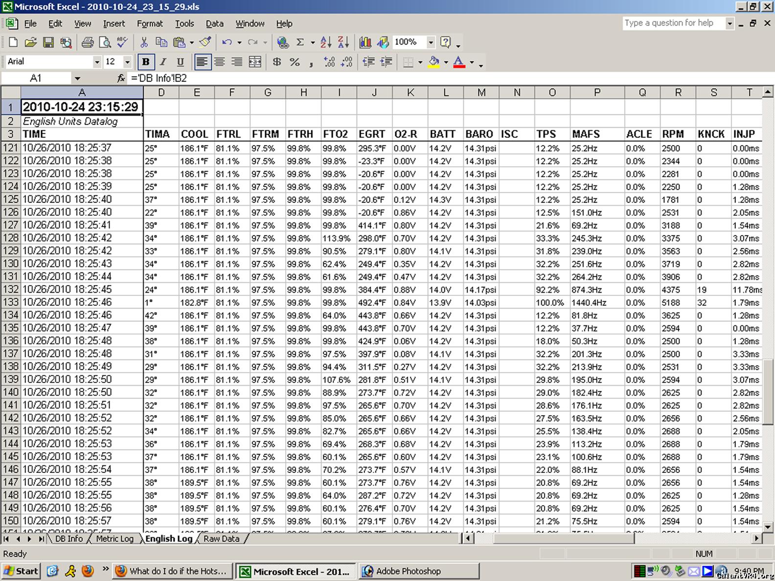

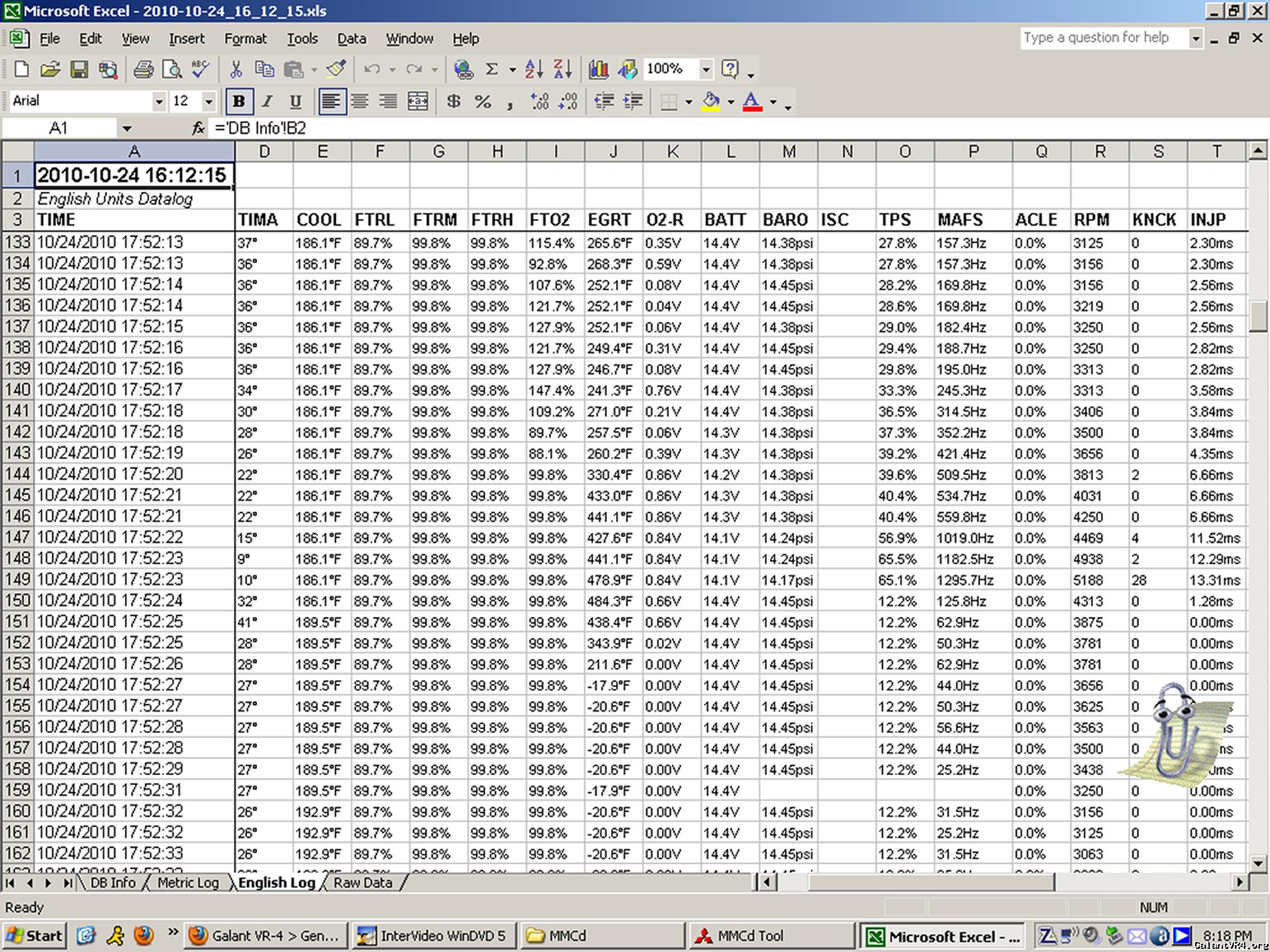

For the life of me I can't figure out whats wrong with my car.
I pulled the plugs today and noticed carbon build up on the top of my pistons and that the number 4 piston looked like it had moisture on top of it. My car doesn't smoke unless I put the throttle down. And when it starts to knock a big could of black smoke comes out.
I don't know why the EGT field won't convert to my wide-band like on my logger.
I'm totally out of ideas. My wide-band says my 02 is well within range.

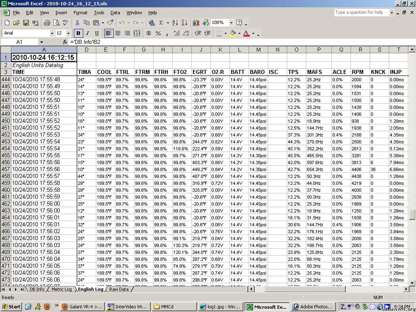

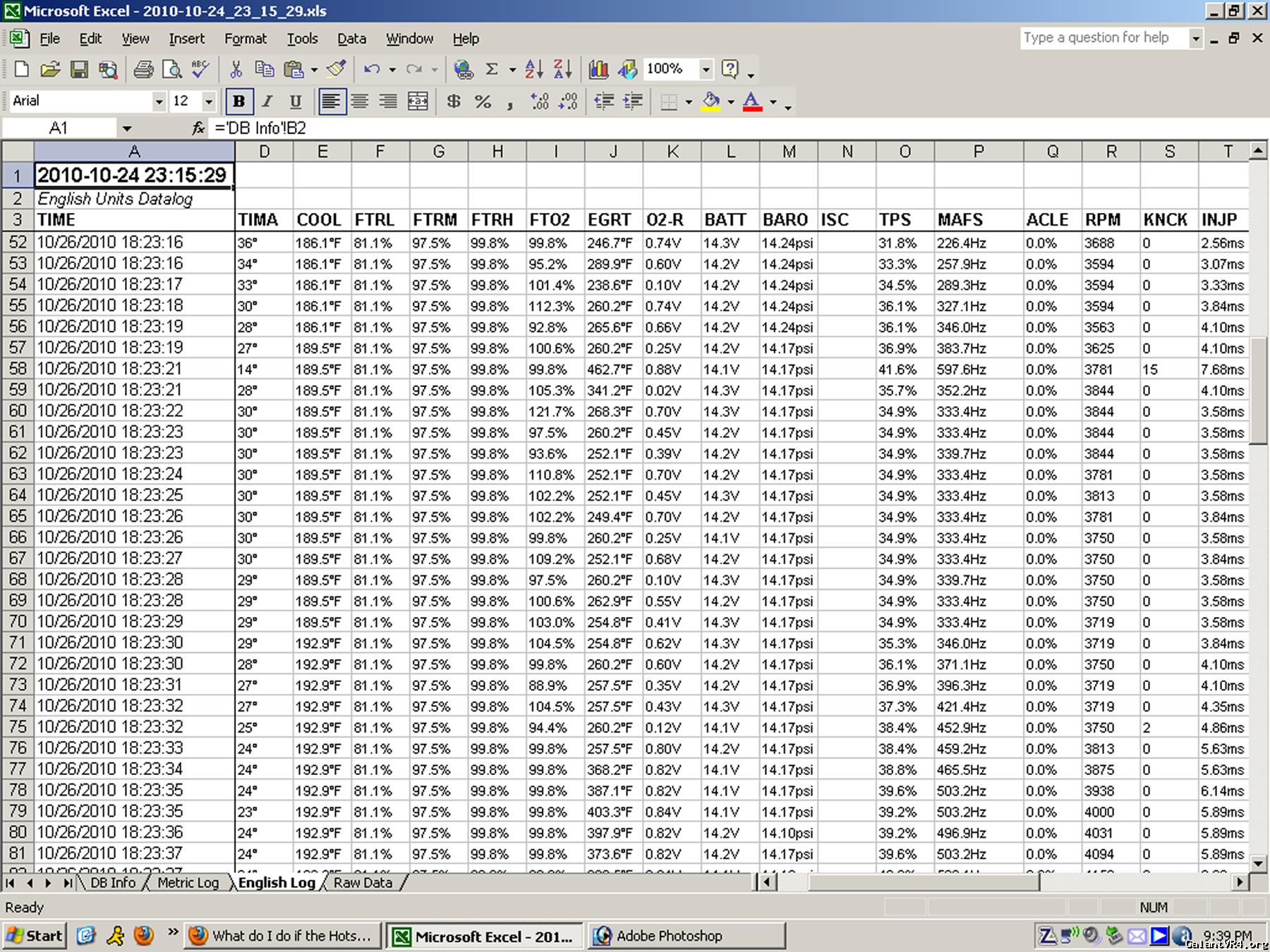

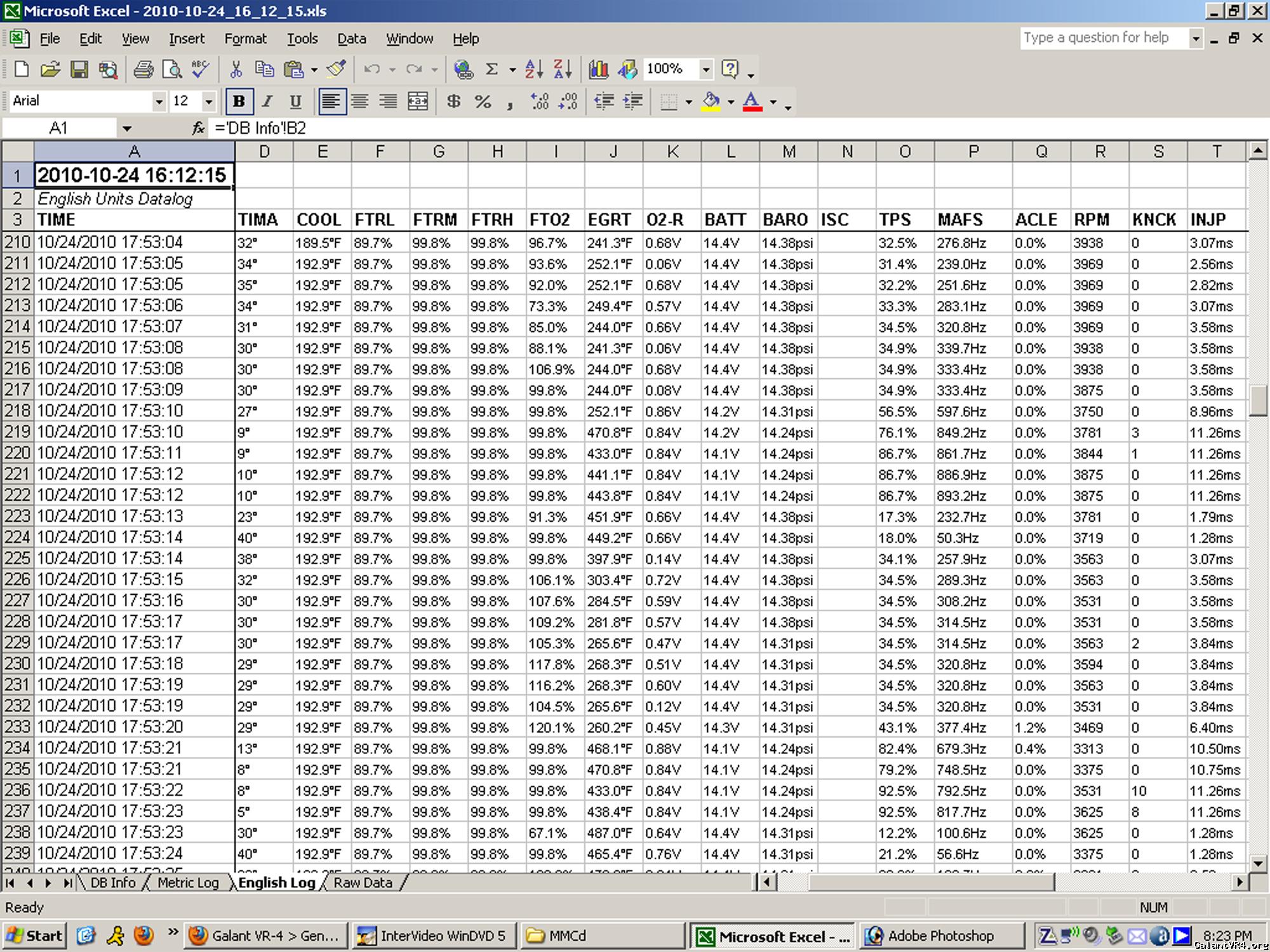

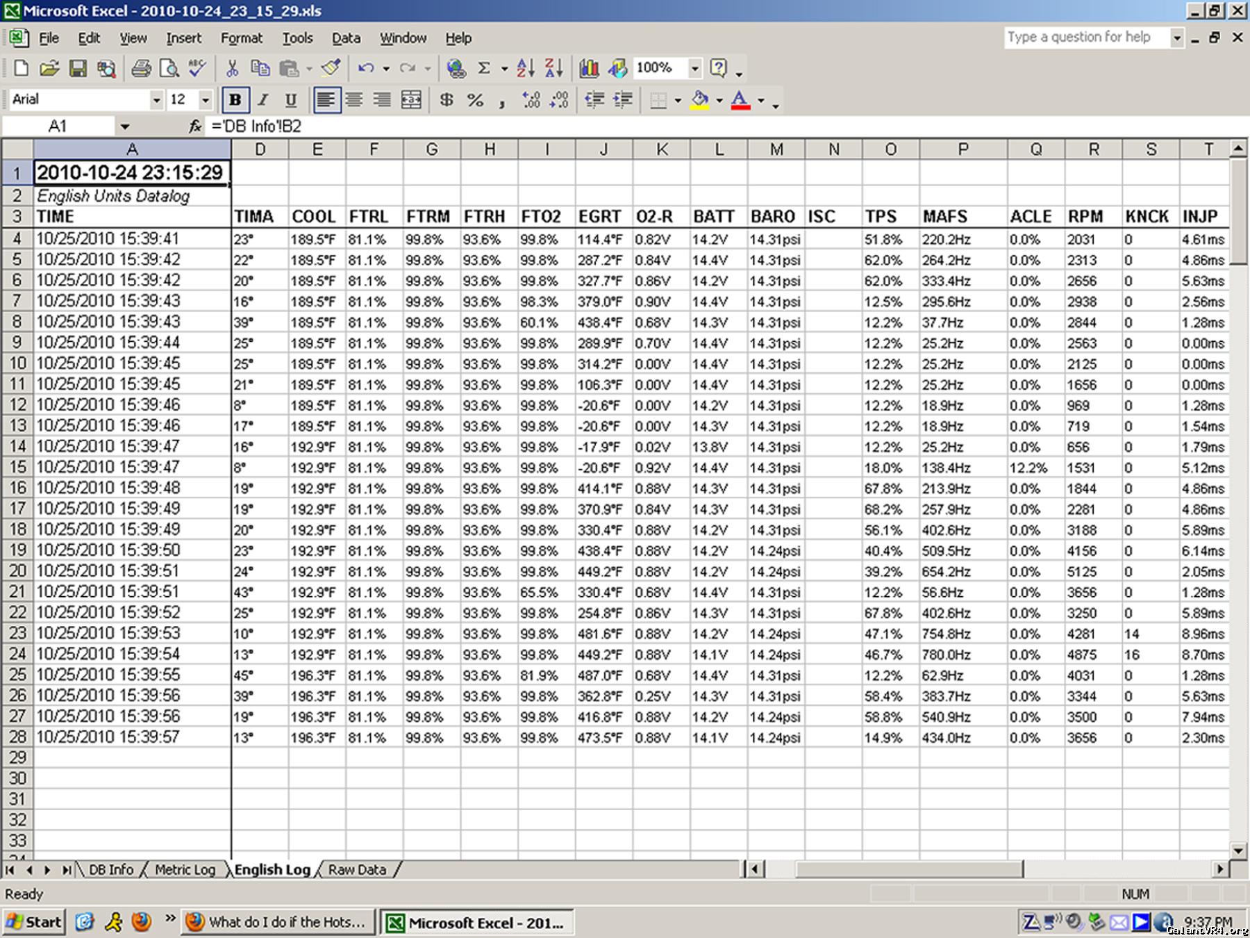

Hill and I ran some seafoam threw a vacuum line... didn't help. Boost leak test was performed the other weekend and no leaks. Every time I'm under the car I look for something that could be loose I can't ever find anything. We did a couple more pulls, still knocking. The last pull though the wide band said its running lean. I don't know how the hell that could be possible. New fuel pump, replaced the fuel line from the tank to the fuel filter. The fuel filter is new and I just had my injectors cleaned and tested a month ago. I rebuilt the fuel pressure regulator a couple of months ago also. And I've checked the voltage of the fuel pump at idle and it read 13.63v. Unless some how the fuel pump voltage is dropping under boost. /ubbthreads/images/graemlins/dunno.gif I'll post the logs up in a few.

Steve if it is phantom knock I don't know why my knock sensor is picking it up. I'm almost positive Jeff burned my eprom chip to ignore phantom knock.
Hill I noticed today that I'm getting knock before my wastegate even opens. I still want to get a recirculated 02 to see if that helps at all though.
I'm going to check tomorrow and see if my bracket that bolt the drive side axle to the block and come loose but I really doubt it.

I am stilled puzzled as to why the timing is so low though can it be pulling that much timing?
