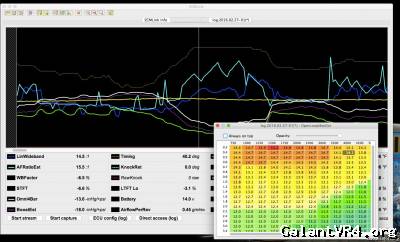

Logs @ the link below. Pulls done on the 27th had new SD table values to clean up a slight lean condition @ WOT that I was seeing on the 26th.

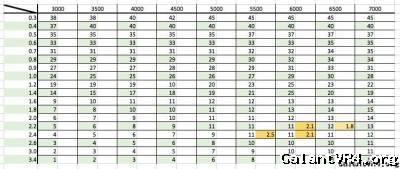

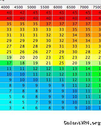

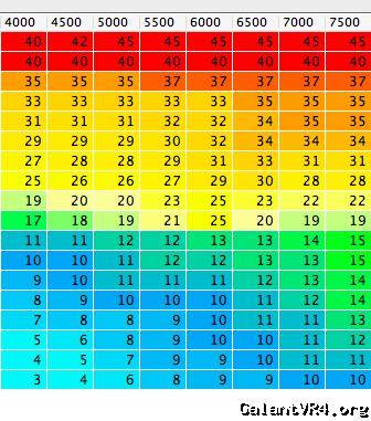

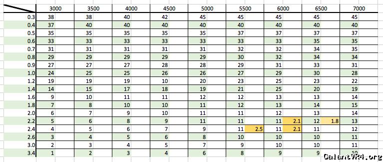

Does octane booster really work? I know I can buy race gas at PIR if it comes to that... For now, a slight timing adjustment seems to have helped out. I graphed where I was seeing knock across 3 pulls:
And I adjusted my timing from this:
To this:
The 2nd gear WOT pull I did this morning felt promising, but I was driving to the gym, so I didn't have my laptop hooked up to log. I'm sure I'll get a chance later today or this weekend and we'll see how everything looks. I expect with my mods and 92 I should be able to see at least 22-23psi without much hassle. Any more than that and I would want higher octane.

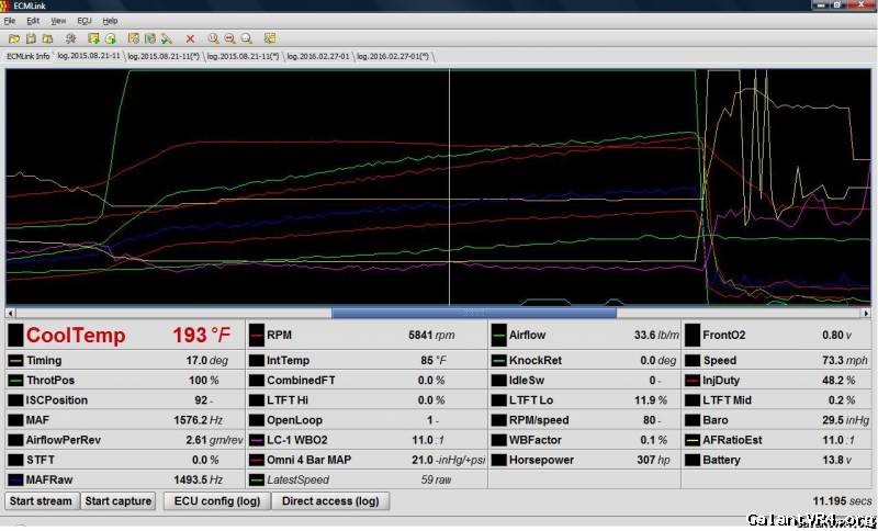

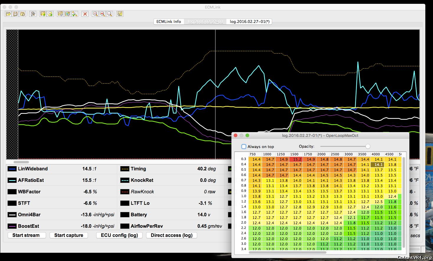

The tune could use a little work. Looking at your 2016.02.27-01 log, your WBO2 is reading almost a whole point richer than your AFRatioEST. You should adjust that out.
I can't tell much from the 2nd gear pulls; there's not enough good data. Most of the fuel data is skewed by the turbo spooling up. That's why 3rd gear pulls are much better for good data collection. As seen in your 2016.02.27-01 log (starting about 236.000 secs), once boost and airflow level off, it's a lot easier to see what's going on. You can clearly see there where your WB isn't lining up.
I can almost guarantee you're not seeing spark blowout, though. You may have an ignition issue, but it's definitely not spark blowout.

I believe that. I thought I found a unicorn just a short drive from my house, but when I arrived, I discovered pure (non-ethanol) 92-octane, not 93 or higher. From what I can tell, non-E 92 is just $2/gal. more 92 in terms of what it would get me since 92-octane is still 92-octane. In fact, I gotta figure that less ethanol isn't going to be a good thing.
So yeah, about my AFRatioEst... generally, the wideband tracks pretty close to where I have the target open-loop octane tables. So in this case... well I suppose this is my reasoning, and tell me if I'm wrong:
Let's take a section of my log where I'm showing 14.5:1 on my WB, 15.5:1 AFRatioEst, and 14.1:1 in my OLMO table. In this case, the WB tracks fairly close to the OLMO value through this part of the log, even though it's off by as much as 2.0:1 with the AFRatioEst. If I adjust the VE table to lean out at/around the cells where I see this, I'm taking the AFR towards the AFRatioEst and away from the OLMO value.
So what's a person to do? If I get the WB (actual AFR) to match the AFRatioEst through VE adjustments, I'm even farther from my target AFR's. I've been doing the opposite, only focusing on how the WB, AFRatioEst, and OLMO table match-up at WOT. And in fact, checking the log you referenced, I can tell with my current configuration that I've already adjusted my VE in/around the cells where the AFRatioEst and WB readings were off. But in this case, that's only because the AFRatioEst and the OLMO table seems pretty in-sync when I'm at WOT. I suppose that makes sense since at WOT, it's running in open loop.
I know during closed-loop, the AFRatioEst is a reflection not just of the OLMO table, but other bits and pieces, with the O2 sensor being no small part of the equation. should I just be trusting that the car knows what it's doing in closed-loop and try to get my WB readings in-line with the AFRatioEst value through the VE table?

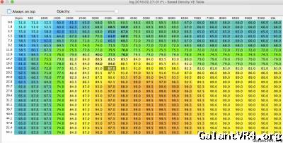

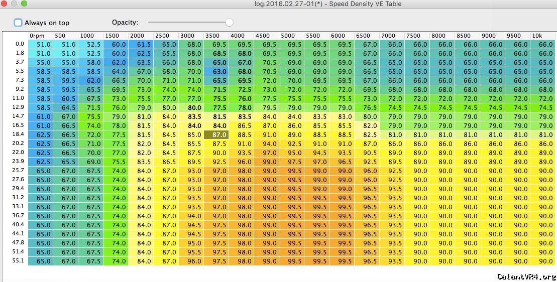

As a lark, I ran the SD adjustment tool on the long log I posted (2016.02.27-1) and it would seem as though all of the recommended adjustments are in the same area. Now it's a small sample set to be sure, but the fact that the adjustments are in the same area of the VE table is leading me to believe that the car "knows what it's doing" at cruise and the I should be tweaking the VE cells at cruise to get the WB to match the AFRatioEst value, not the OLMO table...
I'll do a proper low-to-moderate load-factor cruise and see if I can get a better fix on where my values should be. I'm happy with my open-loop values (I did make some changes that cleaned up the drift at WOT you can see in the referenced log). Don't mind getting the cruise AFR's sorted, now. Then back to timing and boost and all the other fun bits.

Dude, you've got to realize it's damn near impossible to optimize your tune under every set of driving conditions. So, concentrate on getting it right when it REALLY matters; at WOT. I mean honestly, who gives a sh*t of your WB is tracking AFRatioEst in closed loop. I wouldn't even bother looking at that section of the log.
If you look at the section I pointed out when you did your pull (~236.000 secs), your AFRatioEst matches exactly what your OLMO table says it should be. Now, there's where you should be concerned, since your WB isn't mirroring AFRatioEst. I mean, it's not that far off, but I'd adjust it out if it were my car.
I think your main issue is you're a perfectionist. When you find someone who can tune your car perfectly, let me know...I think if you quit looking at logs every time you drive to 7-Eleven, you'd be fine /ubbthreads/images/graemlins/wink.gif

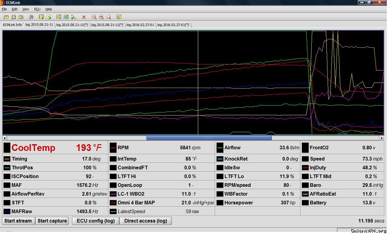

Concentrate on doing 3rd gear pulls that will net you good data to tune from. I roll into the throttle from about 3k to redline every pull. Just watch for knock, and get out of it if you're seeing 3-5 degrees. Then, make your adjustments, rinse, and repeat.
Here's a snap of a log from when I swapped to 1050's on pump. You want your WB to line up like so:

No, that log was on 93 pump, low boost. I didn't make the swap to E85 until months later.
