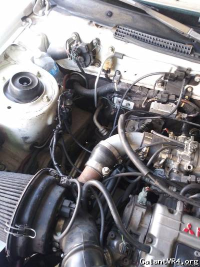

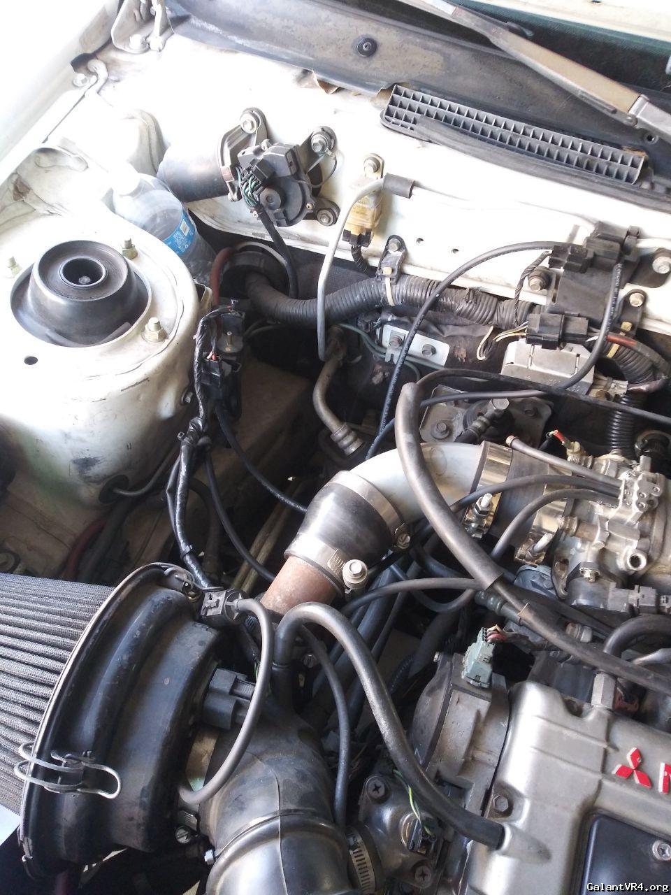

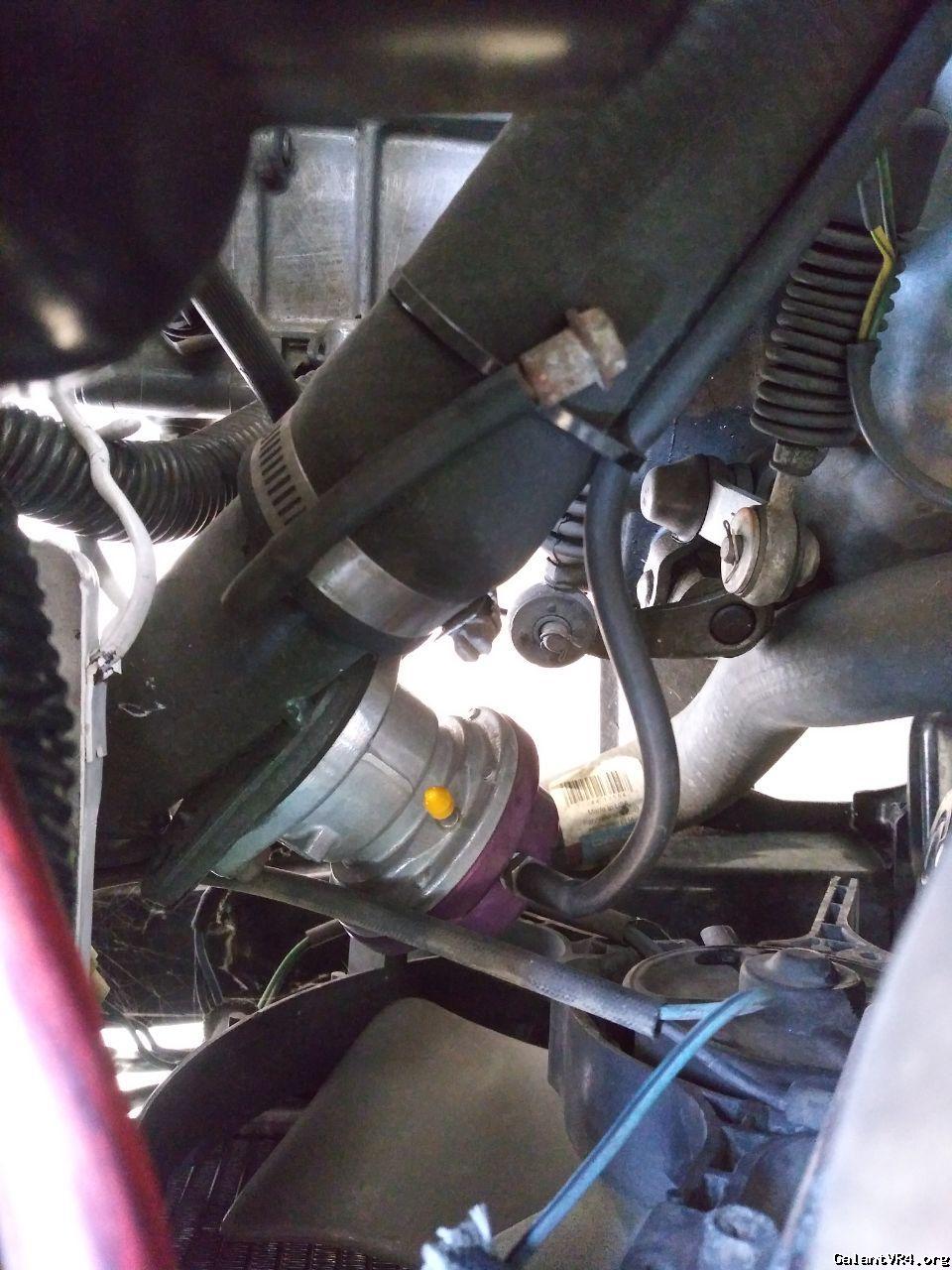

IM IN CALI TOO.SO I KINDA REROUTED SOME LINES KINDA WORKS A LITTLE BETTER BUT WHAT IT DOES IS WHEN ITS COLD IT RUNS GREAT FEEL THE TURBO AND EVERYTHING, ITS WHEN IT WARMS UP WHEN IT STARTS TO LAG ANY IDEAS. I ATTACHED SOME OLD PICS OF WHAT IT USE TO LOOK LIKE LET ME KNOW IF THIS WAS RIGHT I SEE TWO SENSOR THAT DONT HAVE ANYTHING ATTACHED.

Start by printing out that diagram and open your hood. Identify something from that diagram under your hood and start from there. Looks like spaghetti but once you start following the hoses and make sure they are plugged into the correct ports things will get easier. That is how I got mine sorted out. It's just matching things from the diagram to the real things under the hood.
Btw - is that throttle body a non turbo one? My car has the elbow attaching directly to the throttle body itself without the coupler. It also looks like you are missing one vacuum hose from the top of the throttle body. Ground strap that throttle body uses as a ground looks like it's missing also. The idle stop switch uses that as a ground.

You probably have a really bad boost leak. Make yourself a home depot boost leak tester and put about 15psi in the system. Look up how to build and use it on YouTube. I'm sure you have a few leaks in the system.
I don't see a charcoal canister in there either. Your gonna have a lot of work ahead of you to be able to pass smog.
If passing smog however isn't an issue for you then I would go with the vacuum delete and get things set up properly.

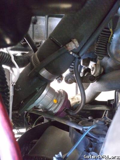

I see a port by the BOV that is supposed to be part of the boost control system and it's just plugged with a screw that I'm sure is just leaking.

Find a local DSM group and get with somebody that knows what the f*** they're doing. That car looks like a hack decided to tinker with everything and got it all bungled up. There are probably so many issues with regard to vacuum lines and boost leaks that it'd be quicker to just find somebody that can see it in person and route everything properly than try to have us diagnose it over the internet. You need somebody that is familiar with the vacuum line routing, boost leak testing, and resetting the BISS and idle. I'd be willing to do so it if I were closer but alas, I'm not.

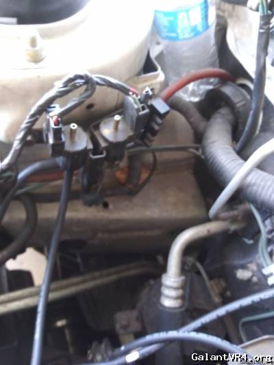

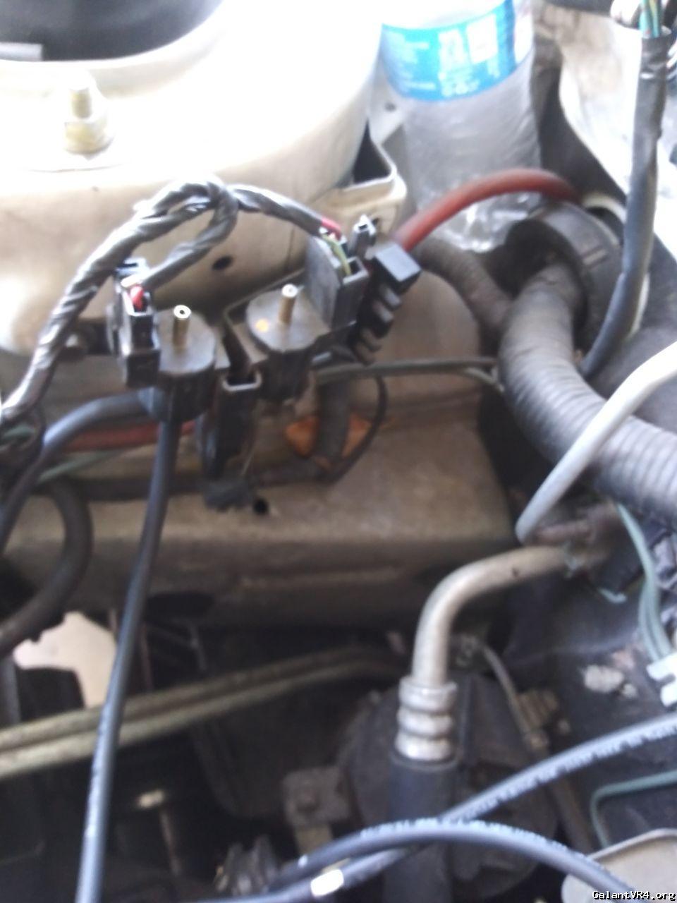

Are able to tell me with one of solenoids is the fuel pressure solenoid.

Search is your friend...https://www.galantvr4.org/ubbthreads/showflat.php?Board=UBB3&Number=716165&page=1&fpart=1

Do you know any history on the car? It looks like a hot mess. It looks like the fuel filter is missing, as already mentioned, the intake elbow is wrong. It's suppose to bolt up to the throttle body. Kinda makes me wonder if the throttle body is correct. The valve cover is from a DSM. So, technically, the whole engine could have been swapped.
Before you go into repair mode, I'd personally want to know the history of the timing belt and water pump. I'd also do a compression test on the engine to make sure you have a strong engine before attacking the rest of the issues.
Just my .02. If it were me, I'd make sure the engine is healthy and the timing can stay in time. After that, I'd attack the missing/wrong parts and vacuum lines.
I'm a little concerned someone swapped in a non-turbo engine.

The non turbo throttle body isn't a big big deal, they can be made to work. After looking at your pics a bit longer, it seems your friend swapped in a 7bolt engine into the car. I have heard of people going from 7bolt to 6bolt but not the other way around. I was only able to notice by looking at the CAS and it looks like a 7bolt one. We need to gather as much info about your setup as possible to help you out. If I come out that way anytime soon towards SB I can swing by and help you get started on sorting this out.

Looks like you are only 25 mins or so from me. Can you post better pics of the engine bay so we can see what else is going on in there? Any relevant information that was given to you by previous owner will help us to better understand what is going on as well.
