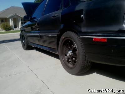

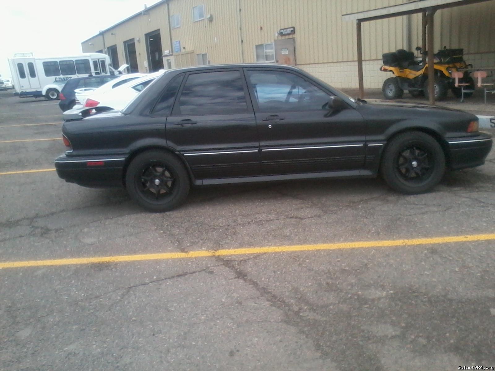

Just got done with my 14 hour escapade. I used summit racing 2k urethane primer and a single stage carbon fiber metallic with a clear coat. Total cost was around 400 with a sharpe spray gun. Came out really well. Just need to wet sand and buff.

I think cheap color changes ruin the car. It looks like a $400 paint job
LIV4PSI
Nov 24, 2011
1,774
O-H-I-O
There are very visible dents, the paint is splotchy all over the passenger side, the engine bay etc don't match now...
I have nothing against people changing colors on these cars, rdomneck's looks great. I just think if you can't afford to do it right, leave it alone. And that means proper prep work, and painting everything. There aren't enough VR4s left for hack color change paint jobs
Edit: I should of started out by saying props for not being scared to DIY. For an amateur paint job, OP did very well. My best friend owns a body shop, so I guess he has made me over critical

The only dent I can make out is the one under the right headlight and the rear bumper has a flaw. Outside of that I don't see much else wrong with. The paint looks decent in pics, some color sanding would make it look great.
Is this your first time spraying a car?

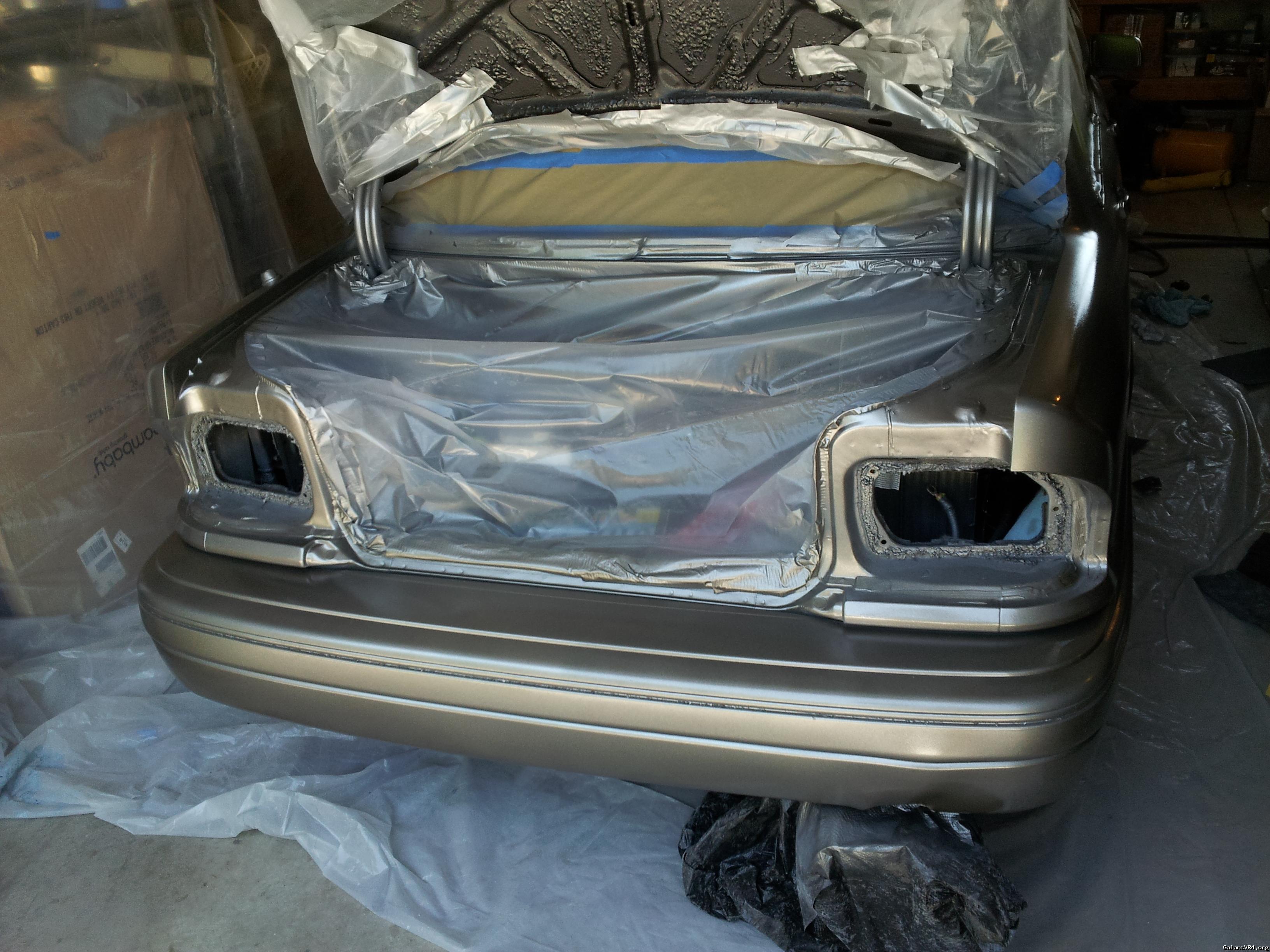

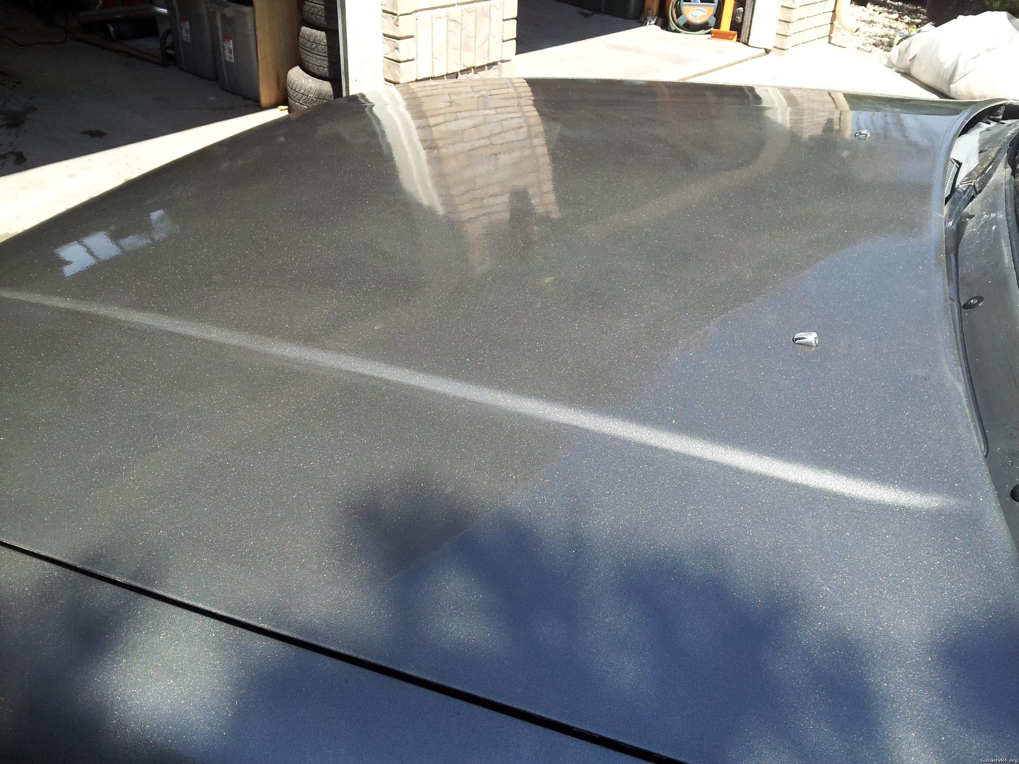

The engine was out of the car when i painted it. I didnt show any pictures because i wanted to see who the first to bash it was. Also the inside door jambs and trunk were painted to match. For thepaint being splotchy. Its not the paint it called orange peel and i have not color sanded or buffed yet. Yeah there are still dents but i did not feel like spending a bunch of time doing body work. Btw Ive painte many cars and i do know what i am doing. We would charge 1700$ for the same paint job.

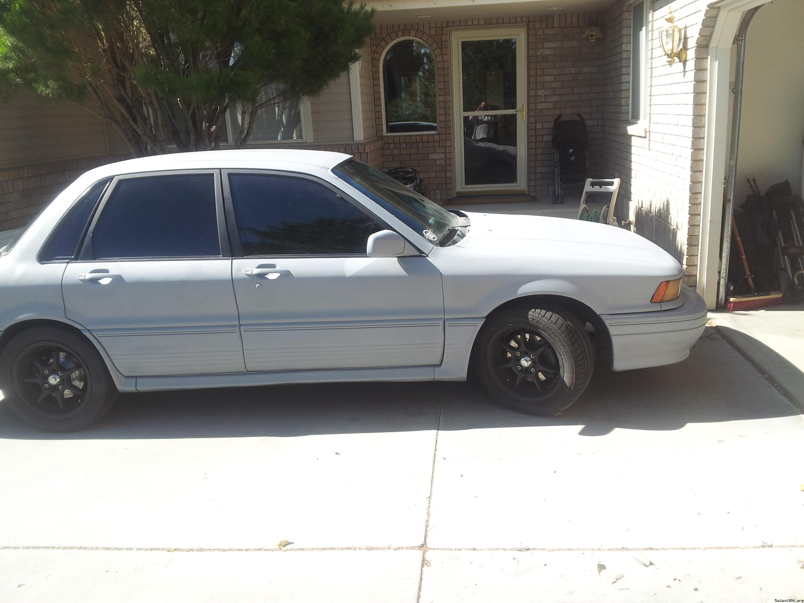

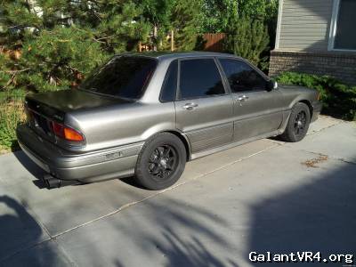

Heres a couple before pictures. Through hood and front right fender were both resprayed at some time before me and someone didnt spray the clear within the proper time so the clear eventually came off. The left side rear also had primer spots. The car was stored in a garage with a bunch of crapy on it so there were scrapes all over to the primer. I could have spent more time on it but i just wanted something that looked nice and all one color. Plus we had some cobra dsg laying around. Like others stated to me its not worth spending more than 1k in supplys because it only worth from 3 to 5k. Anyways once i get my jdm bumpers in i might re paint it but in person it looks pretty good. To orange peely. But on Monday at work ill break out the 1k and 2k paper and then buff it with our 3m medium cut then polishing compound.

Paint being splotchy does not have to do with orange peel. Has to do with spraying a metallic in single stage. You will never get that splotchy look out with a single stage metallic. It takes some special techniques to get a metallic to lay down and those techniques are not possible when spraying single stage!

Well it was not the the single stage base that was looking splotchy it was the cleqr . I know what you mean though. I used my criss cross pattern and angle spray method. There was only one area that came out splotchy and it was by the fuel door. Overall it came out pretty good. I just need to wetsand and buff To get the full gloss
