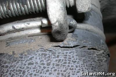

It's the lower part. Mine cracked on the bottom side where it enter the tank. A trail of fuel behind the car and puddles at stoplights are kind of a troubling sight.

Mine is cracked in the exact location u described. It doesn't leak yet but severely dry rotted and its good to know these are still available.

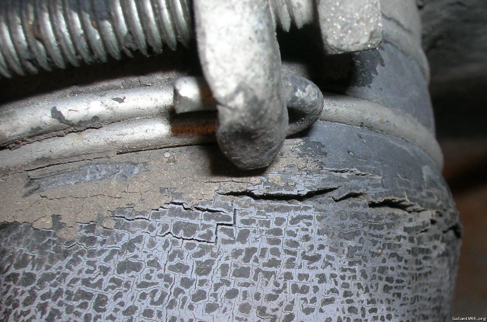

February, 11-teen degrees, this is what mine looked like...after it returned 1/2 tank of 93 octoid to earth :-O I wrapped miracle tape, I mean duct tape around it then put a hose clamp over that. It stopped the leak until the JNZ replacement arrived, which was $38 plus shipping. I lifted that side way up before pulling it off so the (rest of the) fuel wouldn't spill all over.

Are we talking about the rubber section? I'm pretty sure when mine failed I just replaced it with a generic rad hose that had a 90° bend at one end. No reason to worry about them becoming scarce imo.

Mine wore out in that same spot. Can't really complain, seeing as how these cars are 23 years old. Went to the dealer, ordered it and the next day picked it up. I didn't think anything of it at the time.
