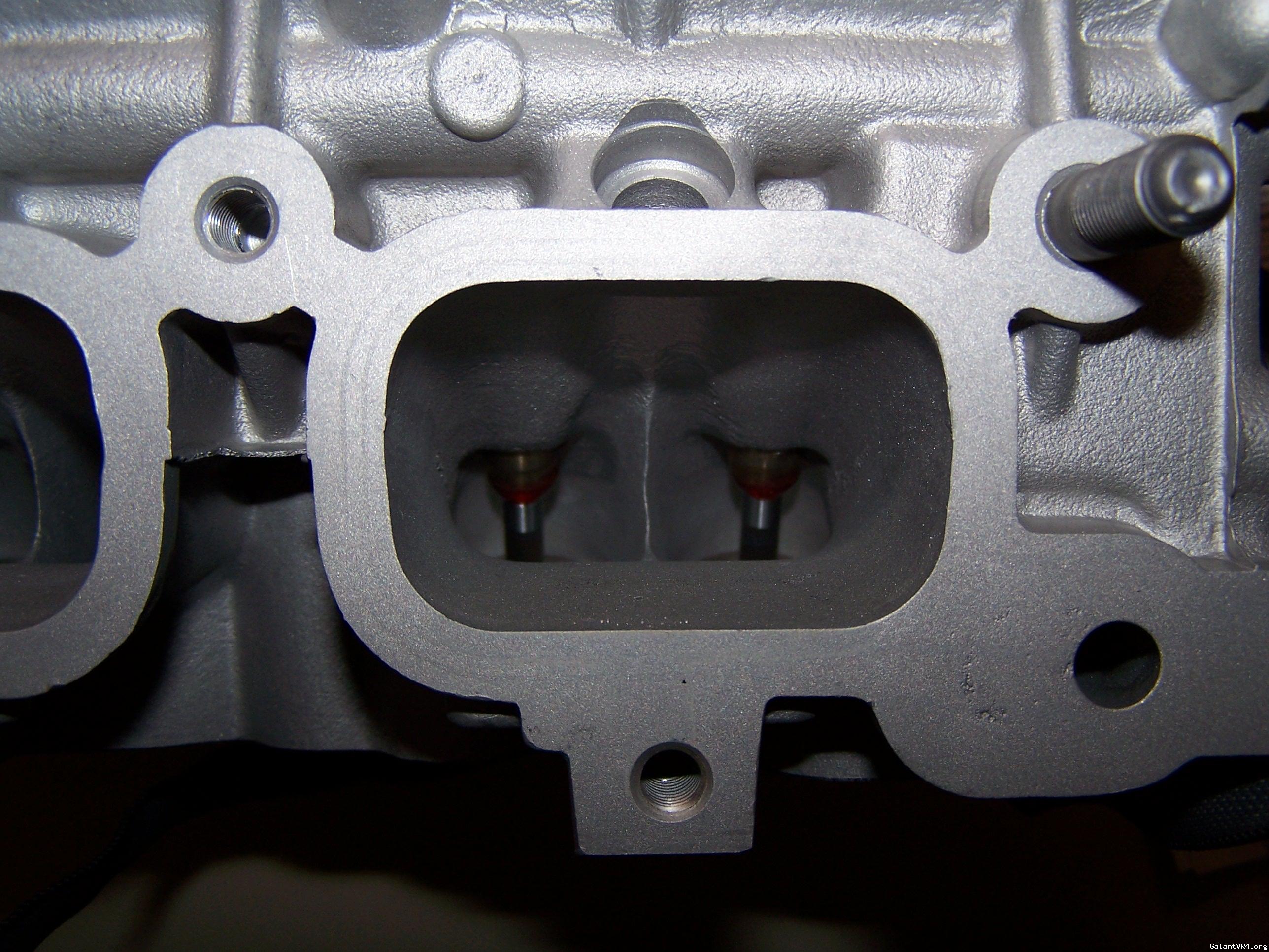

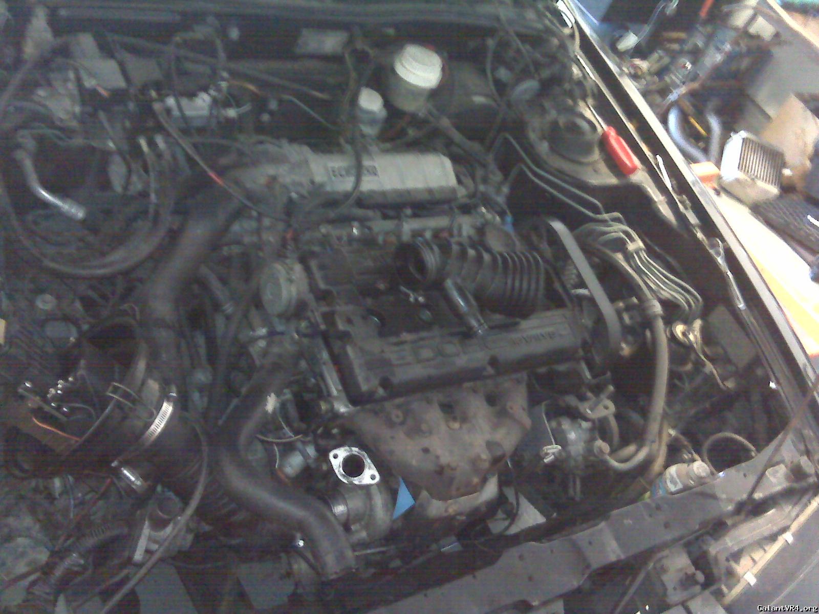

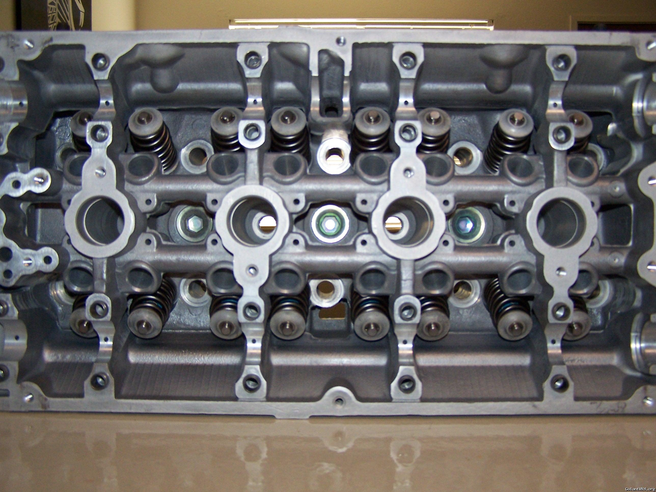

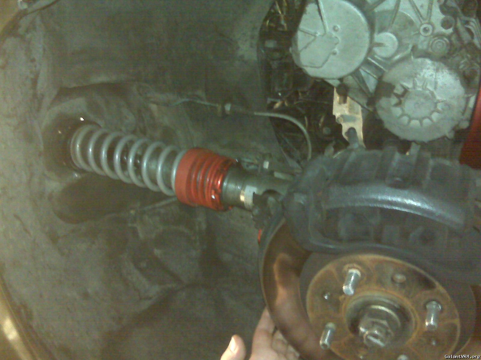

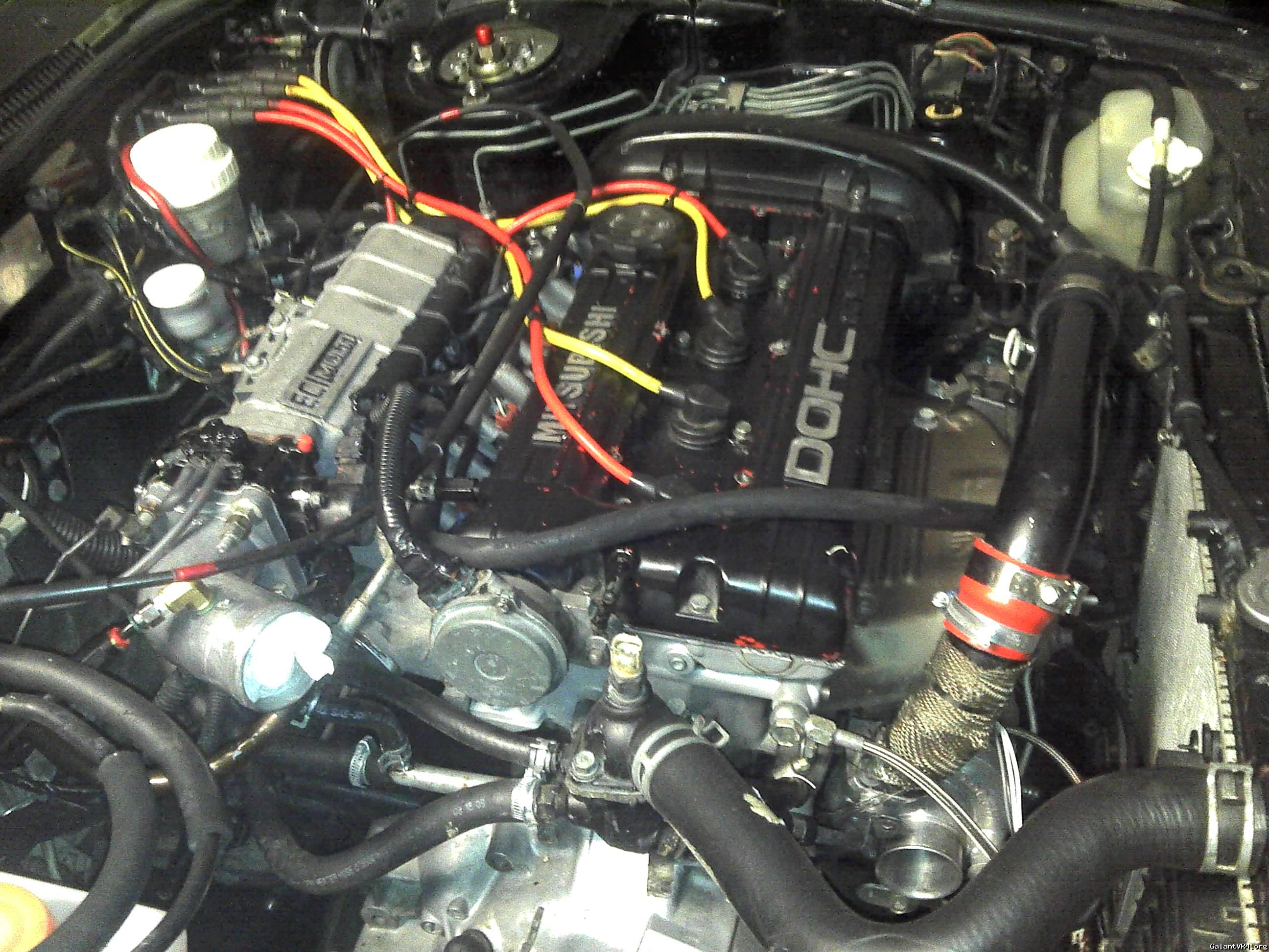

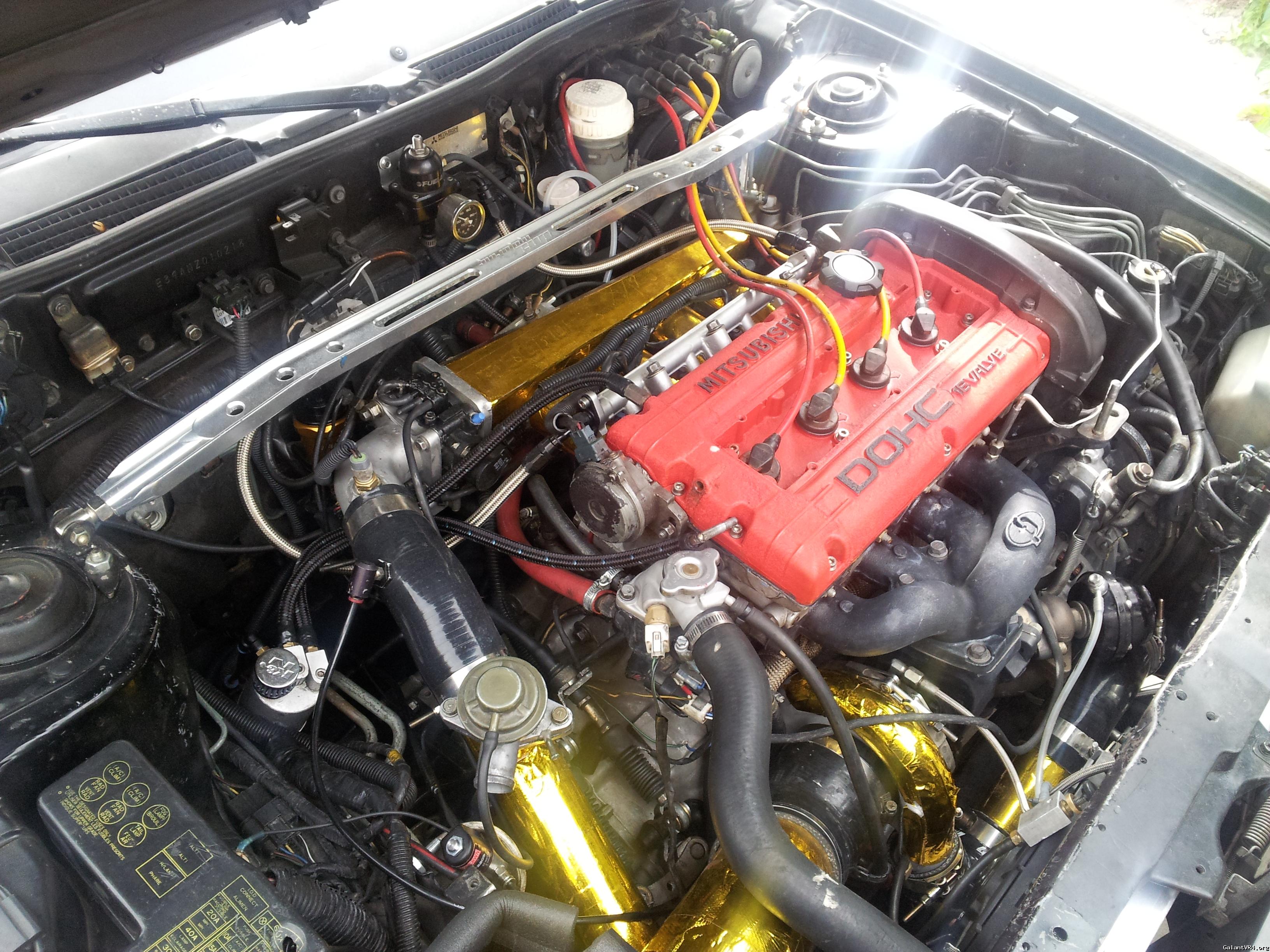

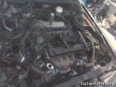

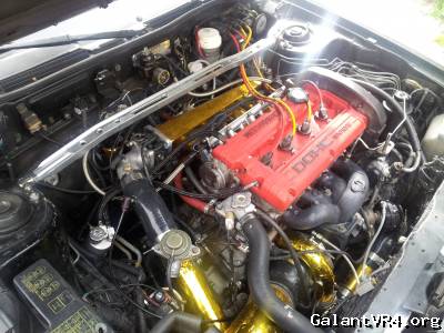

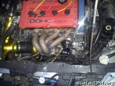

Anyways i resurrected this from a guy who was going to junk it. I paid 350 for it it was in pieces and needed tons of parts. I totally built this from a junker to a daily driving boosting 25psi with water injection. Here is a list of the mods ive done since i got it.
1992 Mitsubishi Galant vr4 #975-1000
Rebuilt transmission and clutch 7k ago

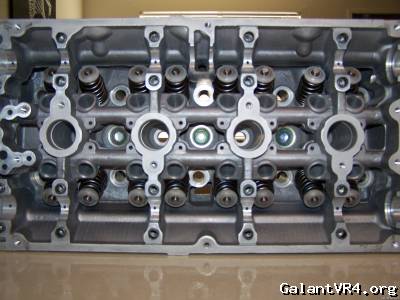

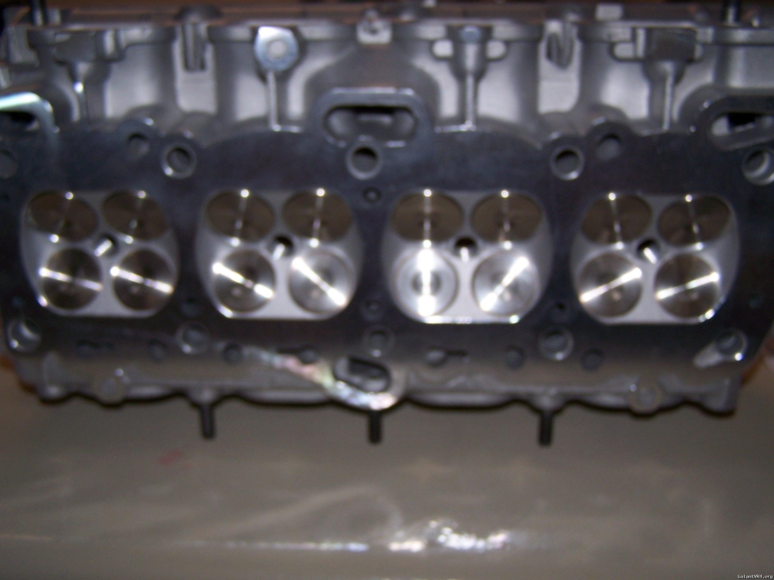

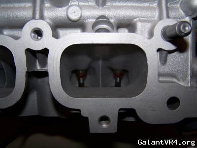

Head rebuilt at 1k ago
Odometer reads 61k miles but really has around 155k miles
Bronze valve guides
Supertech Viton Valve Seals
Hyundai 43cc head with stage 2 port
5 Angle valve job
Stainless Swirl Polished and Back cut valves
Evo 9 Beehive Valve springs
Arp head studs
OEM Multi Layer Head Gasket
Brian Crower 272 cams
Brian crower gen 2 cam gears
3G lifters
OEM Balance shaft eliminator kit
OEM water pump
Gates racing timing beilt
New timing belt pulleys
New crank pulley
Ported EVO 3 16g turbo
2G Exhaust manifold
2G o2 housing
3” turboback with 3” cat/test pipe to magnaflow muffler
Injen Recalculating smog legal intake with 1g KNN filter
Speed density setup
880cc injectors
Fuel lab fuel filter and fuel pressure regulator
255lph fuel pump
Magnus intake manifold with heat spacers
Ported 2G Throttle elbow
Coolignmist Water injection kit
Dejon Tool boost controller
1g BOV with the Stop leak mod
New throttle seals
Throttle body half shaft mod
ISC blockoff
Ebay catch can
Firewall mounted coilpack
Accel Thunder sport plug wires 2 sets
EGR block off plate
Emissions removal

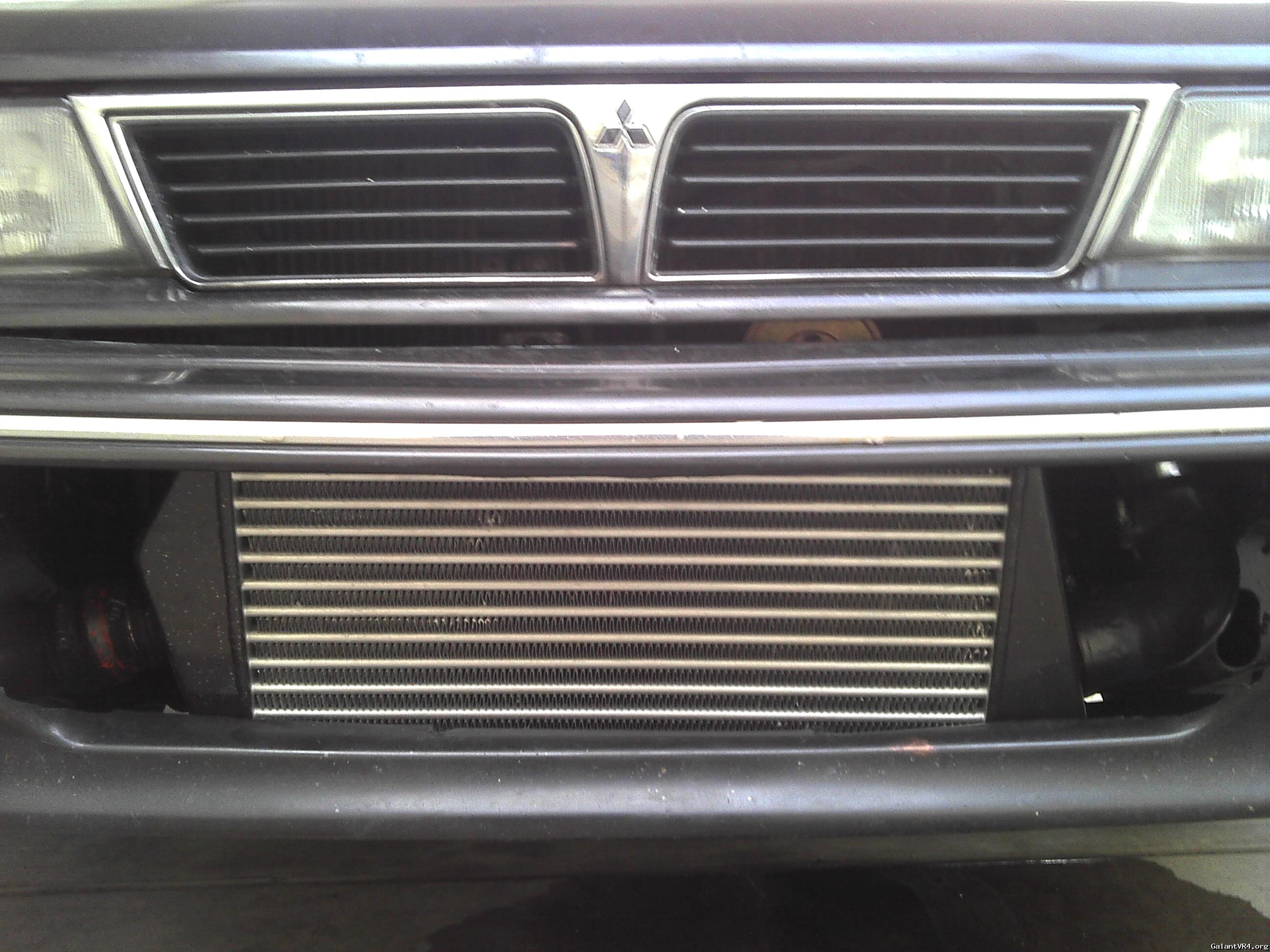

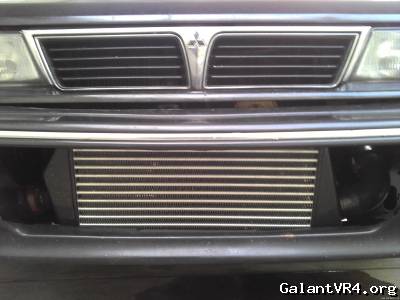

EVO 3 FMIC with 2” hot piping and 2.5 cold piping thermo wrapped
AEM UEGO wideband o2 sensor
Auto Meter Boost -30+30
DSMLink V3
DSM 1G shifter
Brass Shifter bushings
Rebuilt transmission with new OEM parts
Spec stage 2 clutch
New OEM throw out bearing
All New U Joints
New Carrier bearing
Battery relocation to trunk
Stainless feed to turbo
Hot Bits Rally Gravel-Spec Coilovers
Stainless braided brake lines around
Stainless braided Clutch line
Ceramic Pads around
Mishimoto 1g aluminum radiator with 2x spal fans
