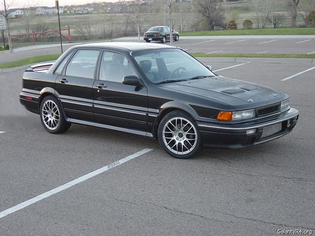

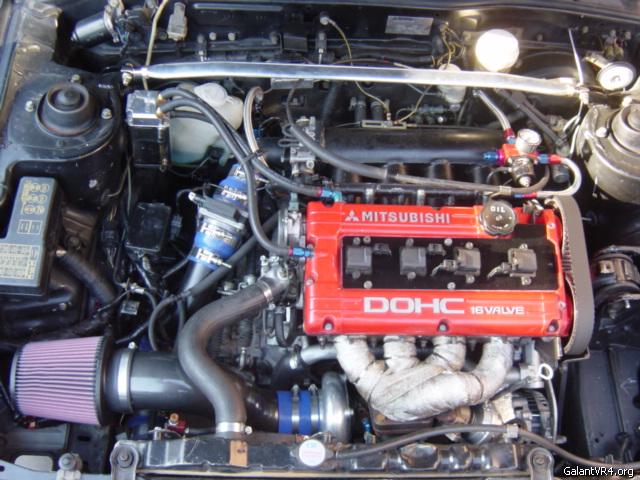

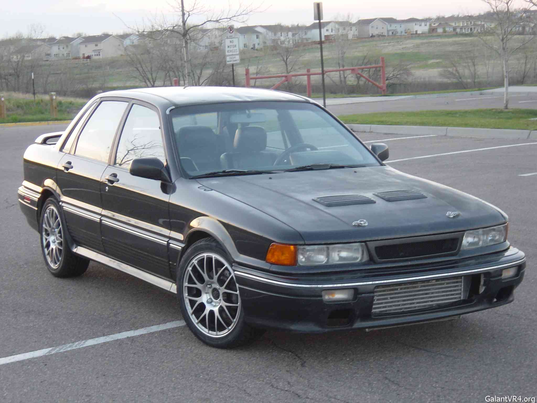

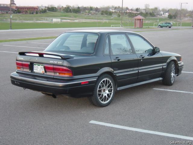

I finally cleaned her up and decided to post a few pics, and mod list.
Engine
Hyundai Sonata GC4S 2.4L 6 bolt
Eagle Rods
9.25:1 Ross Pistons
Bored .020 Over
Fully balanced And Blue Printed Crank
No Oil Squirters
No Balance Shafts
Modified Main Bearing
ARP Hardware Thought Out Entire Block
Buschur Racing Stage 3 Head, O-ringed, Dual Valve Springs, Ti Keepers And Retainers
HKS 272 Cams
AEM Adjustable Cam Gears
Cometic Metal Head Gasket
Jon's Performance Intake Manifold
Turbo/Exhuast
Custom T66
Custom 1/8" Wall Tubular Manifold
Tial 35mm Wastegate
Custom 3in Downpipe
Tial BOV
2.5in IC Piping
Drive Train
ACT 2600
Lightened Stock Flywheel
Fuel
twin fuel pumpsetup
255lph walbro
stock evo 8 fuel pump
GM translator
Safc
Footwork
Wheel Max 17in Wheels
Vredestein Z Rated Tires
Power Spot Cross Drilled Rotors
Axxis Pads
Evo VIII Springs
Exterior
AMG Amber Corners
AMG Grille
evo III hood vents
Interior
89 glovebox
89 underdash panel
manual seatbelts
roll up windows
trunk mounted battary
