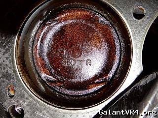

I have an imported JDM block I bought a while ago that came with the big 16g turbo so always assumed it was from an RS model.
The CR is the same as 7.8:1 from the compression test, but the pistons have a designation I am unfamiliar with. Does the R mean anything special?
Thanks in advance.

this is probably one thing I don't know haha. Have never seen the TR pistons before. The crown looks the same as the regular T pistons. I'm thinking they are replacement OEM pistons in oversize.
Generally from what I have found -
T = turbo
D = DOHC
M - MIVEC or High compression N/A
L - Low compression N/A

Thanks for the link. I thought that most of the comments seemed to be rather loose opinions with the exception of the person that said they inspected it and saw a wrist pin difference.
Fuel, good info on the evolution/RS terminology, thanks. The engine came with the yellow top 510 injectors as well as the dual runner intake. I measured the bore at the top of the cylinder and it appears to be a standard bore, not oversized. I have a person interested in purchasing the block from me and they want to know the internals. They may come over this Saturday we might pull the piston to do a better inspection. I will post in the Info archive if we pull it and I see anything interesting.

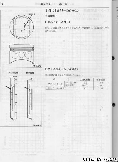

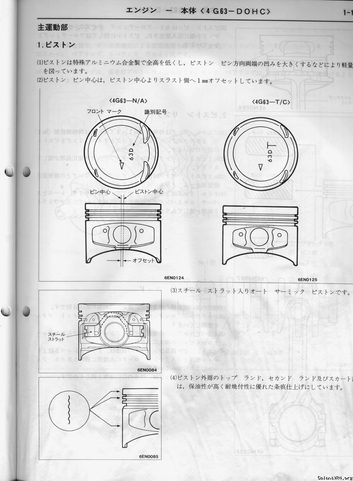

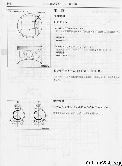

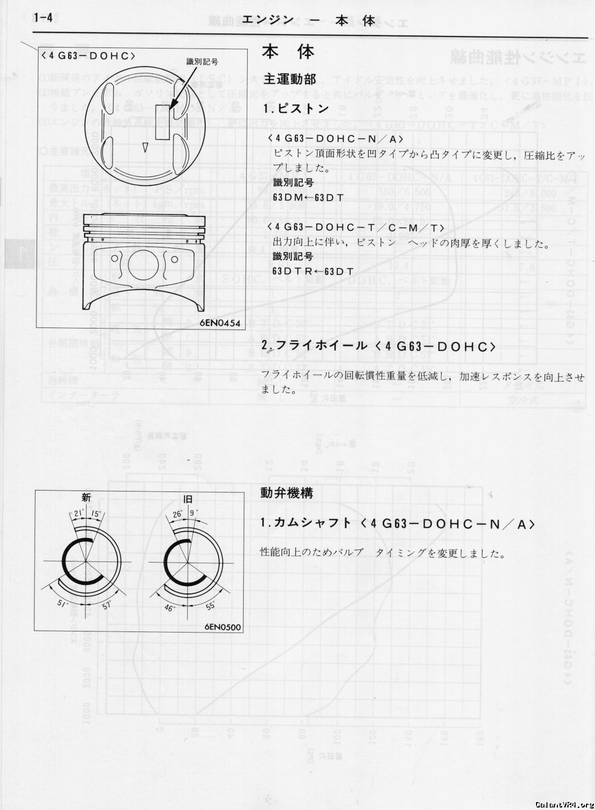

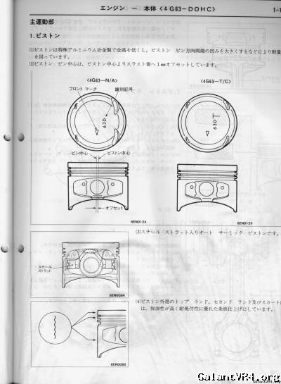

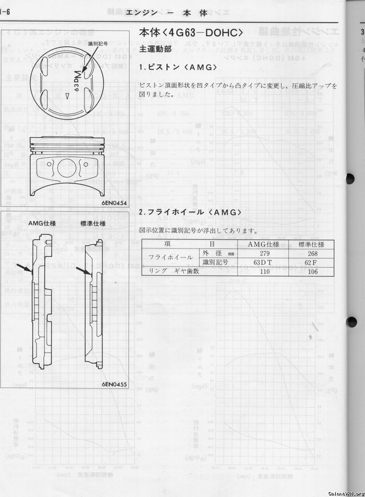

Hi Had a look in the tech manuals:
87.10:
Lists 7.8:1 CR for T/C and 9.0:1 for DOHC N/A
89.10:
Lists 7.8:1 CR for T/C (both MT and At), 9.0:1 for DOHC N/A and 10.4:1 for the AMG
90.10
Looks like was a die change. Can't see if the P/N rolled as the original parts book was not released with a P/N for the pistons
Lists 7.8:1 CR for T/C (both MT doesn't mention AT), 10.4:1 for all DOHC N/A
Does this solve the mystery?
Rich
fuel
Feb 23, 2009
2,166
Toronto, ON, Canada
yeah I'm wondering if R denotes the change in piston ring groove depth - I know that the DOHC engines of that era changed from a deeper groove to a shallower groove.
