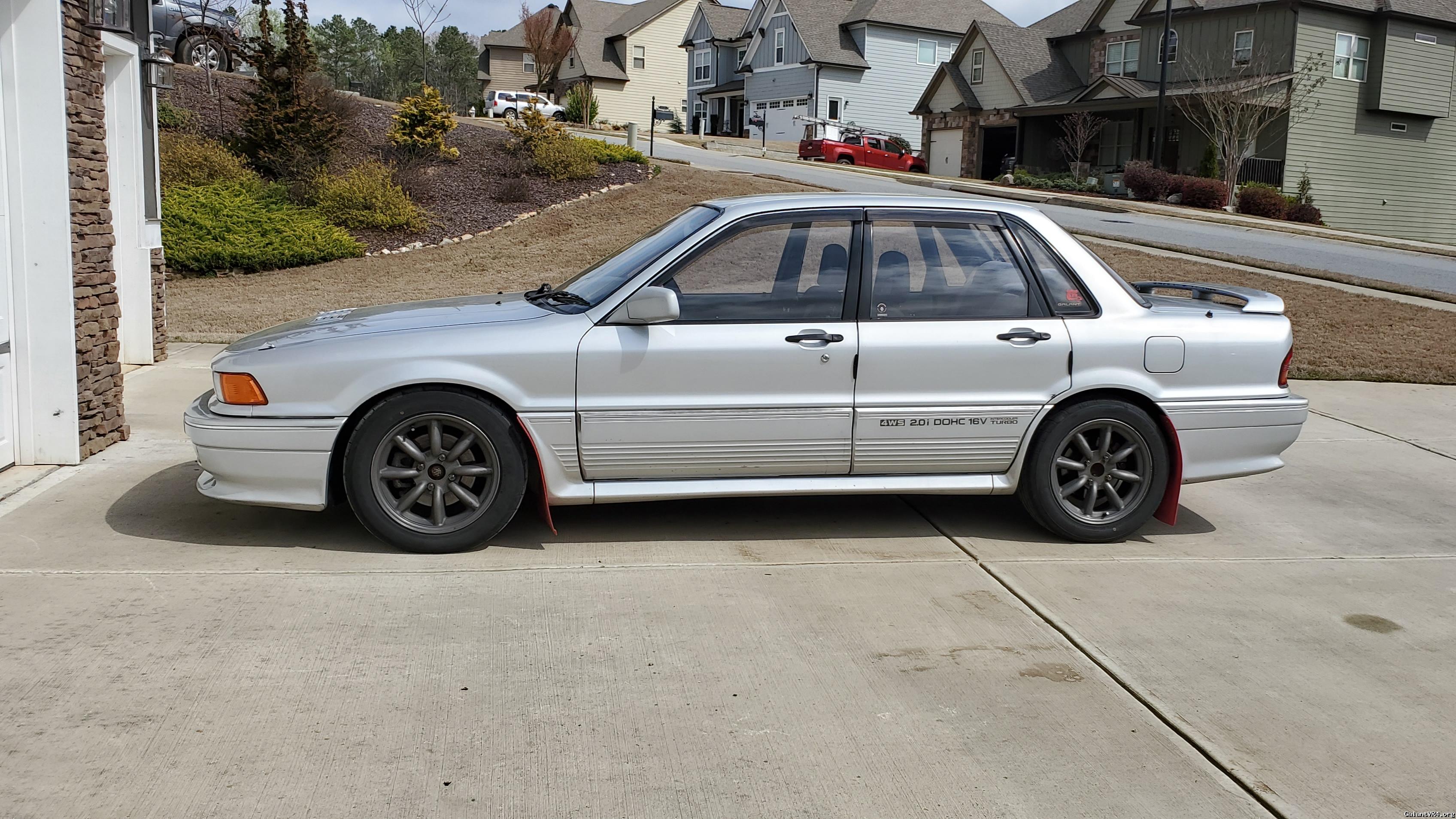

Looking for information on whether or not there is a USDM master cylinder that I can swap into a 90' RHD VR4 without remaking or rebending the factory lines. Seeing as they are located in opposite sides of the car I'm not sure if it will be possible or not. If not, does anyone know of a rebuild kit for these? Been having trouble sourcing one stateside.
