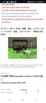

Hey all. Below is a link to an EBAY ad for a JDM climate control switch. I think this would be awesome in the car. I can make it fir, my question is has anyone done this and does anyone know if it will work on our cars.

I believe you have to have some sensors as well as a few other things. I'm sure some of the overseas guys will chime in.

For that price I would rip a much better looking one from a stealth/3000gt and do a custom install. Curtis is right, without the matching electronic motors and wiring/sensors the unit itself is kinda worthless. Maybe someone could get them to remove all of it since they have the entire car.
