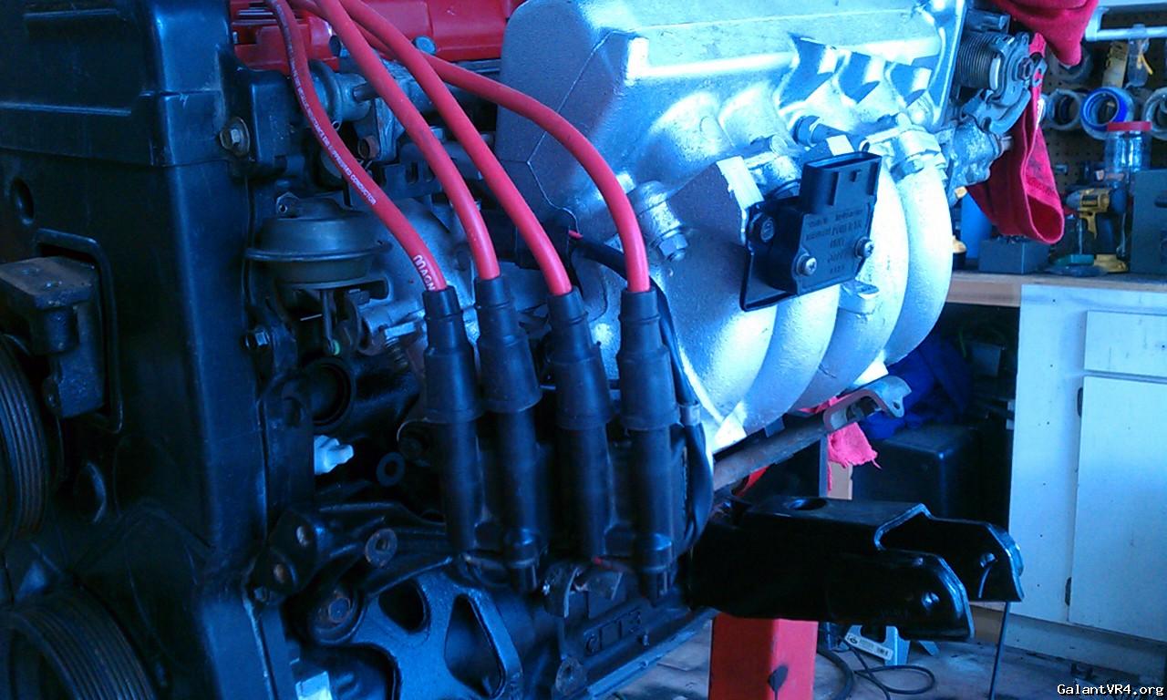

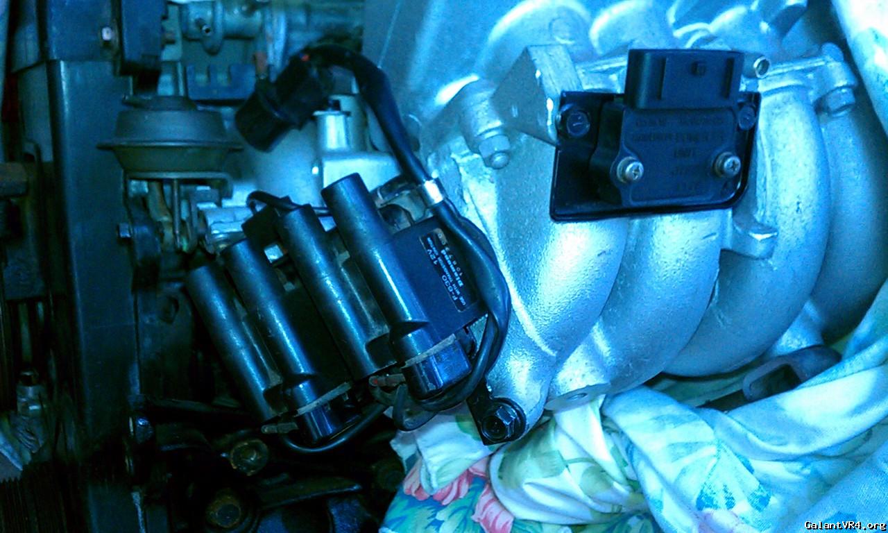

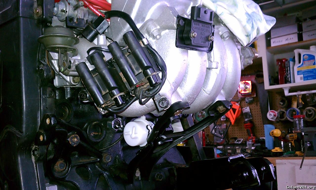

Hi everyone, I've been making some brackets for the Cyclone intake manifold. After a triple take look at the coil pack, I'm thinking it might be too low and interfere with the AC. Can you guys determine this from these pics? Thanks in advance for your help.
tektic
Dec 19, 2012
1,497
ronkonkoma, ny

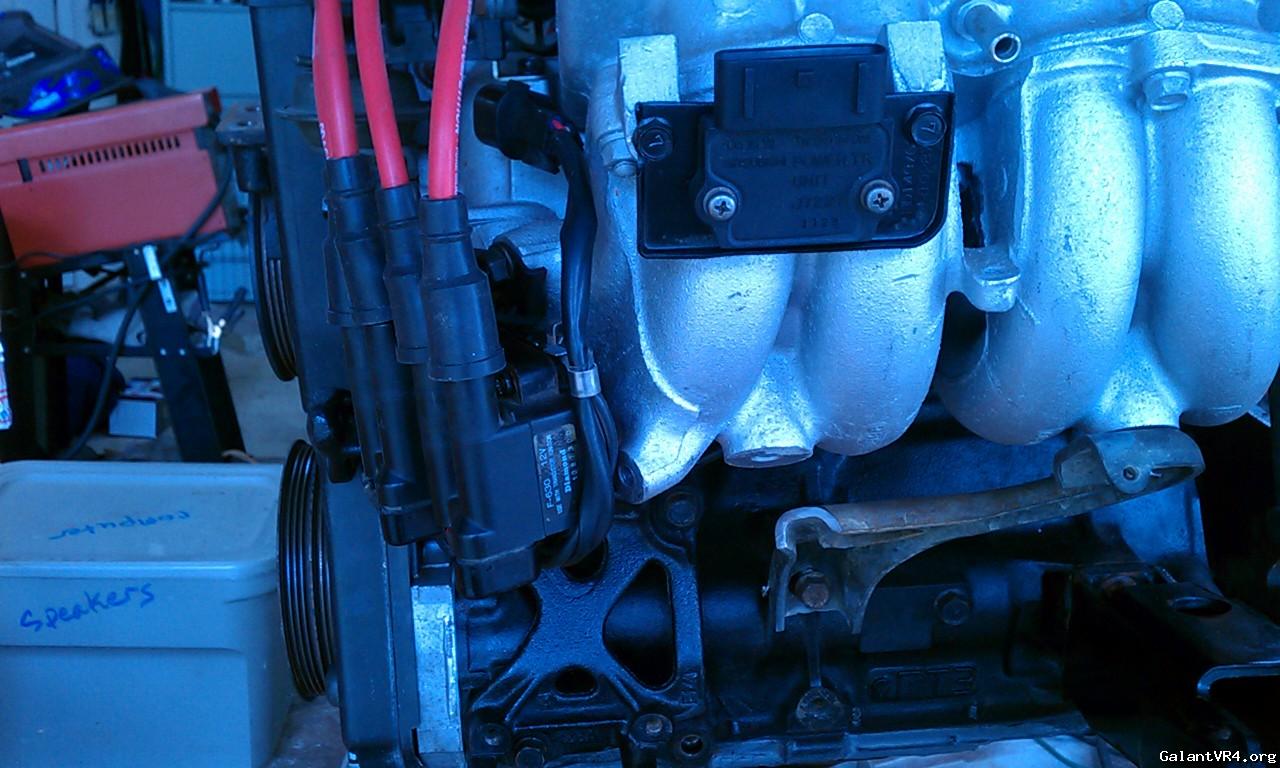

Looks like it wil likely hit the ac. You can look at my build thread to see mine. I had to cut the support bracket to clear the ac also.

Thank you! Your build thread is the one that alerted me to this potential problem, thank you for posting that. I noticed that yours are angled in the direction of the wires. Did you use all 3 bolt holes, or only 2?

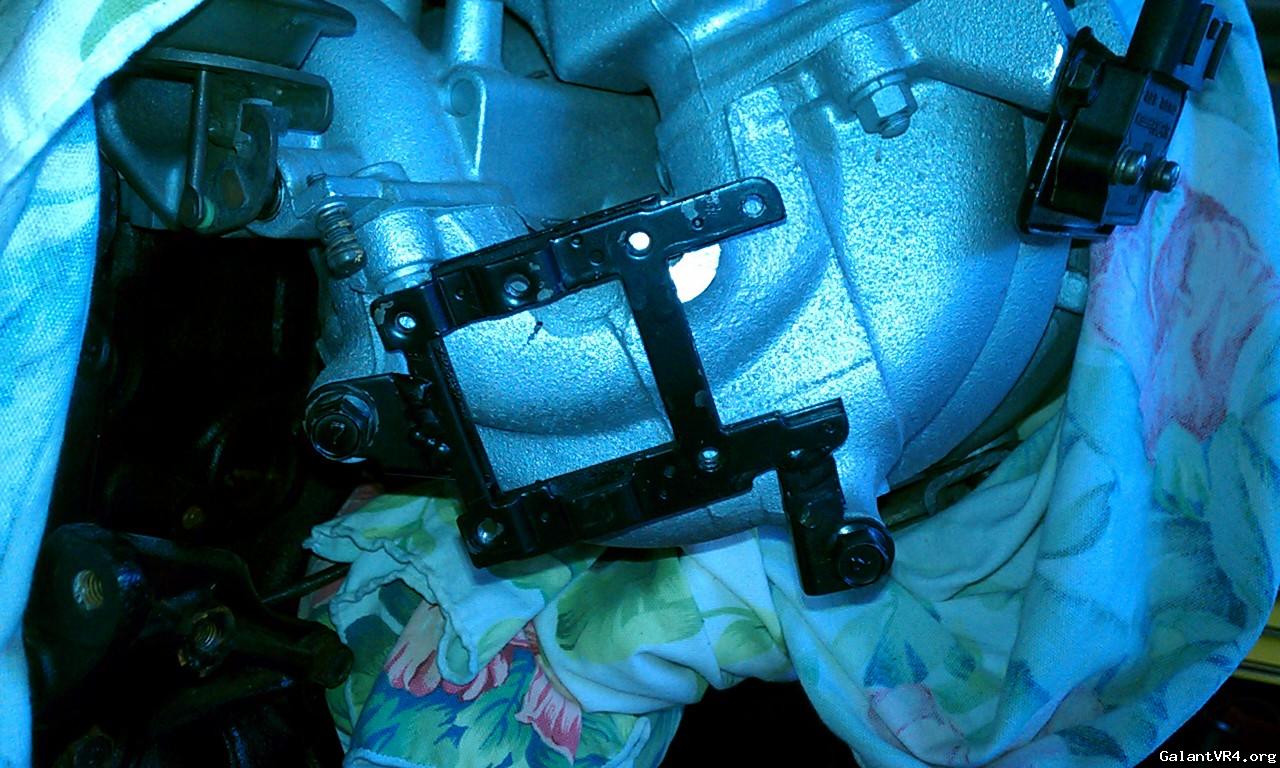

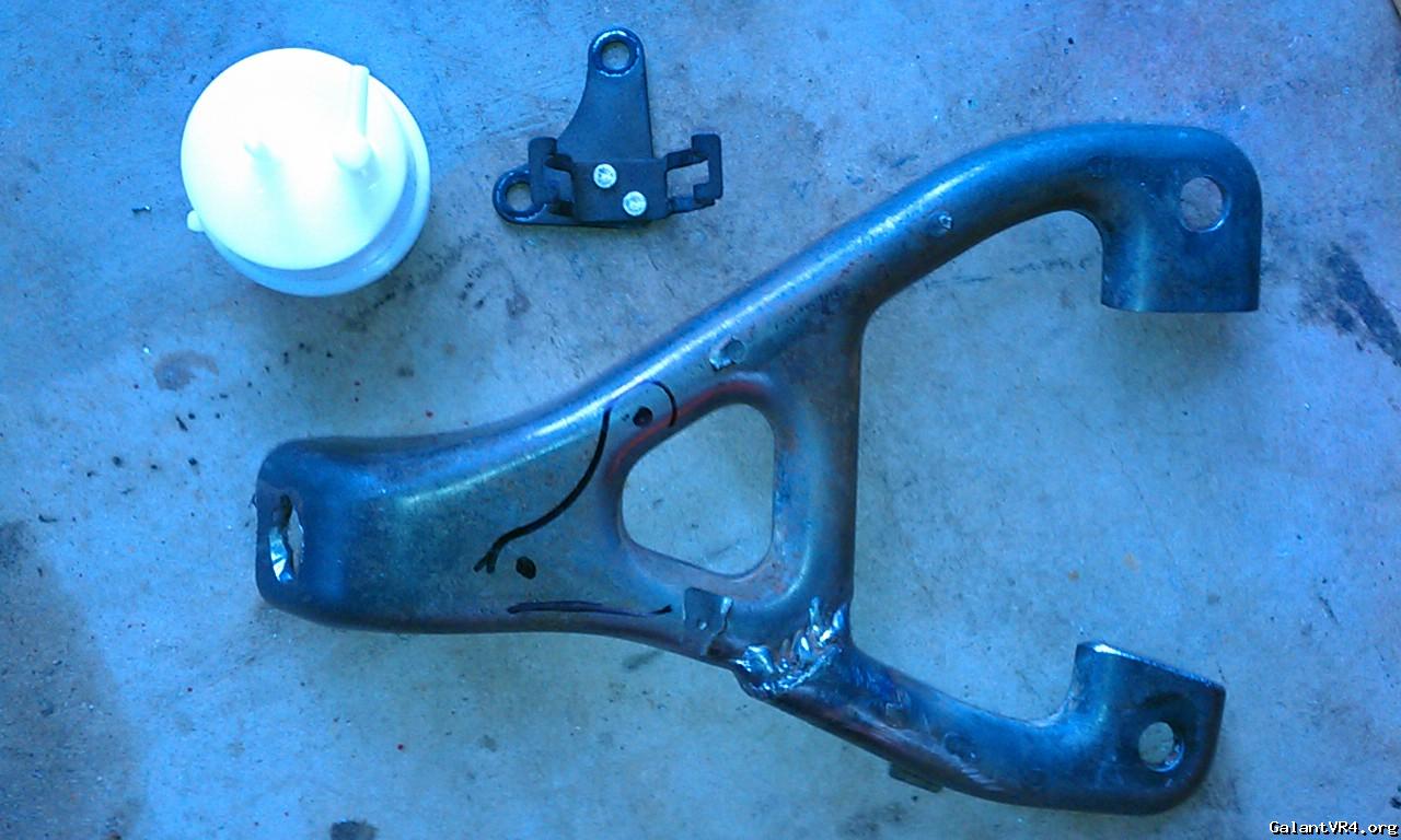

How come the brace is cut on the driver side, for the second support point on the manifold?
Possible to weld back in some of that bracket?
matt92vr4
Oct 3, 2010
676
Venice, FL
Thanks for the pic. I should have stated that I'm modifying all of the USA brackets to work on the Cyclone. I didn't have any flat metal scrap so I'm cutting up a few old Mitsu brackets etc.

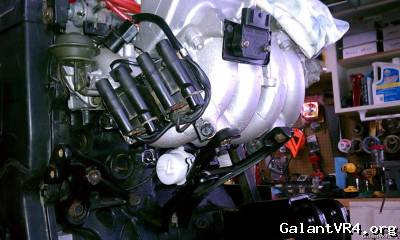

I just raised the coil pack bracket about an inch and angled it up in the back so the coils are pointing a little toward the spark plugs (like tekics). I think it will work now.
You caught me in the middle of modifying the USA main support bracket /ubbthreads/images/graemlins/smile.gif. I was doing that when I noticed the coil packs were sitting too low. I cut the drivers side portion off so i can relocate it over a little. I'm headed out to weld it back together and add a vacuum can holder.

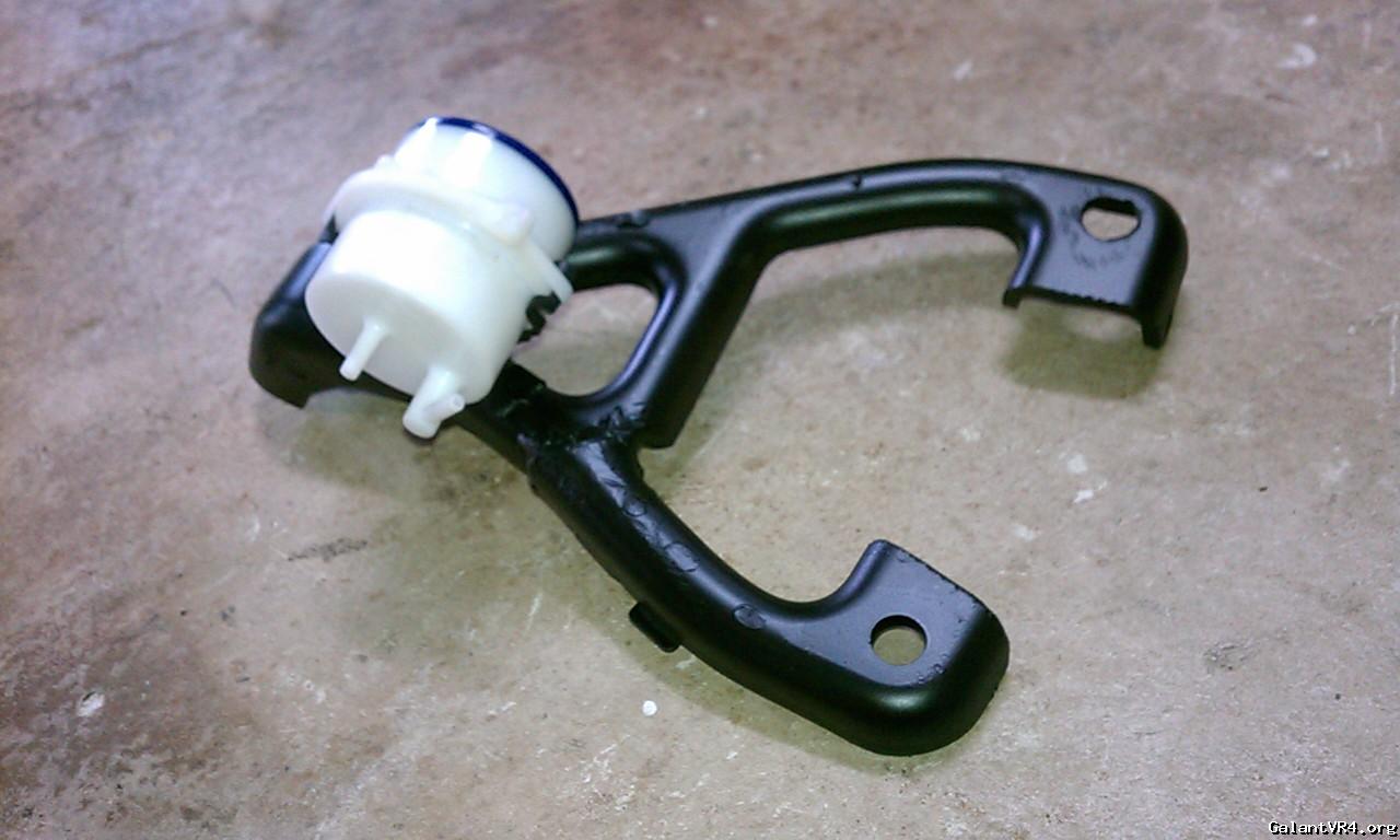

Brackets are painted and drying, thanks for your help. I'll post pics when they dry.

Quoting matt92vr4:
Some of the brackets serve extra functions besides just holding the item. They can be heat sinks, or grounds. Painting over the bracket can mess up both of those functions.

Update in case anyone is using this as a guide. Boy I hope the Cyclone manifold is worth it! Today I dropped the engine in. The main support bracket hit the AC compressor. I had to shave off a little from that side. Also, the PTU bracket is OK but it cannot be removed without loosening all 3 AC compressor bolts and sliding it back 1/2" or so.
I had fun making these things, but honestly with the amount of time spent it would have been better to buy the Cyclone brackets. Next time a coil pack goes bad I'll wish I did for sure.
