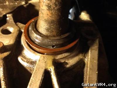

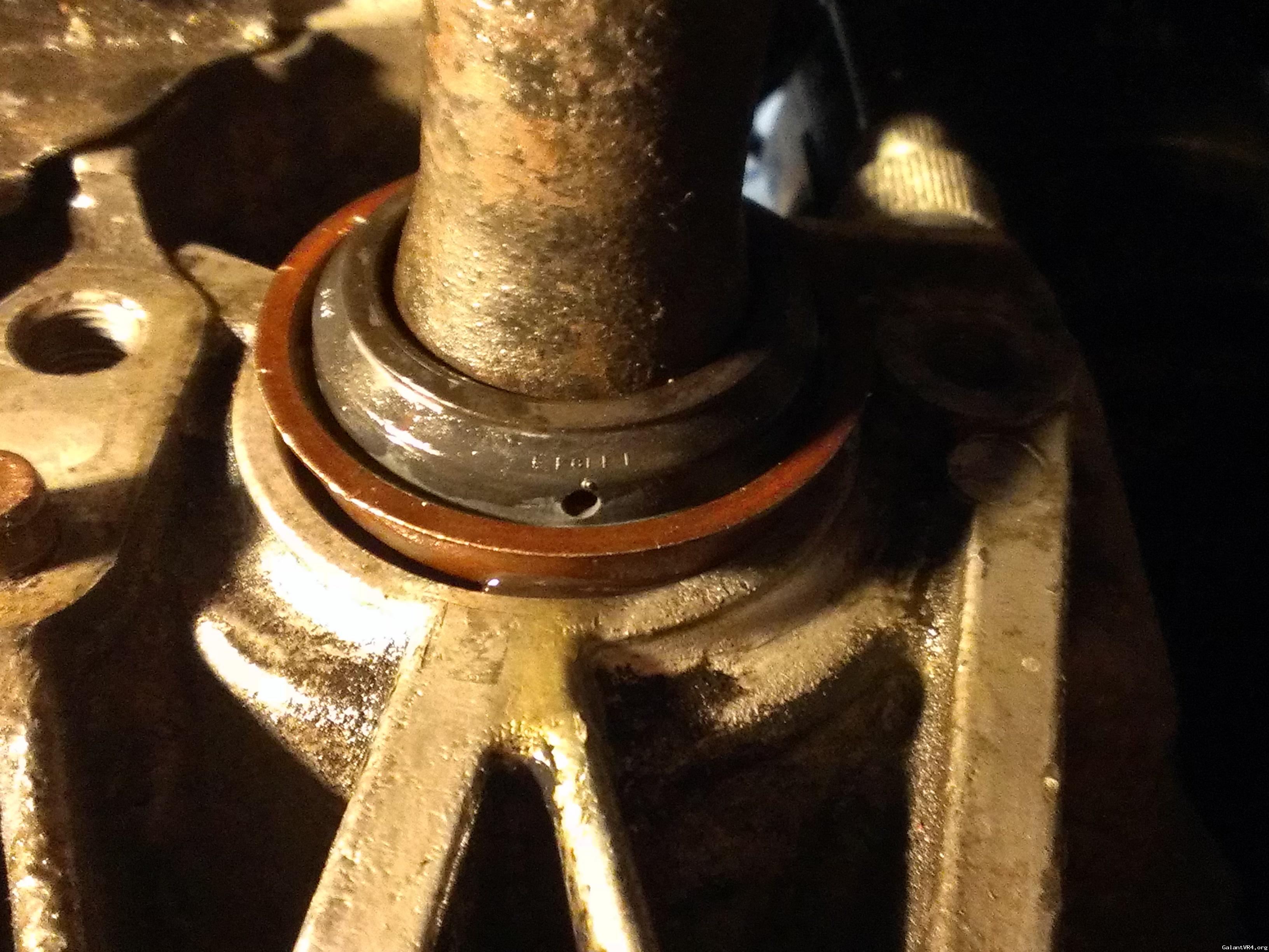

I am trying to fix a leak in drivers axle seal first seal failed after 1000 miles. On a hunch I placed the new seal on the shaft bolted the axle to the block. The seal is about a mm off from aligning with the hole.
What can I do to remedy this major inconvenience?

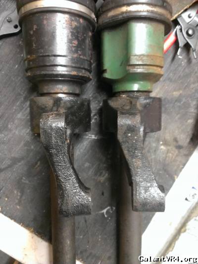

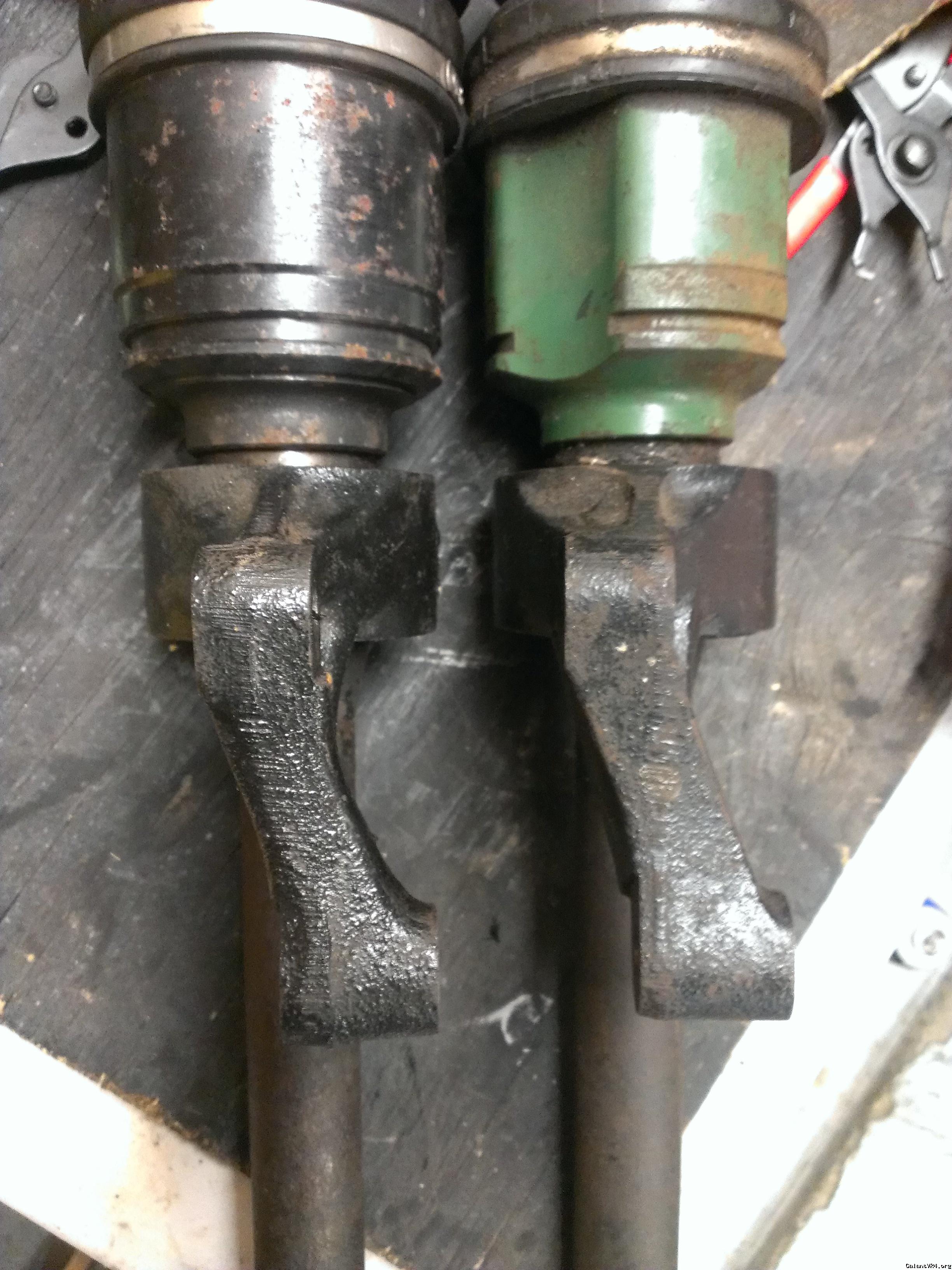

I figured it out. The bracket that holds the axle to the block is incorrect. I tried to use the bracket from my automatic trans. The axle is the same but the bracket that bolts to the carrier bearing is different.
The green one is the manual and the black one is the auto. You can see that the one on the right is slightly offset.
X04 317 printed on black , j30 3901 on the green.
Now how do I swap them? I guess I'm going to look up carrier bearins and try to swap to the other axle.

The axle and the dead shaft come apart. Just hold it up and down with one hand by the dead shaft and hammer down on the axle with a deadblow or 5 lb sledge and it will pop right off.
3,473
When I replaced the bearing in mine, I used a press to get it apart. You have the correct spacer for the offset part of the bracket, right?

thanks for the tip. I swaped the shafts and everything lines up nice.
I still have the air conditioner. No need for spacer.
Lastly what is the length of the thread on the bolts? The grade 10s I'm using are a little short but obviously stronger. Will get some grade 8s at about 45mm tomorrow. I think that will do the trick.
Resolved!
