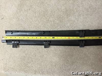

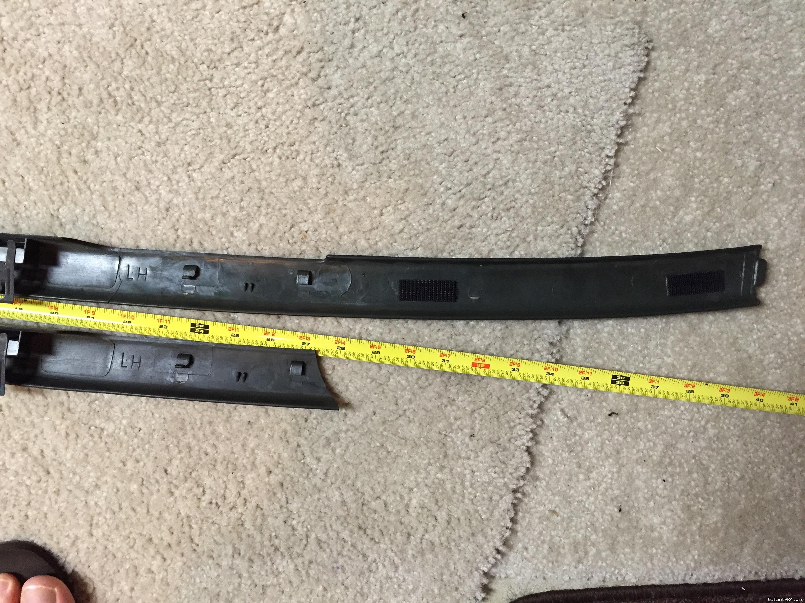

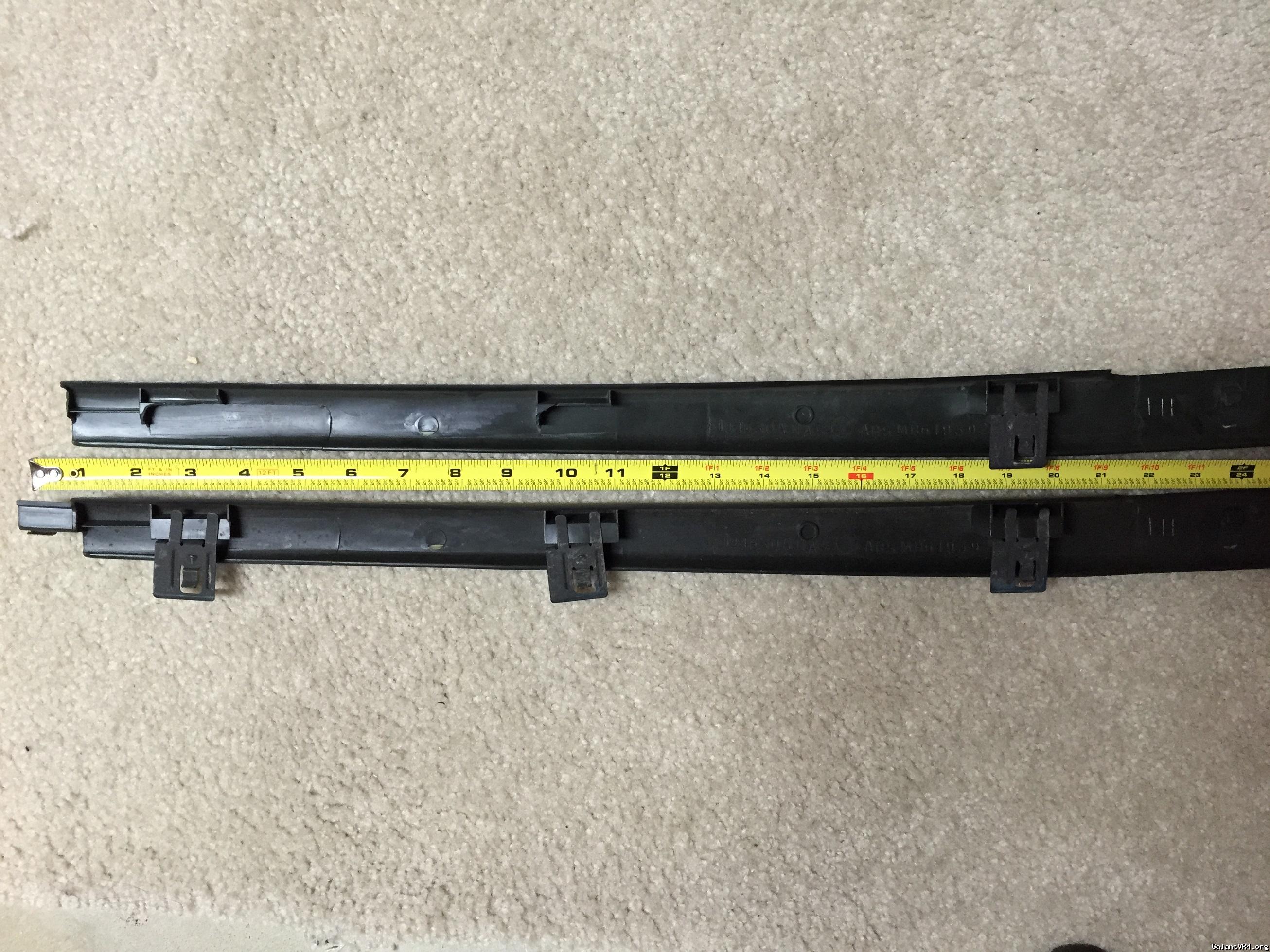

Just went downstairs and pulled mine off the shelf and set them against a tape. I didn't have pics when I tried to pull these off...notice they're both broken /ubbthreads/images/graemlins/frown.gif Anyway, if you zoom you can see where/how they're connected, which may help you develop a safe method. Notice the back is held with metal slip-on clips, and the fronts have pads with tiny opposing mushrooms that lock into each other when pressed together. If you can first separate the lock pads in the front maybe you can then get the trim off the metal clips by moving it downward. Looking inside the car, the other end of the clips attach to the sunroof panel. Also think it would go better if you removed the pillar panels first.
EDIT: These pictures show the panels upside down.

Those pics are exactly what I needed!! Thank you! Took me a minute to figure out the orientation of the photos/parts. Overall that gives me a good idea on where to pry. Some pics of the entire backsides of the panels would also be very helpful as well.. if you have the time, no worries if not.

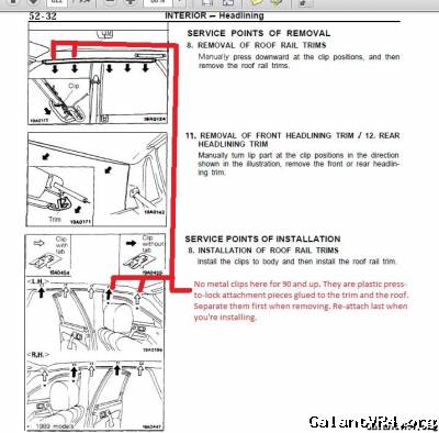

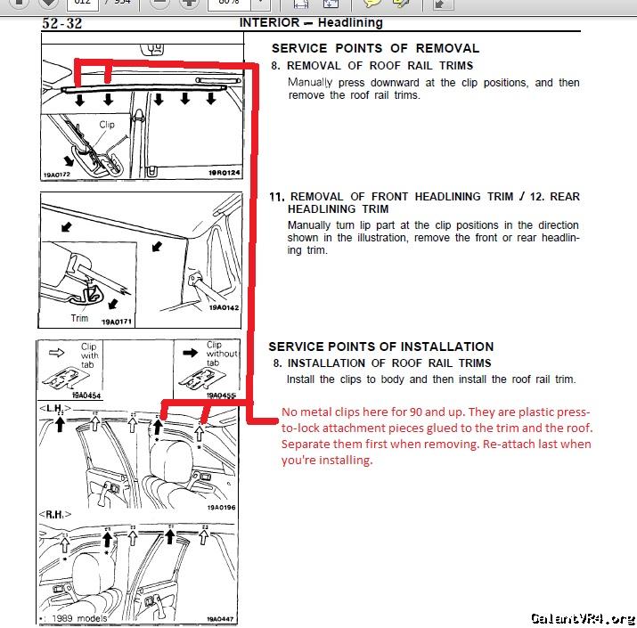

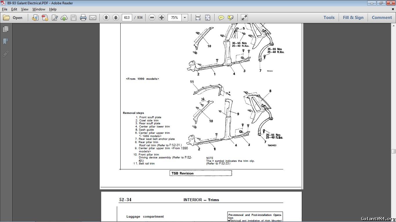

The pictures are of the backs of TWO driver's side pieces. (Yes, I broke two /ubbthreads/images/graemlins/blush.gif) Put the bottom picture next to the top one, overlay them a few inches and you'll have the whole piece with dimensions. Bottom one shown is missing the front half. Front of car is to the right. I don't have the other parts removed. But found a couple of pages in the manual that may be useful. Notice comments in red.
