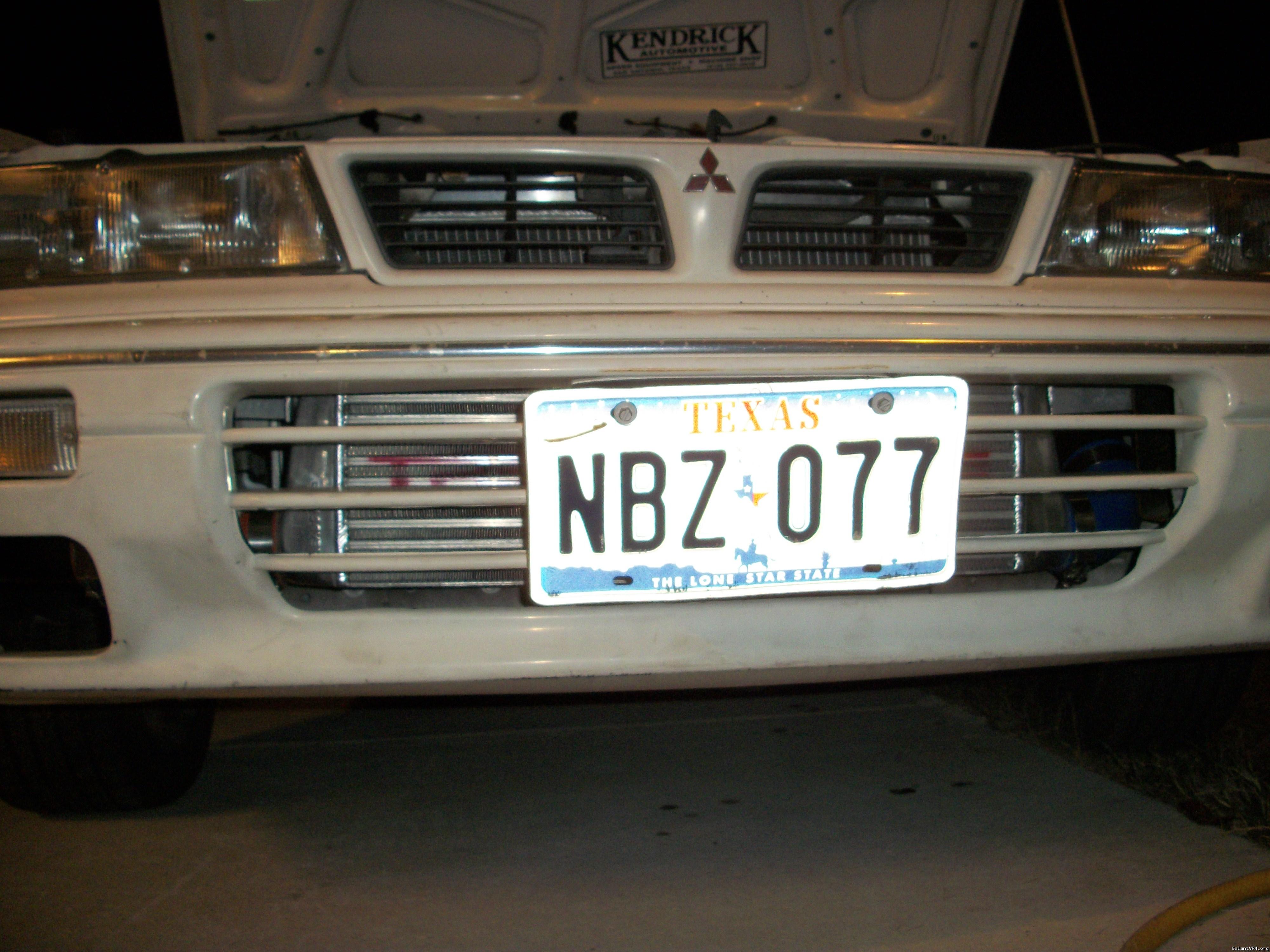

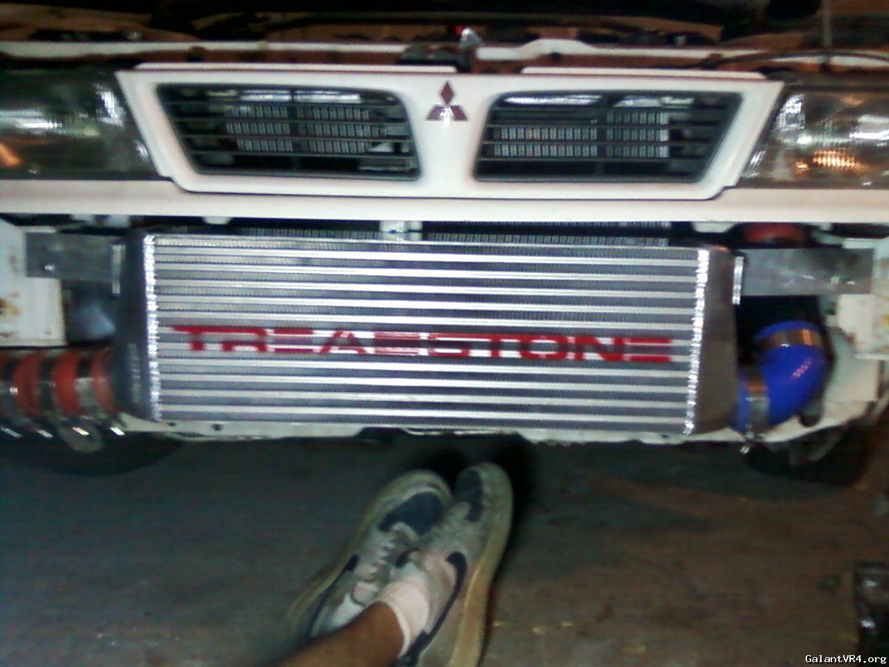

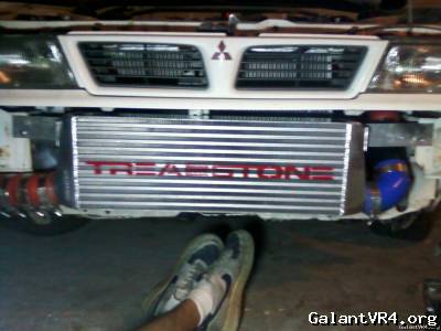

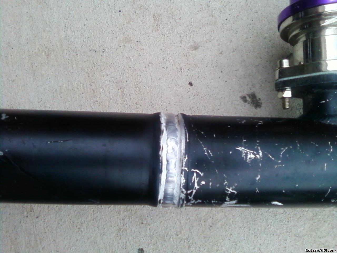

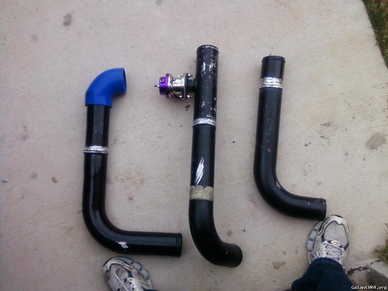

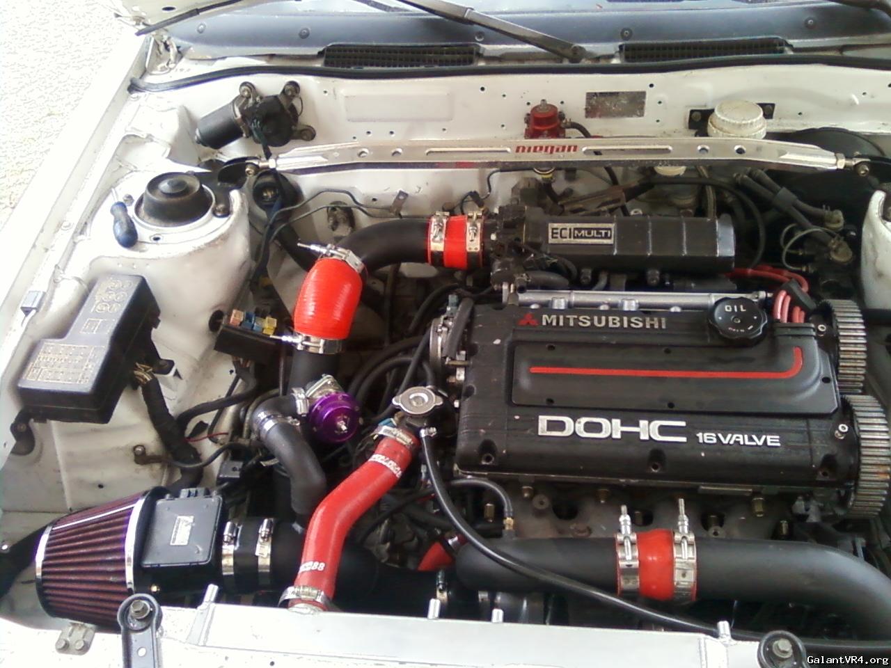

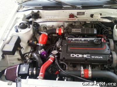

You'd be suprised how thick and durable the Ebay pipe kits are. I do not recommend their cores at all, but the pipes are truly nice. Here are some pics of my set up. ebay pipes, treadstone core:
From the engine bay:
Before welding from the front:
After welding, before paint...
Behind the bumper, before modding the bumper and moving the plates:

That engine bay looks sick /ubbthreads/images/graemlins/applause.gif what color is that on the valve covers and intake mainfold ?? I think it would look nice with some gun metal Black allen bolts for the valve cover

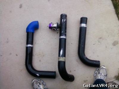

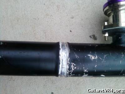

I have a tig welder but can't weld yet. Fortunately my roommate can. I just redid my piping. The cxracing.com piping is what I use. I have it in my 3000gt too and my roommate used it in his Evo. It's actually 2mm thick which is pretty good. It welds easy too.
I used 90 degree couplers on each side of my front mount to route it the shortest route possible, and to free up the space where my foglights will eventually go. I had to grind away some of the body metal in the opening similar to what a lot of the 2g dsm people do. I painted everything dupli color caliper black afterwards. The pipe comes up between my civic radiator and the side of the frame.
Every pipe is an L shaped pipe. Same with my 3000gt vr4.
You can see my setup in my build thread (1517 build thread (sort of)) in the general discussion section. It is a mess of couplers right now, as i still to get my buddy to weld it all up, but it is all an aluminum ebay pipe kit.
