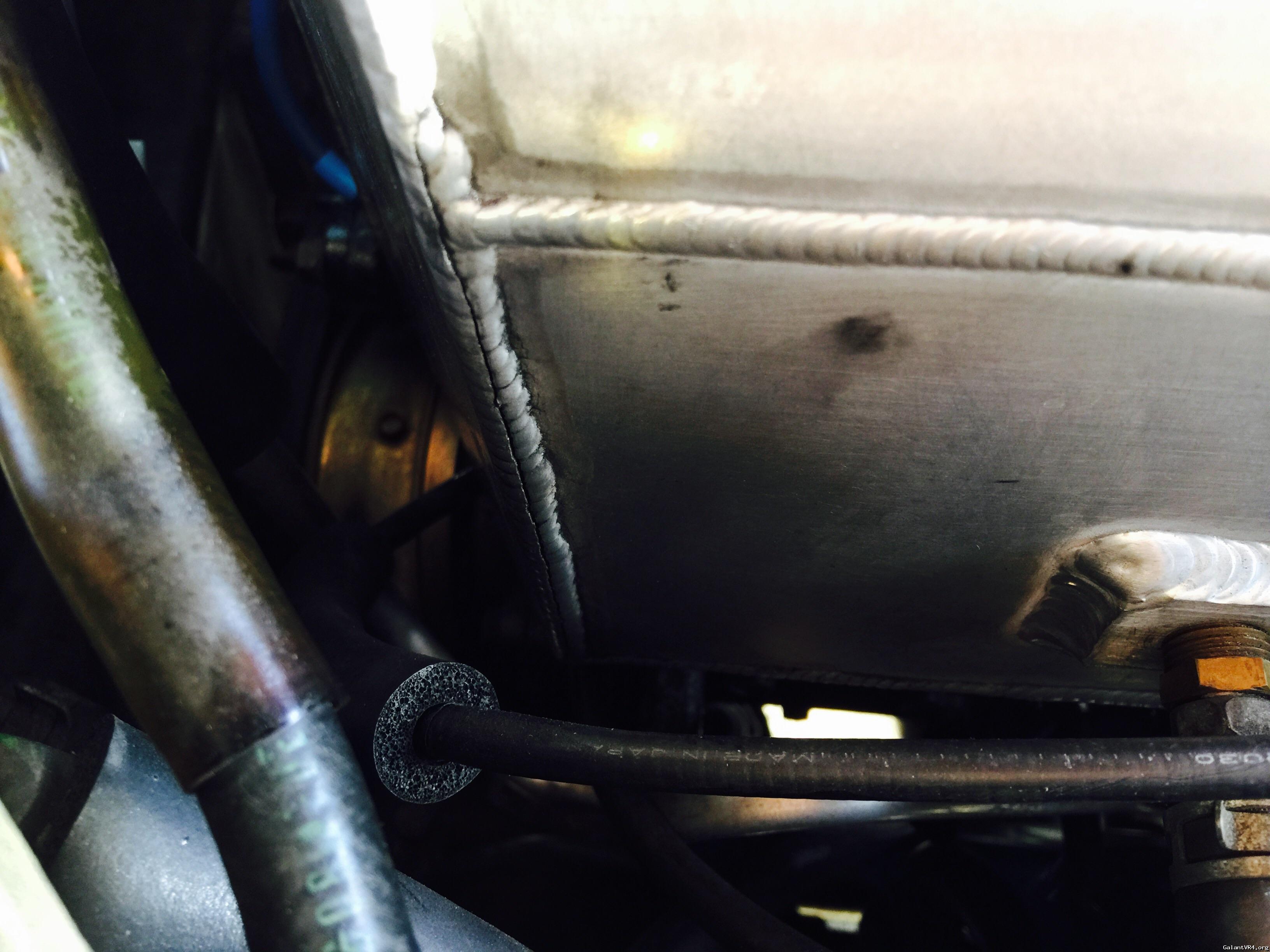

Well, today after taking advantage of Labor Day I did a thorough inspection on the ignition components when I came across a pretty long crack on the driver side portion of my smim. I'm going to contact the fabricator to see if they'll repair it let a alone warranty it. I'm happy that I found the problem but not so happy at what the problem is.
I'm curious though, what would cause the manifold to crack? Besides the obvious, too much heat/boost? I don't think the design is questionable /ubbthreads/images/graemlins/dunno.gif

Knowing where the crack is would help with the guesses, but my first thought was that it was fabricated out of specification and when mounted and bolted in, a slight variance in the shape caused stress that ultimately failed.
10,992
Looks like the split is right down the weld. Is that correct? That indicates a no good weld if so. The parent metal should split or fail first. Seems like a lot of thermal stress is a possibility.

Yes Dave, that is correct. The split is right down the weld. I understand what effinix is saying however I'd prefer to look a little deeper into the issue. Thermal stress is a strong possibility and was what I was thinking but how?

This was a common issue with the Magnus sheet metal intake manifolds. They would split right down the welds just like that.

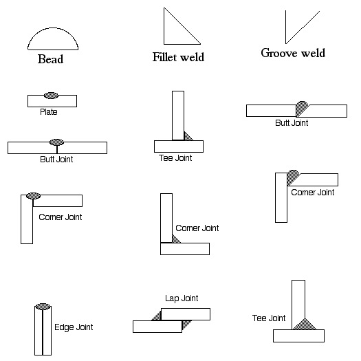

We have seen this happen a lot of different things. We has a 1g in here with a intercooler with sheet metal end tanks that blew. Kind of the nature of the beast. Welding does stress the material and depending on the gage metal that is used (.125) is most common the material will still tend to flex and with heat and other factors the weld is typically the weak point. Don't get me wrong if its welded correctly it will work just fine. Thus why I will go to cast or billet because you have much better structure and fewer welds.
The other thing to consider is the type of weld when doing this. Most companies will just bead weld. Were a grove weld is a lot stronger weld because you are "grabbing" onto more surface area of the 2 plates.
I would suggest that you grind a v-groove in the joint there and re-weld it and it will probably hold up just fine. Just make sure the 2 surfaces are clean. Aluminum is not very forgiving when it come to contamination.

^^ My sheet metal IC tank welds split a couple times due to slightly expanding every time under boost.

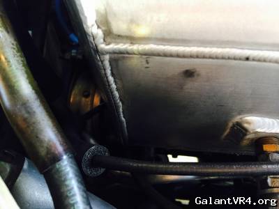

Quoting strokin4dr:
Is this a Magnus by chance?
Yup. Here was mine when I got it:
