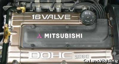

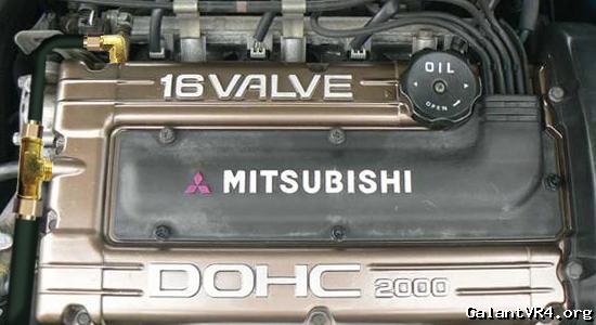

I'm trying to clean up the hoses under my hood.
If I were to put a 90 barb on the top port connected to a T on the side of the valve cover and then a bigger barb and hose going to my catch can, what size hoses would be adequate to vent the system property ?

ok, Yeah So this is what Was going for. and the sizes I settled on.
small hose 12mm id
large hose 16mm id
t is 3/8" npt
valve cover opening is 1/4" npt
16mm hose will go to turbo inlet pipe.
