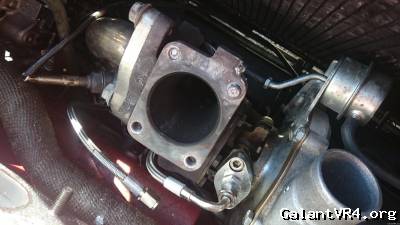

I don't even use extractors anymore, they never work for me, I just stack up some tacks on top of the bolt with my tig welder and remove them with a vise grip. I take it you don't have a welder, but maybe you know someone that does.
3,473
I'd just take it to a machine shop. You may do irreversible damage trying to remove those without the proper tools.

I had to switch to my stock manifold for a little while about a week ago and my buddy put a small vertical line of anti-seize I told him to put more and he said it will spread when I tighten it definitely should have put more. (yes I should have bought new bolts too) I thought it would be fine for a short time. I tried to torch it, a easy out and I made it worse /ubbthreads/images/graemlins/banghead.gif Just want to know any options/solutions. Thanks guys
The bolts breaking wasn't due to the lack of antisieze it was due to you over torqueing the bolts. Your buddy was right about the anti-sieze spreading.

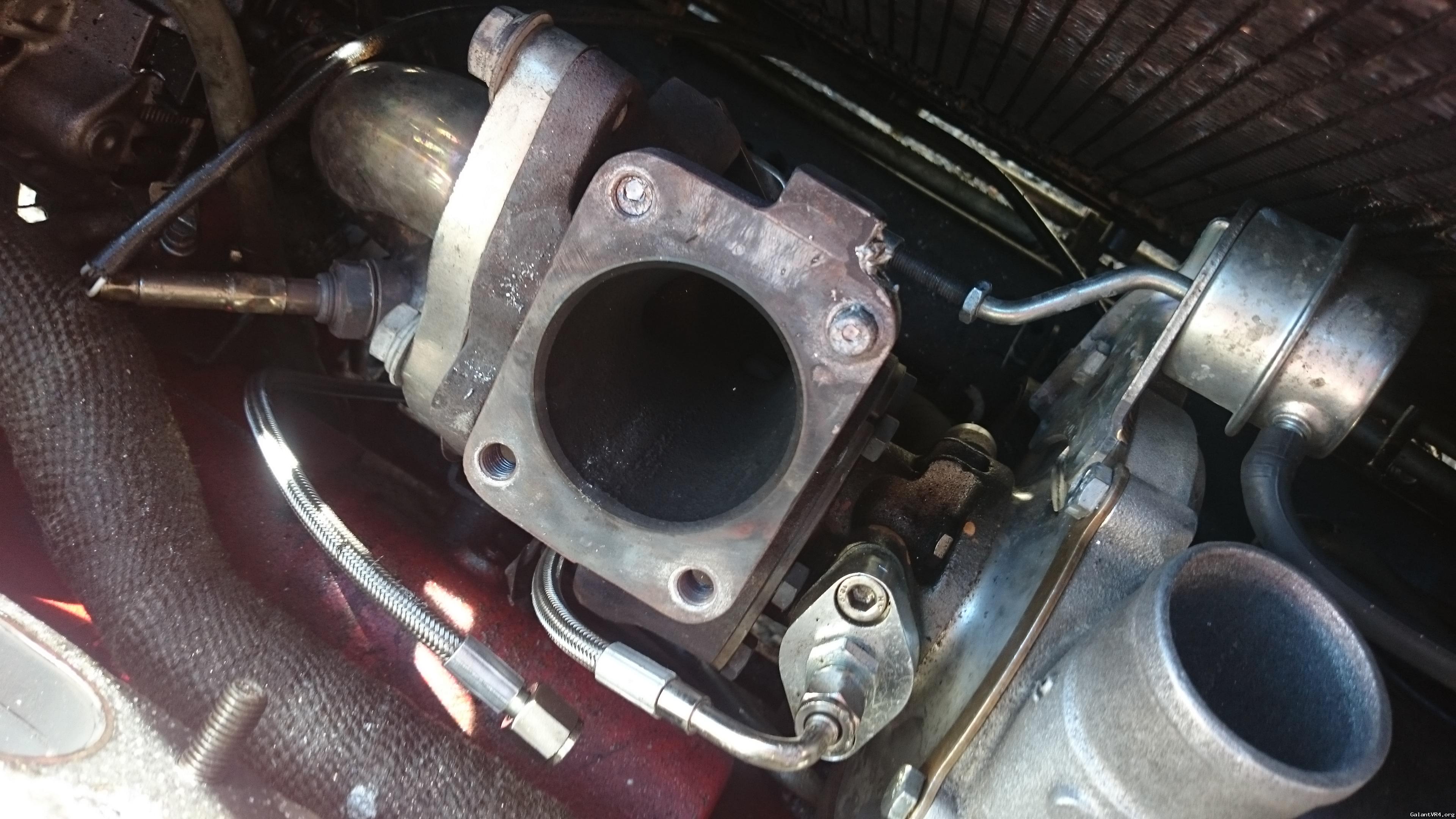

Drill them out and just use m8 bolts and nuts. When they seize you can break the bolt easily. Then one end with the bolt head pulls easily out the top, and the part of the shaft with the nut seized on it falls out the bottom. Threading a bolt into an exhaust housing is a poor design. All the aftermarket stuff uses nuts and bolts.

Weld a nut on top of them and while it is still nice and hot back the bolt out with a 6 point socket. It works almost every time.
I'm thinking I'll go this route, and what about the bolt that broke flush with flange? Also justtook it to the machine shop and called me back saying, I have to take the turbo apart and he has to mill it.

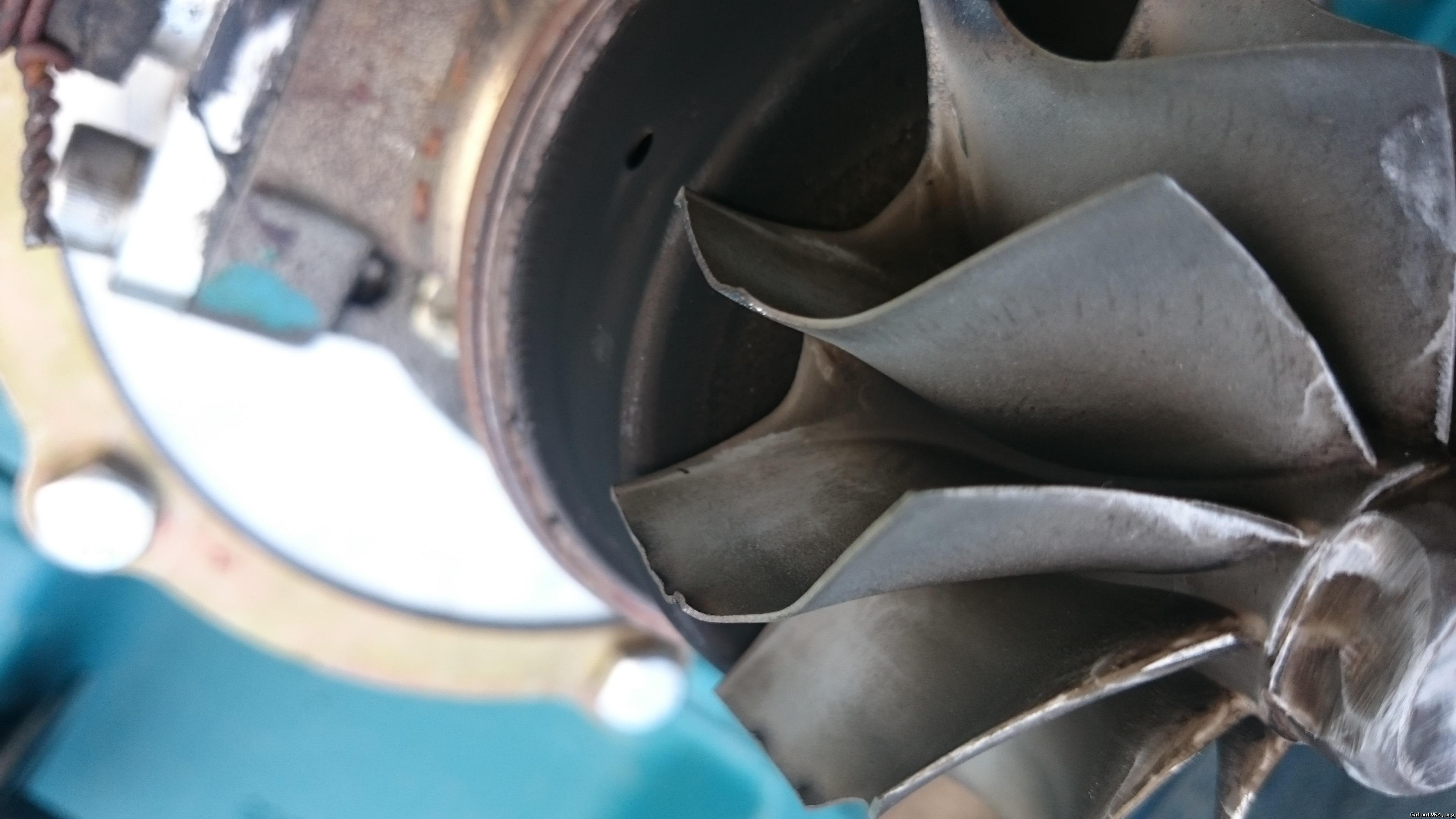

When did the bends occur?
If you had eyes directly on them at some point and they were fine, then they looked like this upon removal, then you had shaft play and subsequent fin to housing contact.
Doubt that debris would make those sweeping bends, but could be wrong here. Contact is the name of the game here.
Once you have contact, it is anybodies guess if it is still in balance or not. I would highly suggest, not.
The part is now technically compromised. It is replaceable and a balance is HIGHLY suggested.
Yes, these turbos were component balanced, but this debate could go on forever in some circles.
If you have new parts and the ability to have it balanced, you owe it to yourself to do it.

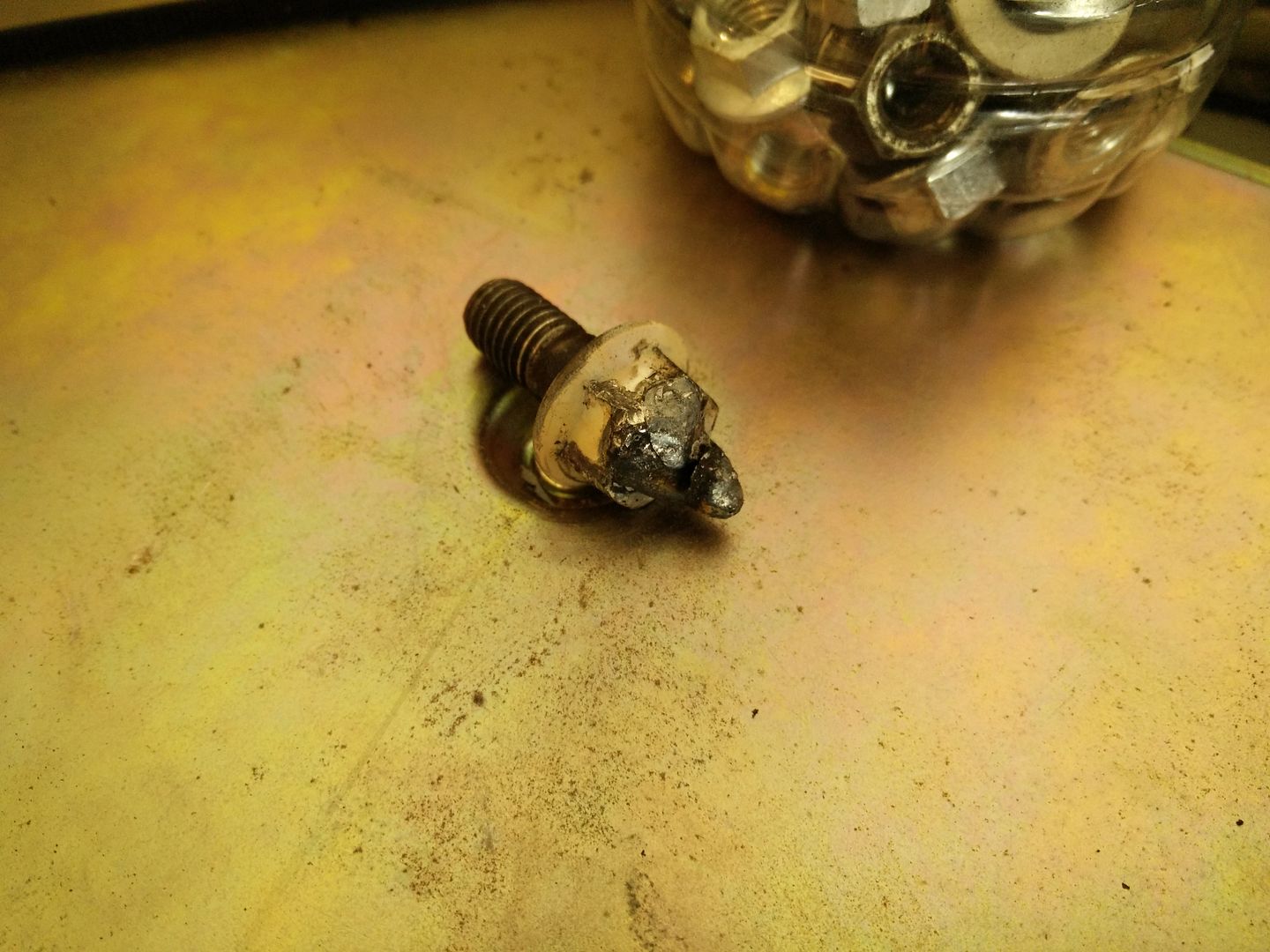

Broken bolts are a bitch. When I would have to get them out. I would use a fixture in the bridgeport and have to go in with carbide because the bolts are work hardened to all hell. I would typically drill out the center and that would ease the tension on it and then break out whats left. They are never easy. You may get lucky sometimes but for the most part your better off just getting a new housing.

I've had good luck with the welding method. I use a wire feed welder to get all those broken LS and LS based chevy exhaust manifold bolts out. I don't even bother drilling them out as it never seems to work for me.
A stick welder would be harder than hell to do it with. Unless your friend has got some mad welding skills, it will probably just end up welding the bolt to the housing. You would be much better off with a wire feed or tig if you can find one.

You can soften them with a torch first. I broke a tap in a hole once, and of course they are hard and difficult to drill. I annealed it with my propane/oxygen torch first, and it was easy to drill out.

With a flush broke stud, a nut is placed as close to the stud as possible and then the hole is welded up until the nut and stud become one. then while still hot from the welding, try to loosen it.

My buddy that's not half bad at welding is out of town for another week or so. Instead of trying it my self and welding it to the flange, I just took it to the machine shop they charged me 30 a bolt which doesn't seem bad.
