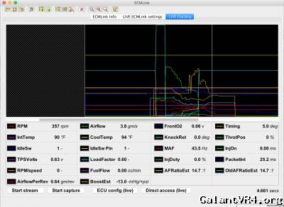

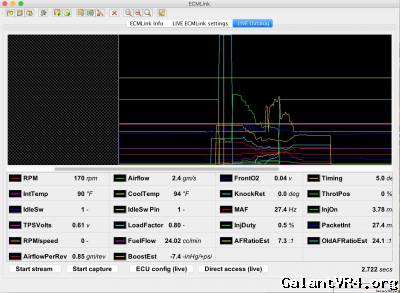

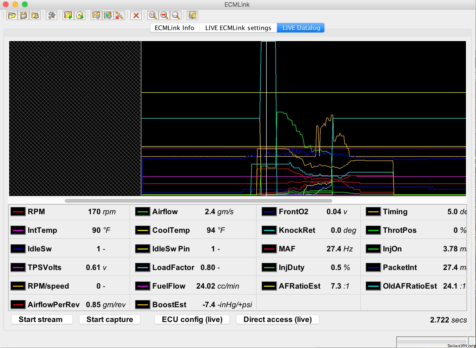

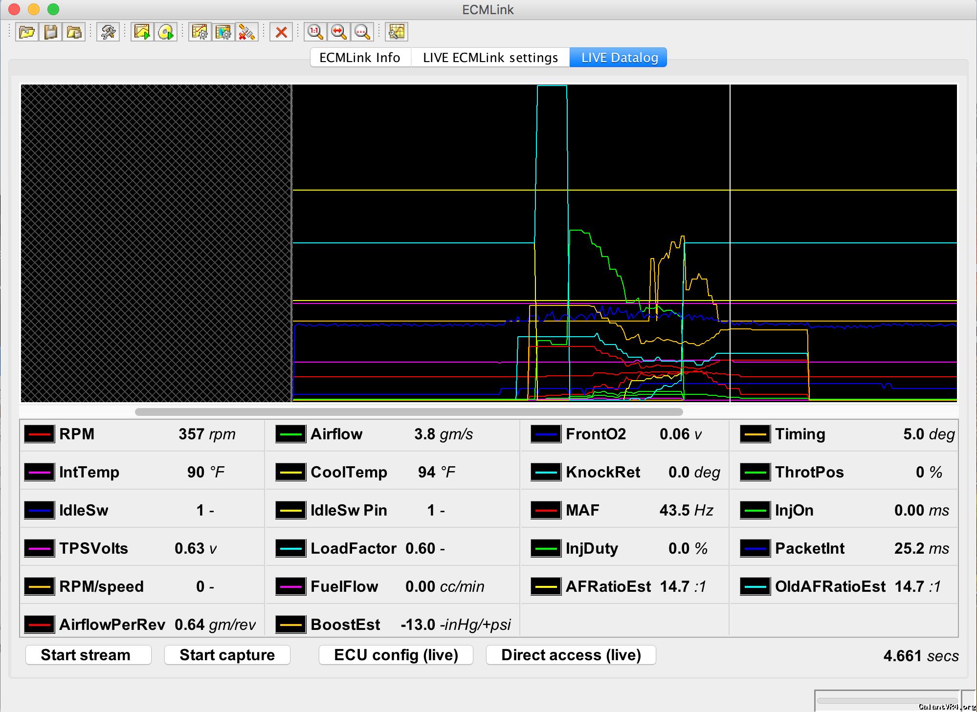

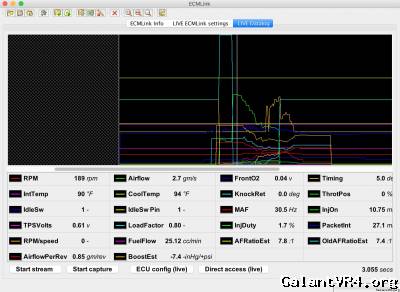

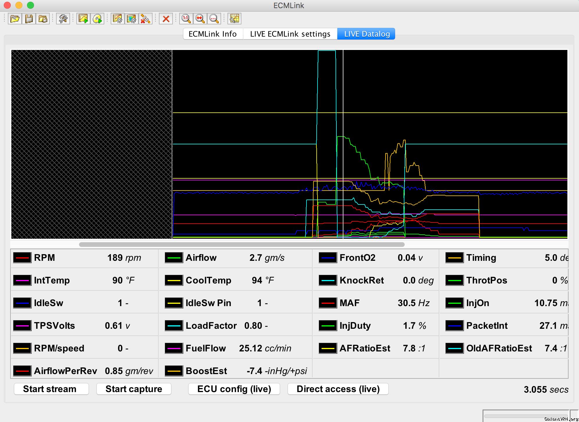

I just got back an ECMLink'd ECU and when I plug it in the car starts but dies after a second. This ECU isn't the original one but off another VR4. However when I plug back in my original ECU the car starts and is able to run. Any idea why this might be?

Did you do the initial start up checks in ECMLink? Could be an A/F thing. Check injector scaling/deadtimes as well as the MAF being used.

When I plugged in the ECMlinked ECU everything was appropriate with the settings. Only thing I could find was the TPS was at 0% and after messing with the settings enough I got it to almost keep going, it ran twice through before dying instead of just once. Idk just a little frustrated today alot of this stuff is pretty new to me and a lot of the places around here haven't been willing to help me.

The idle switch isn't necessary, and you can simulate it in ECMLink. When I say it's not necessary, the car will idle without it, but not as well as with it.
Any way you can post of log of when it's running?
