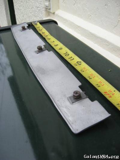

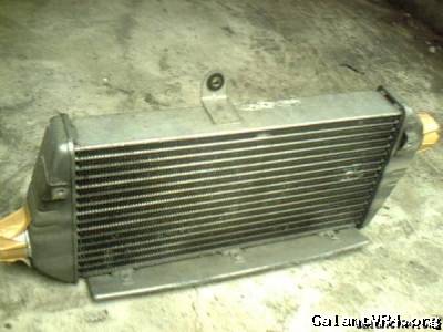

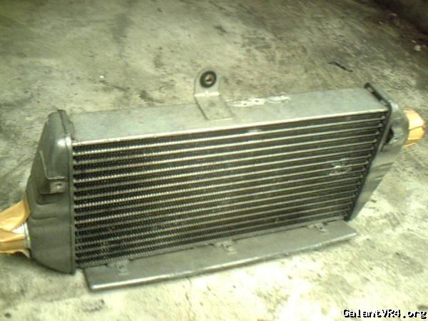

Maybe rig up some ducting out of foam or cardboard that forces the air into your radiator.
I remember a thread where some ducting was made to reduce air going through the front grill and then under the intercooler and car. I can't find the thread but snagged some photos of the ductwork. Maybe it will stimulate some ideas.
