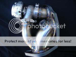

To actually answer your question, you need oil feed, and return lines, and a wastegate system like this.
It will also require some adjustments to the intercooler piping.
