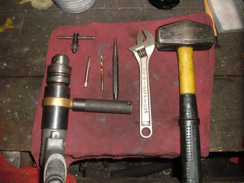

The tools needed are few.
Drill
Proper size drill bit
A good sharp center punch
Hammer
Crescent wrench
Proper size EZ-OUT
There is two different styles of EZ-out, A left handed spiral flute and a straight flute.
I will be using a spiral flute in this removal.

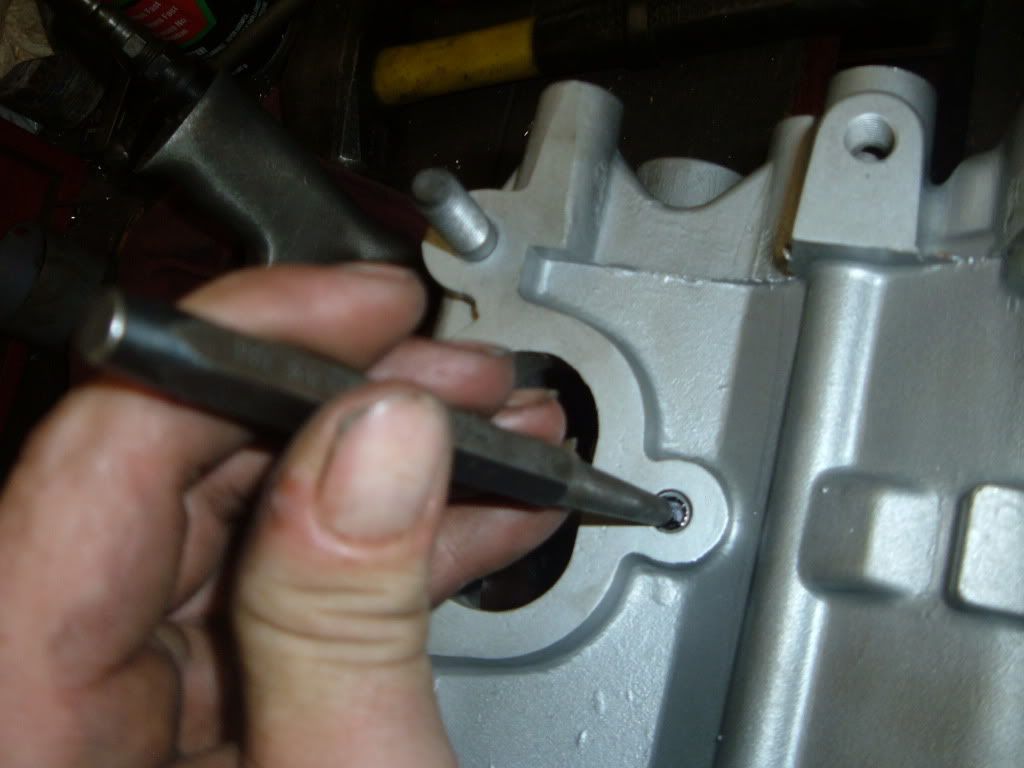

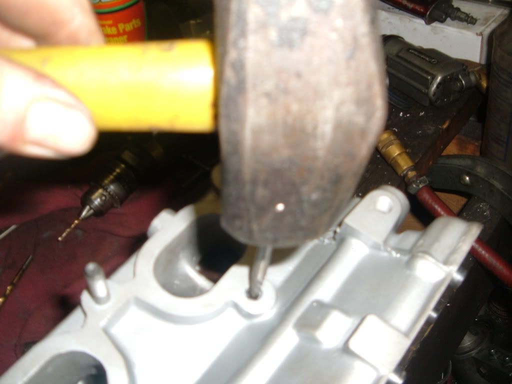

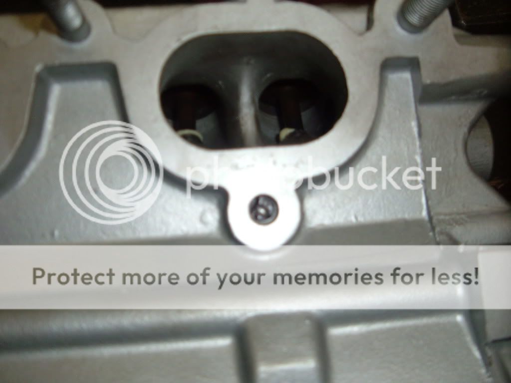

First with the hammer and center punch, knock a good divit as close as possible to the center of the bolt.
This is done so the drill bit will not walk around when you start to drill.

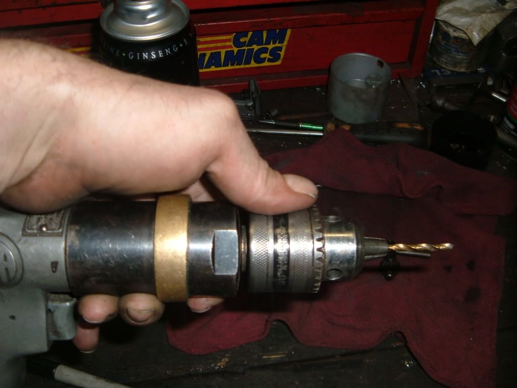

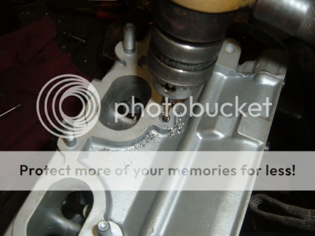

Now with the drill bit in the drill motor.
I am using a 1/8 inch drill bit, the broken bolt is a 8mm (5/16ths)
Drill appox. 1/8th to 1/4th inch down the center of the bolt.
Drill as straight as possible.
Some times it will be necessary to drill all the way through the bolt.
Blow all the metal chips out of the bolt hole.

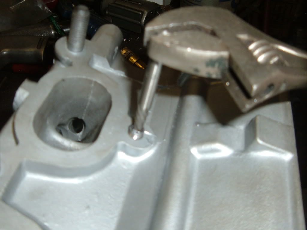

Now take the EZ-Out and tap in to the hole you just drilled.
Now using the square on the back end of the EZ-out.
Gently apply pressure to the broken bolt, until you feel movement.
If you apply too much pressure, and snap the EZ-Out off in the hole, you will have more serious issues.

Probably worth noting that while you can use a crescent wrench successfully (hell I do it) you're a lot less likely to break an ez-out due to lateral pressure if you use a proper tap handle, and I'd highly recommend using one instead of the wrench.
9,833
Good point, Slugs and always a good idea to use a t-handle whenever possible when it comes to things like this and especially tapping. I personally do not like using crescent wrenches for anything.

Yes I will agree that a crescent wrench is not the best choice, I have the neato sockets for taps and EZ outs.
I show tools to use that the start up wrench turner is likely to have around to do the job.

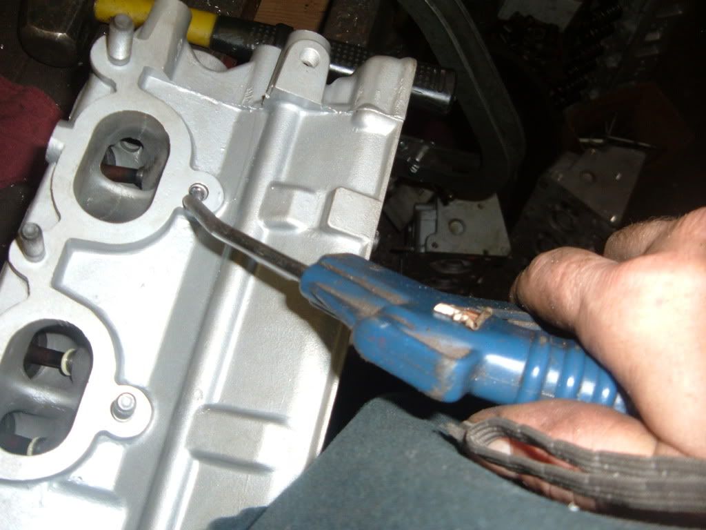

There is also another technique that uses a welder that also works very well.
In some cases this actually easier to do on the car then the whole drill routine.
