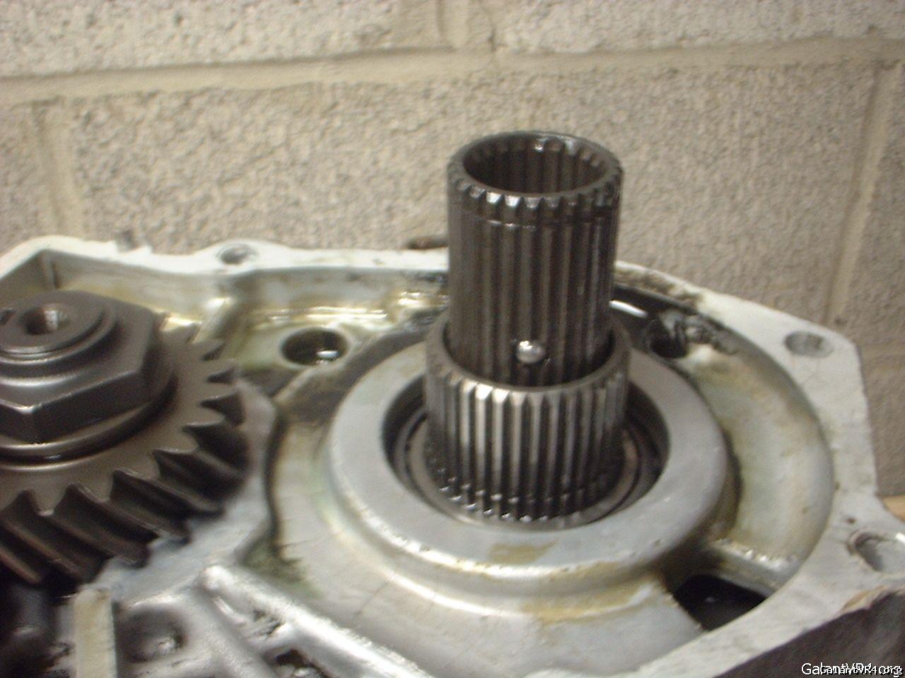

Need a helping hand gents:
Neither of my pullers are small enough to fit under the 2.5mm groove around the top of the gear to attach a puller. Using the link below coupled with the picture below the link, what puller (brand, type, name, where to purchase) are you guys using or recommend. Any assistance is greatly appreciated.

I appreciate the feedback -I realized I'm trying to remove the 5th speed intermediate gear, not necessarily 5th gear itself. At this point I've managed to chip just about every tooth broke a good chunk of the collar. I have used a bearing separator, a 3 jaw puller, screwdrivers, plastic interior trim tools, and Aerokroil. I think I'm going to get a bottle of propane and heat up the intermediate gear and surrounding area.

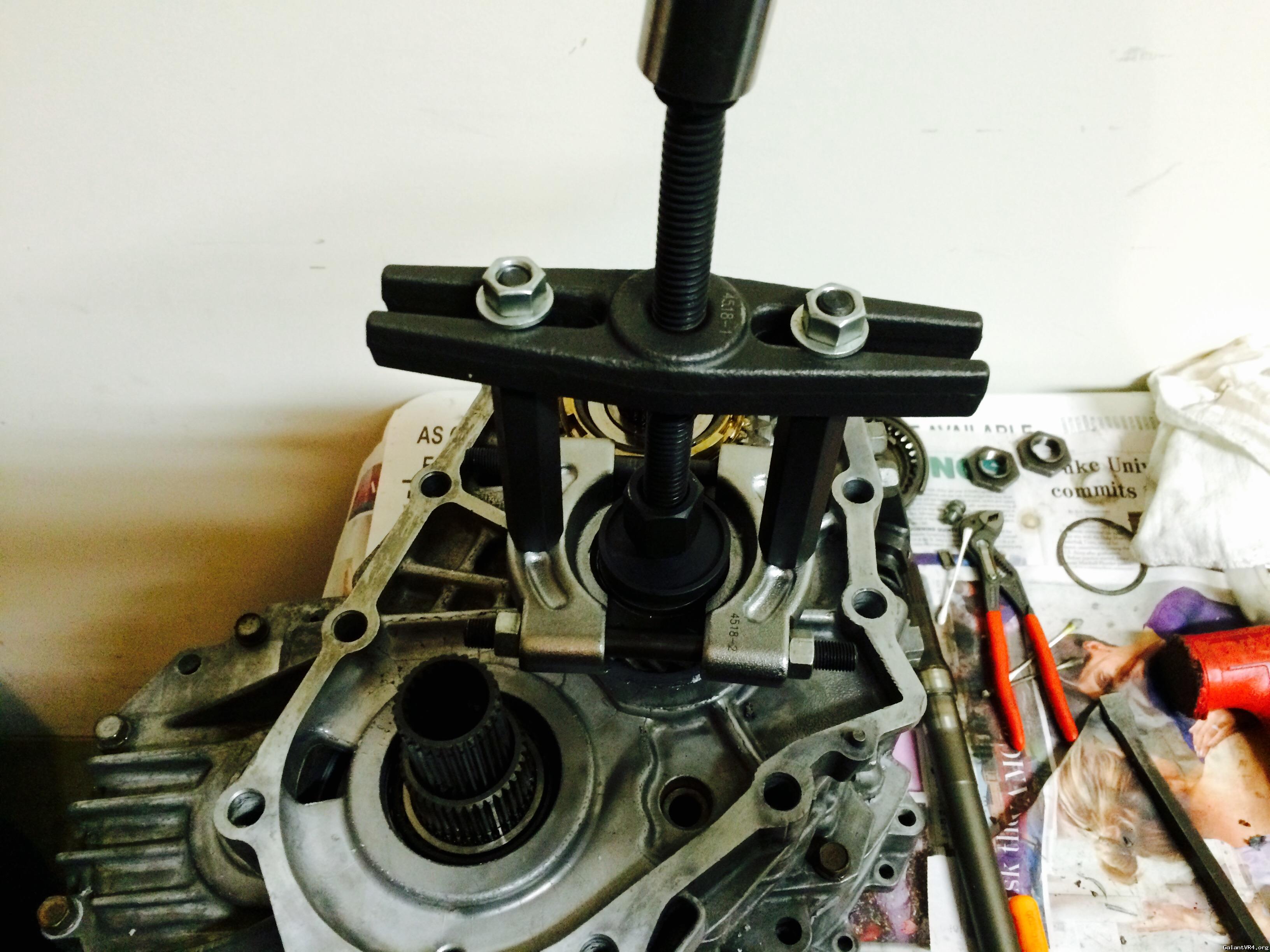

I wanted to update this thread with mission success. I used a bearing separator to remove the 5th speed intermediate gear and it took all but 3 minutes.

Hey I have that kit. /ubbthreads/images/graemlins/wink.gif That's what I use if they don't come loose with a quick pry.

Brother, I don't know how the hell you or Josh from JNZ can manage to wedge a prybar underneath that f***er. I managed to destroy the gear teeth not to mention the lack of any clearance between the casing and that gear.
It appears that the bearing separator I picked up (MatcoTools part no MST4518) can be used to remove most of the bearings on the galant trans which is a plus. On a sidenote, this entire experience has made me that much more comfortable with rebuilding the trans.

It's a little tedious for sure. He and I both have some "ladies feet" that have been either modified slightly or a specific brand so they fit better. But I've chipped a few until I got the hang of it. Some definitely come off easier than other too, that's for sure.
That Matco set is nice, just need to do some clever holding for some of them (lower input specifically). I have about 5-6 different size bearing splitters that I use in conjunction with my press. After a couple dozen transmissions, you get pretty proficient at them. /ubbthreads/images/graemlins/grin.gif
