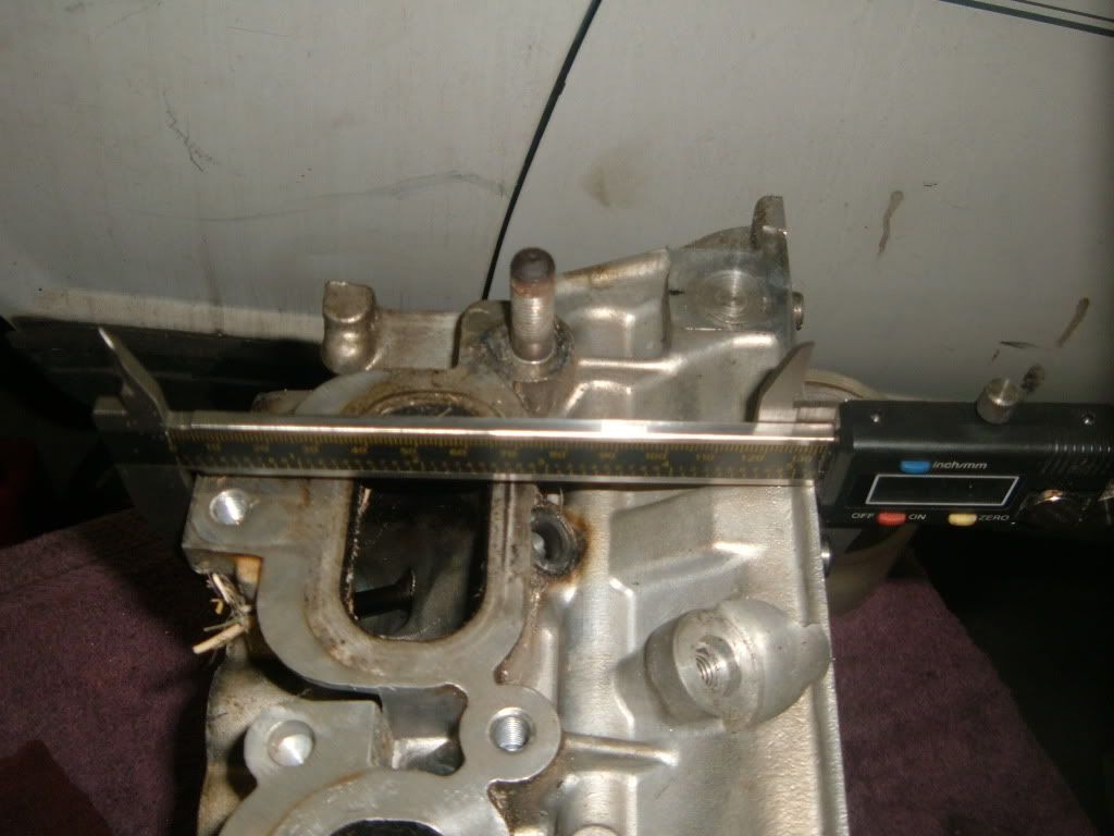

Now roll the head so one port side is up,
I will start on the exhaust side.
Measure from the valve cover rail to the head gasket surface.
I will also use the cam cap mating surface on the top, it will help keep the calipers square.
Make a note of the measurement.
This is Exhaust Front
On this head it was 5.193

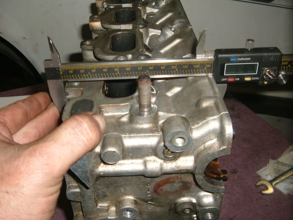

Next I will move to the rear of the head.
Make note of this measurement.
This is Exhaust Rear
Here I measured 5.190

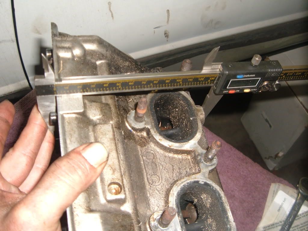

Next roll the head over to the Intake side.
This is the Intake Front
The measurement is 5.191
Now to take the forth and final measurement.
This is the Intake Rear
This measured 5.188
