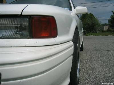

Here's a pic of a 17x8 rim with 35mm offset on my car.
It does stick out a bit (about 1/2") but also keep in mind that I went with 245/40 tires instead of 235/40 which is a more common size for those wheels and also my camber is set to -.3*
With some more negative camber they will tuck in nicely. I plan on running -2.5* in the front
