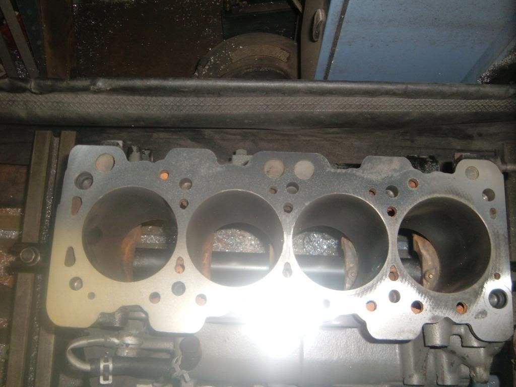

It has been Bored and Honed to .020 over std.
Checking the block I found it had .0025 taper from front to back and has water pitting.

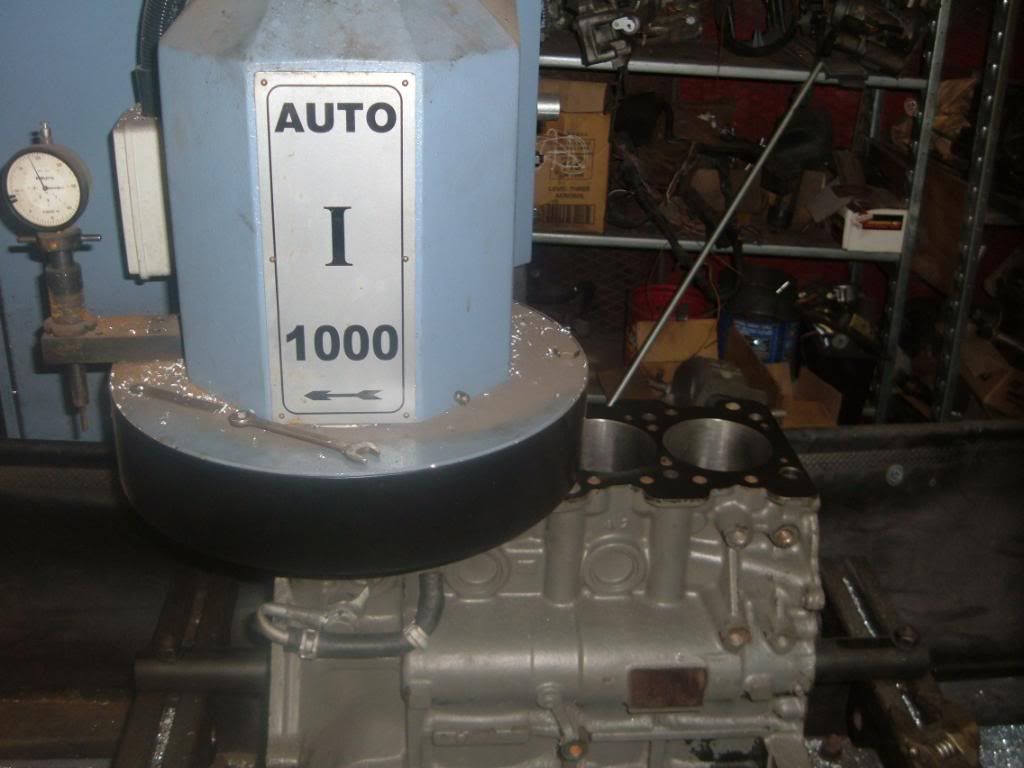

I set the block on the machine fixture; the block is on the main saddles.

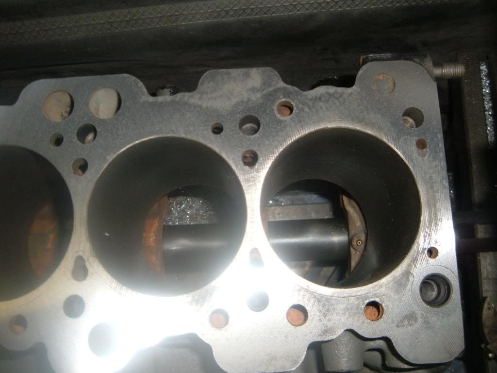

I make a .0005 pass, Cyl #1 is shorter than Cyl # 4
I see I have a good level set up side to side, notice the dark low spots around #1 cylinder.

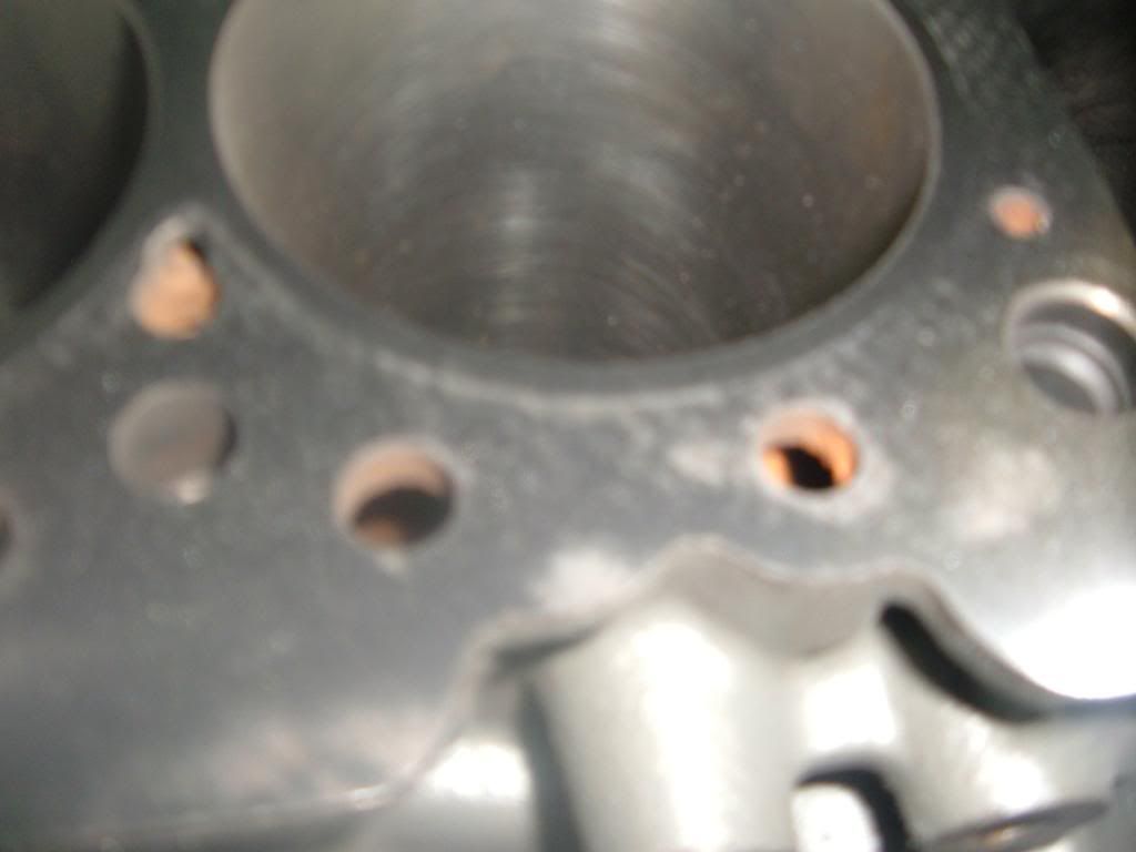

Still some pitting at the fire ring of the head gasket.

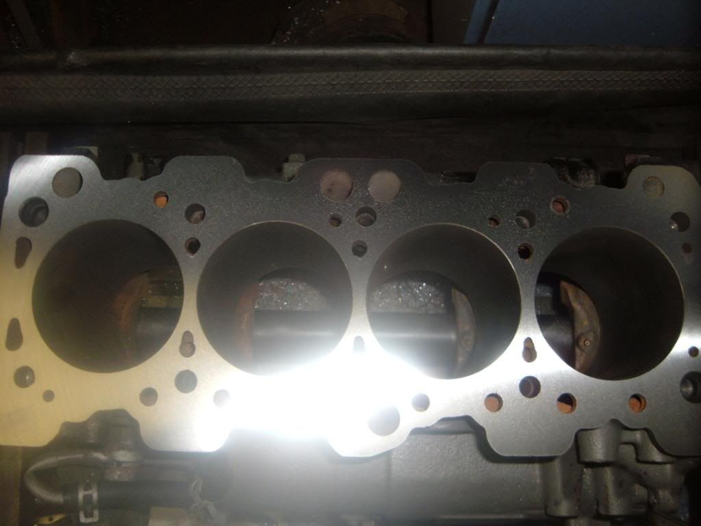

One more pass of .0015
The block looks good, and has a good head gasket sealing surface.
