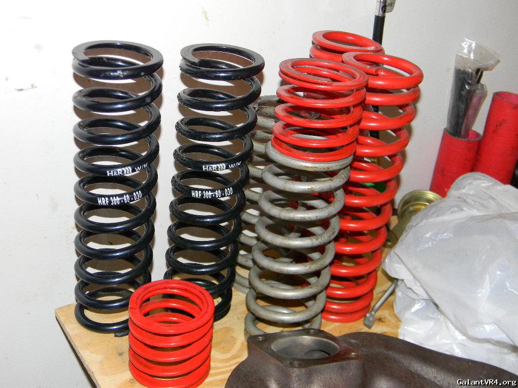

This is some of the springs I have bought in an effort to have a suspension that handles bumps instead of the bumps handling the suspension.
The reason I got turned onto the hotbits was all the hype on here about 'em, I think it is important for people to know what they are really getting, a suspension that is usable only on super nice roads and smooth tracks
