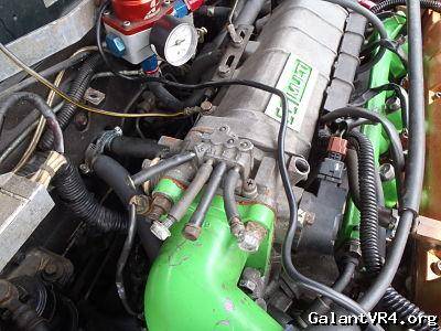

Does anyone have a pic of the lines that go to the top of the TB? The guy how had it before me cut all 4 of the lines and put screws in them as for to block off a vacuum line for something, but like was saying i haven't worked with one of these DSM's before & I don't have a good engine layout to tell me what all things are, he also had the wire on the side of the TB off? I'm guessing a throttle pos sensor, but can't notice a difference in the way it ran with it plugged in or unplugged. I will snap some pics for you guys. Thanks
had a 95 gsr before this nonturbo not as many things to mess with to make more HP's Thanks again

That's kinda ghetto. Go buy some vacuum caps at the parts store for 2 bucks and throw them on the TB ports instead of those lines with screws in them. Or double back those lines onto the next port to clean it up. You probably have a vaccum leak in there somewhere. Wouldn't hurt to check all your vac lines and make sure they are in good shape.
Also this may help you out:
This is all you need really on your car. Everything else can be removed.
