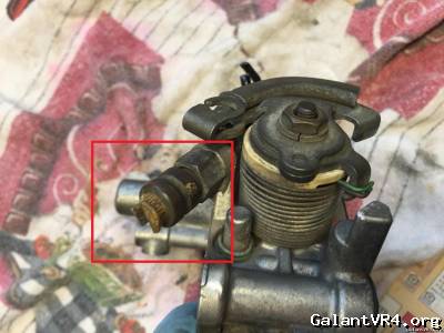

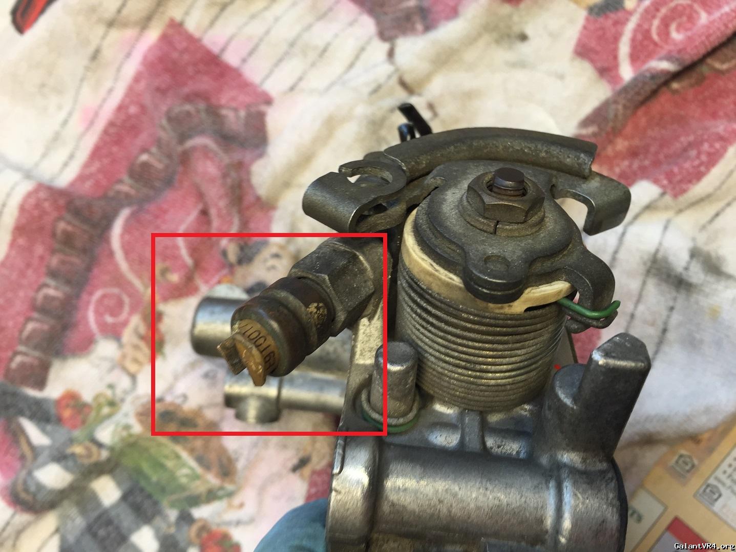

holeshotmoe
Apr 7, 2005
1,298
VA
Check the wire on the throttle stop switch. If it falls off it will idle high like that, even when warmed up. Notice the blade on this one is short, so the wire falls off easily.
