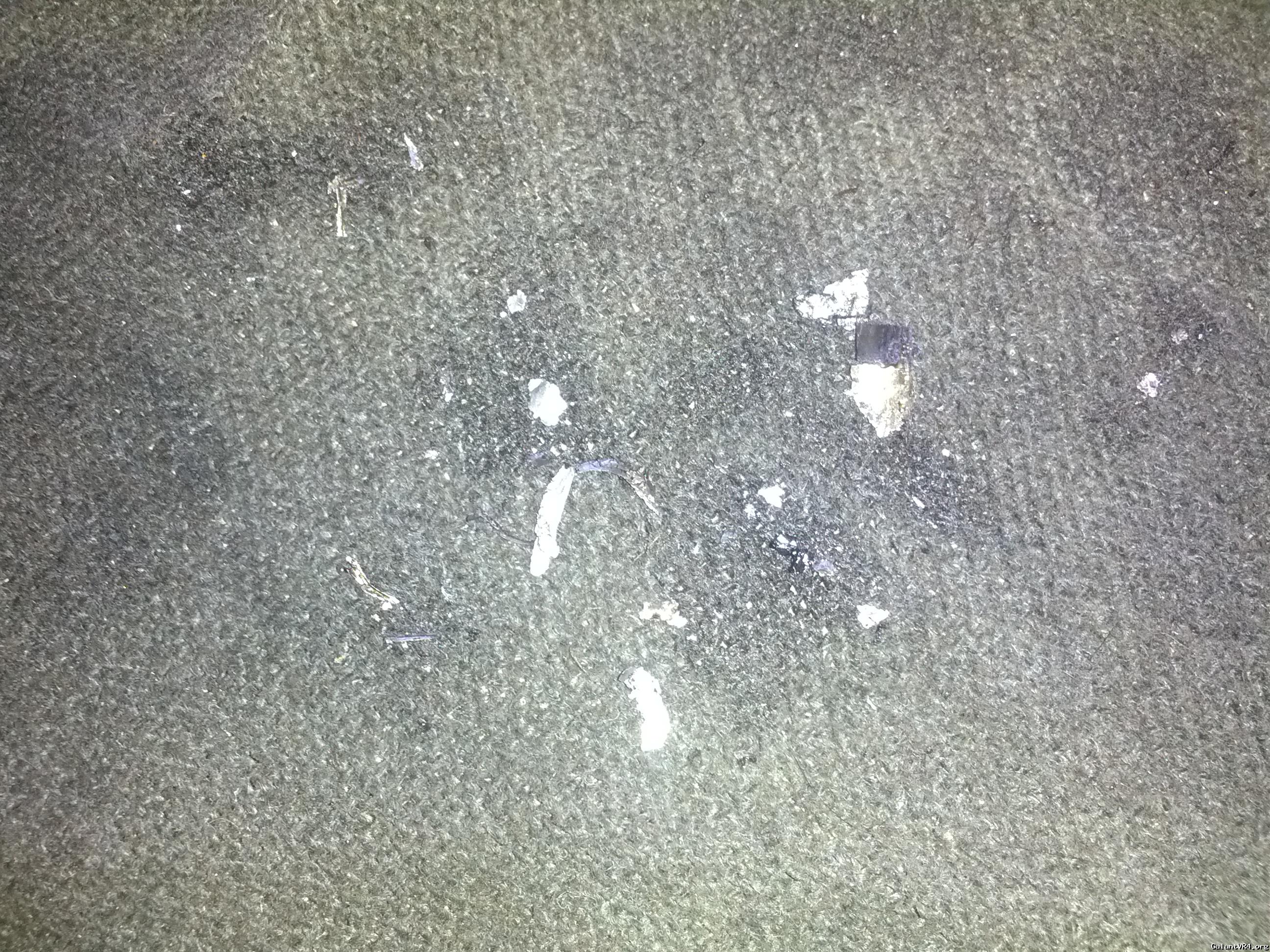

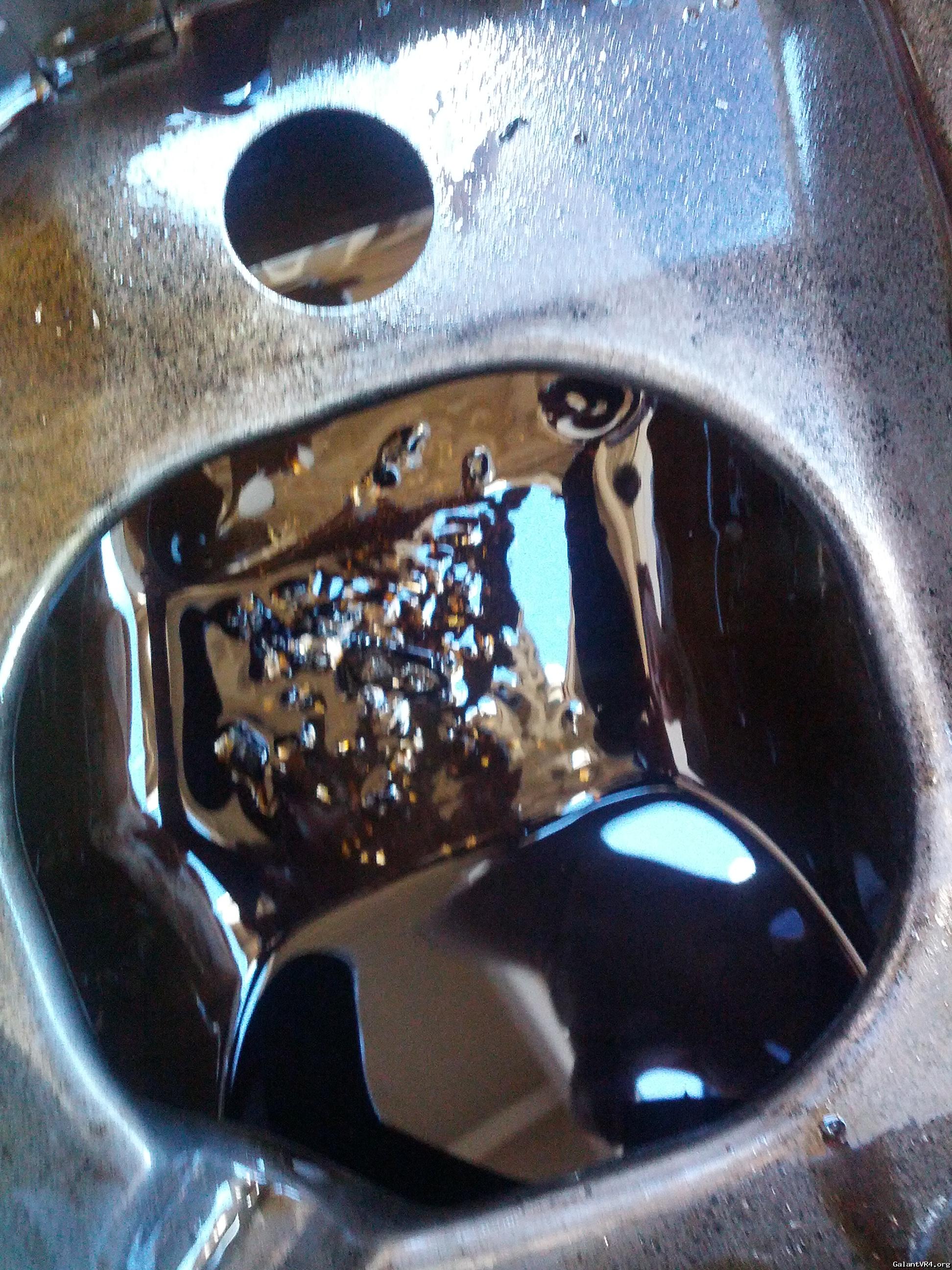

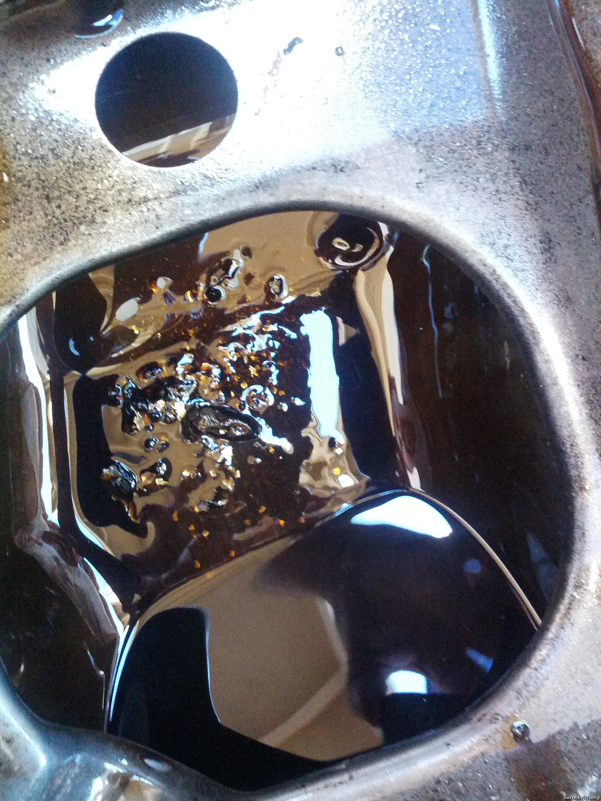

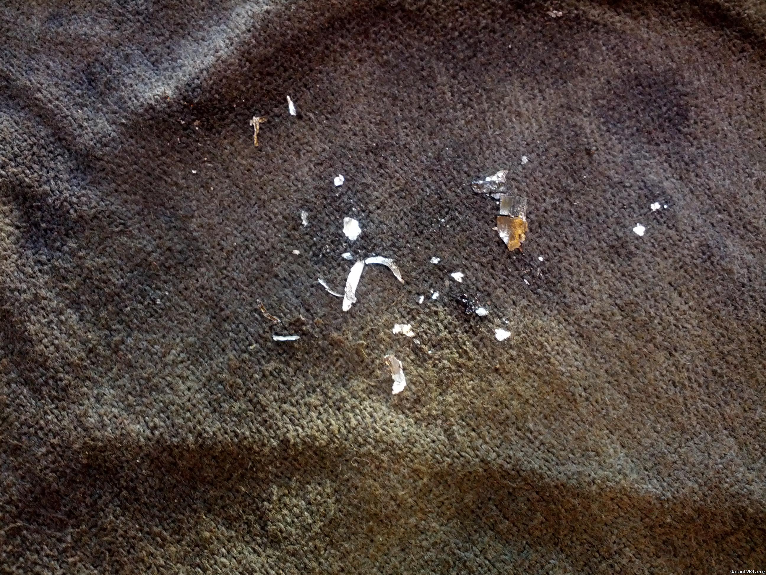

So I bought boostedinaz. A.k.a michael old laser off a third party for 2k. And like my old gvr I started to hear this nasty knocking sound around 2000 rpm then it would go away or I could not hear it any more at higher pms .. then one day it was really bad and Michael found the harmonic ballancer was wabeling all over from a missing/ broken bolt ... he helped me out big time and while we were at it we changed the timing belt. This fixed the constant tap I was hearing but not the original sound I heard it sounds like its from the top .... well I loaned the car to my brother and now it sounds like hell again at a cold start it makes a quick knock then its idles fine but if you take it to 1500 or more its a nasty knock ... we pulled the pan and there a ton of aluminum shavings I'll post a pic ... what can this be from I thought the bearings were brass or gold in color? Its hot as hell here in as so I did not try moving the rods or pulling end caps yet... thanks for the help

PITA to check while in car, your better off pulling motor dropping crank/pistons/block off at machine shop clean it all up and put new rings/bearings.. really easy once motor is out of car..
11,985
Do a quickie balance shaft elimination by replacing the rear shaft with the stubby and cut the belt to the front shaft but leave it in. Put oil pan back on and see what happens.
I had bearing slivers in my pan back in '03 when I pulled the pan to do the BSE. It was thsoe bearings. No issues since.

Do you still have the balance shafts? May be a bad balance shaft bearing or the bearing has came out of the bore!
This. Hook a drill up to the oil pump and spin it over. If its the rear balance shaft you'll hear it.
